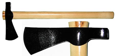

How about the Cold Steel "Trail Hawk." It's inexpensive and looks like a big hunk 'o steel...but is it crap? :confused:
From what I've heard of Cold Steel's axes/tomahawks/whatever, the heads are good, but tend to come off of the handles, or the handles break.
The Trail Hawk is really small.
I had one.
It's OK for what it is.
I gave it to my Nephew.
I like the Cold steel Norse hawk the best.
The handles that come with the Trail Hawks are about as good as any. They'll likely break eventually if you throw them. As will any wooden 'hawk handle. CS does sell replacements inexpensively. The handles only seem to come loose when throwing them, and I simply tap them back on.
In a pinch the Trail Hawks are quite usable. I find they take a very good edge and are well made. The potential downsides are that they are fairly light. They seem to be the lightest 'hawks CS makes. Using the full length of the handle should help out matters. And the cutting edge is a bit on the small side, a bit more than 2".
The CS Rifleman's Hawk is an alternative. It'll cost you roughly the same as a Trail Hawk. Before deciding one way or the other between a Trail Hawk and a Rifleman's Hawk, try to handle one of each, or at least take a good, hard look at the weight specs for both. The Rifleman's Hawk head is a massive, massive piece of steel: the cutting bit is wider than the Trail Hawk's, the blade is long, and there's even a very significant amount of steel between the eye and the actual hammer part of the head. It's HEAVY. For a "car trunk" application, however, it might be just fine. For most applications, the Trail Hawk might be better--light, and with a little cutting bit, but with a little patience, it'll do most of what needs done. One thing about CS 'hawks: you WILL want to do some work on it before you send it out into the world. At a minimum, you'll want to do some serious sharpening--reprofiling might be more apt--of the edge. Myself, I always also remove the black paint-like finish from the head and the off-white paint-like finish from the handle, and replace them with cold blue and wood-stain-and-linseed-oil, respectively. Also, you'll want some kind of sheath.

If you want a larger Hawk get the CS Rifleman. The Trail Hawk I have is a nice light weight Hawk though for a pack or kit. My Rifleman is certainly a heavier Hawk though that woul probably chop a little better once you put an edge on it. The Trail Hawk did come with a better edge than the Rifleman.
I think you did fine. For what you paid, you'll get a decent lightweight tool. I get my Trail Hawks from Elite also.
