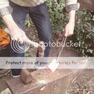

Hey guys,
Thought one or two of you might be interested to see a quick snap of the first phase of my Maine pattern axe production. I'm making wedge pattern axes with high carbon 80CRV2 steel bits overcoated on. This picture shows the bit before it gets split. I didn't take the picture myself (obviously!) so sorry it's not more exciting.
Anyway, I'm using exactly the same process as in the Emerson Stevens factory. If you want to keep up to date on what I'm up to you can do it here or here.
Of course. If there's interest I'm happy to show the progress. I'm doing a few different things at the moment, but I'll hopefully have a finished product within a few days. Meanwhile, here are a few pics of the overcoat taking shape.

Anway, I forged a special boy's axe eye-sized drift today so I can get down to the real work tomorrow!

What is the mild steel you use and how well does it weld to the 80CRV2? I heard this is one of the issues with 5160, it can be difficult to forge weld, but my knowledge of forging is less than beginner.
Also, do you know what steels were used by Emerson & Stevens and how these new steels compare?

I've been busy away recently, but I was able to put an hour or two in at the forge this afternoon. I flattened out the wings and and folded them over. Here's how it happeed in reverse order.
