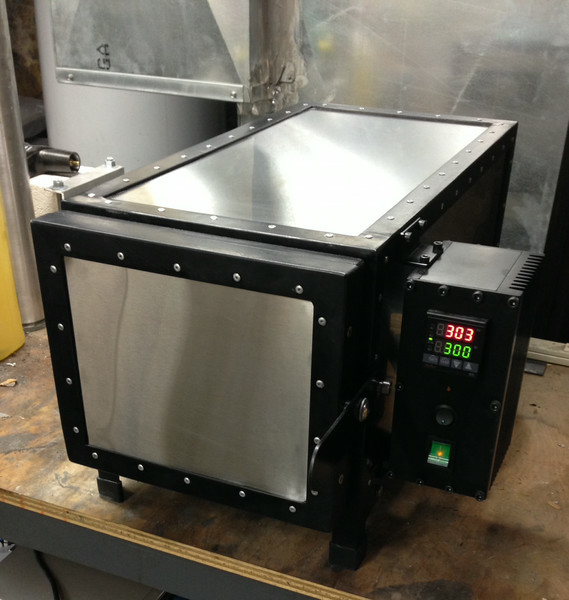

Well after a few week labor of love I finally finished it today! Thanks for all the help here in the posts and stickies- made it very easy! Especially the parts list by Jbblount on this thread:
http://www.bladeforums.com/forums/showthread.php/927793-Homemade-heat-treat-oven/page2
Quick specs:
4.25x6x18
220v, 3100 watts
Here it is just getting first break in run going:

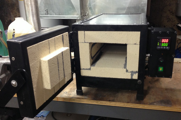

Interior:

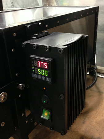

Controller- knew I would use that anodizing setup again haha!

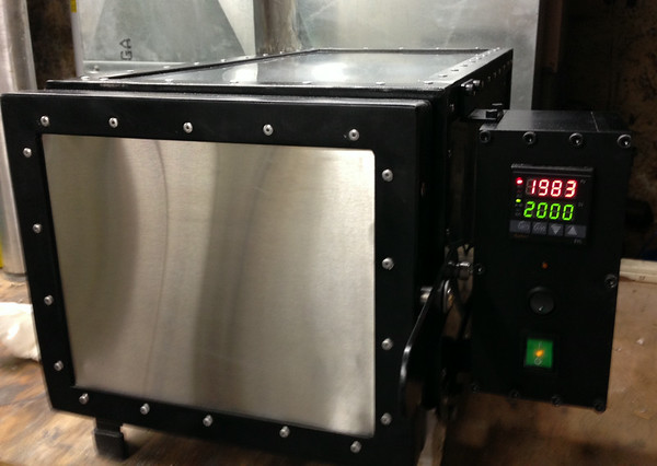

Finally after a couple levels went for 2000 degrees. All went well, outside skin got pretty warm but seemed to get there pretty quick:
Thanks for all the helpful tips and discussion.
FWIW, anyone thinking of undertaking this to save a few bucks should probably just buy the commercial units. I have about $500 in total parts in this and countless hours. I enjoyed the process but if you would rather be making knives that might be best!
Stuart

what kind of box do you have there for the PID and SSR? are the corners of the kiln welded?
BTW:INCREDIBLE job!!!!! Beautiful
DR.....
DR.....
Thanks! I made the box for the controller myself since I couldn't find anything to purchase that wasn't huge. I wanted it to be narrow enough not to take up much additional bench space. I made the interior the width of the PID and everything else fit in nicely under that. I used aluminum stock I had already on hand and my mill. Yes, the corners are all welded. First time with welder but it is not so difficult and easy enough to grind off the ugly stuff!

I have been using the oven a bit now and can pass on a tip for anyone that ends up using the same PID controller for their oven. I have the SYL-2352P from Auber Instruments and found that it was not staying very precise at HT temperature- generally 10 degrees under and varying quite a bit up and down. I did the auto-tune when it was at temperature and now it is locked on very well! stays within a degree of target for both HT and tempering. Nice! The datasheet said it should work well enough on default settings but turns out a quick tuneup really makes this unit shine!
Thats exactly what we had to do with mine, runs like a top now

After running it now and getting a feel for how it performs -especially with the auto tune- it looks like it will be everything I hoped for. Had to make a lot of decisions on choosing brick thickness, layout, door seals, latches etc. but nice to see everything worked out. Fortunately this won't be one of my projects where it takes endless tweaks to get it working right!
