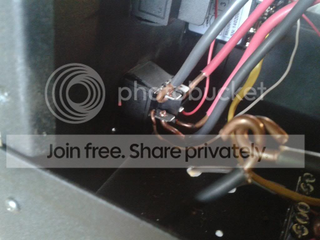

Any chance you could snap a couple pictures of your set up using the macro setting on your digatal camera?
I know it looks a mess I hope you guys can decipher it.
Ok here the ssr's are wired up.

Hope this helps and again sorry for the mess I know it itsnt how you hook it up permanent but at this point with so much switching around it was just easier to set it up as it.
