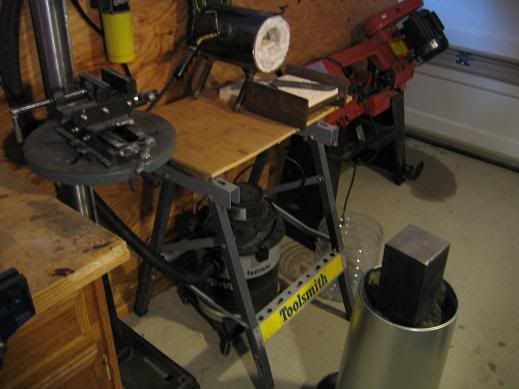

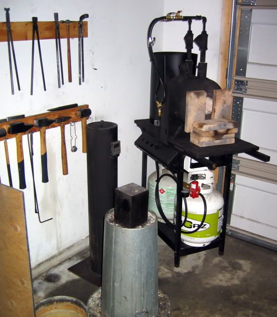

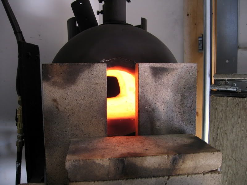

Instead of buying an oven made for heat treating (like a smart guy would), I chose go through the trouble of rigging up a muffle pipe-type system for my LP Forge. I took these pics for someone and thought I would just throw them up for your critique.
I wouldn't mind seeing your set ups if you have pics, too.

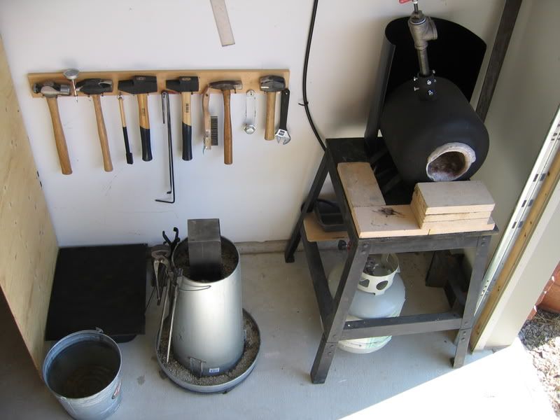

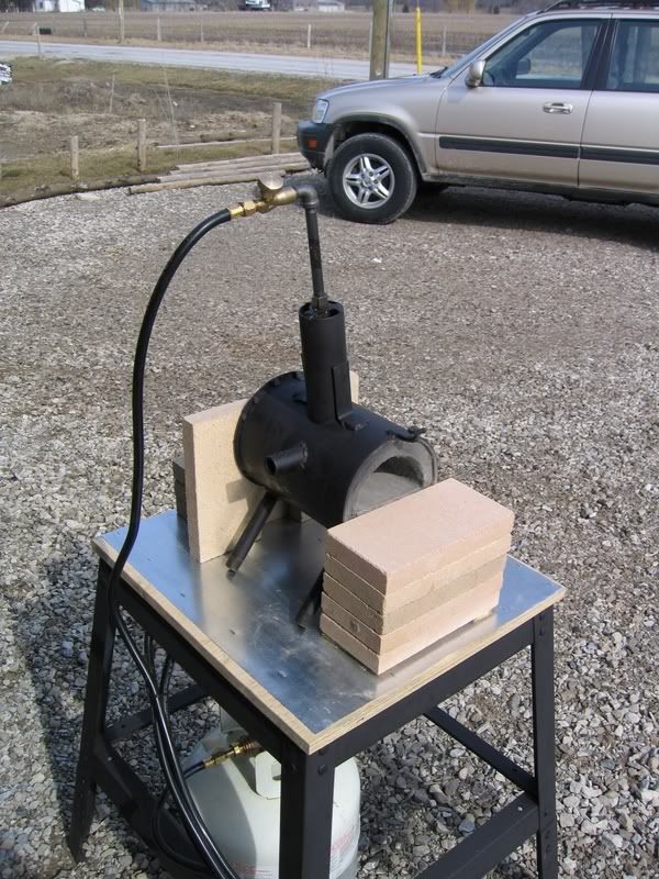

My Forge...

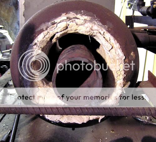

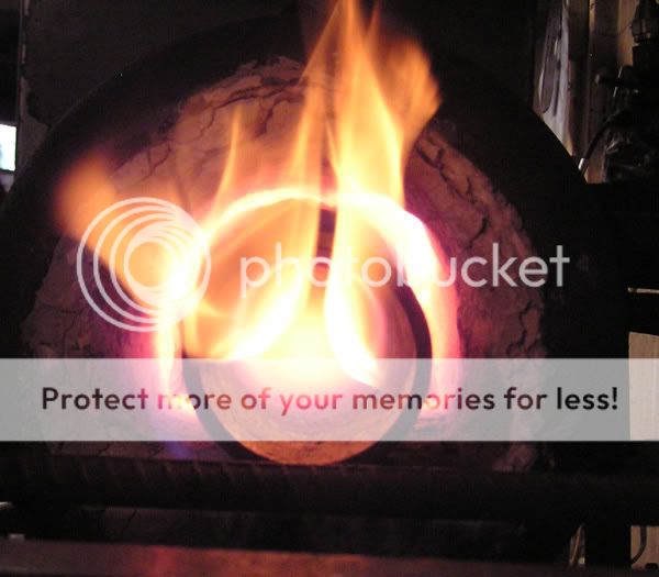

At 7psi it runs at about 2100F...

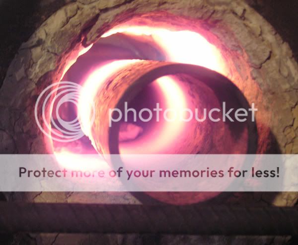

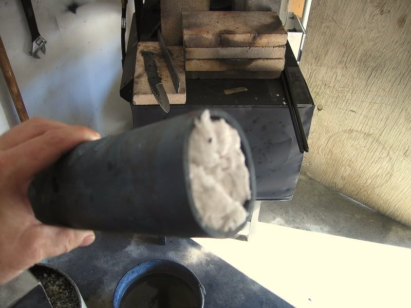

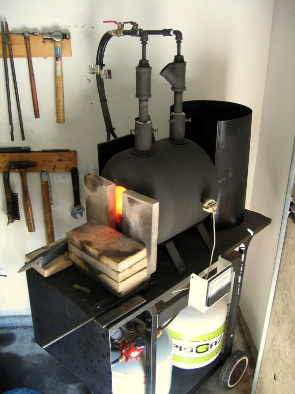

Here is my "knife" muffle pipe. There is a little hole that the thermocouple fits into to give me a reading of the temperature in the pipe.
I stop up one end to contain the heat. I took Tai's advice and threw a piece of hardwood in there to eat up the oxygen and reduce scaling. It works well but fills my garage with smoke. Most of the time I just use the pipe.(The one for swords is longer with both ends open.)...

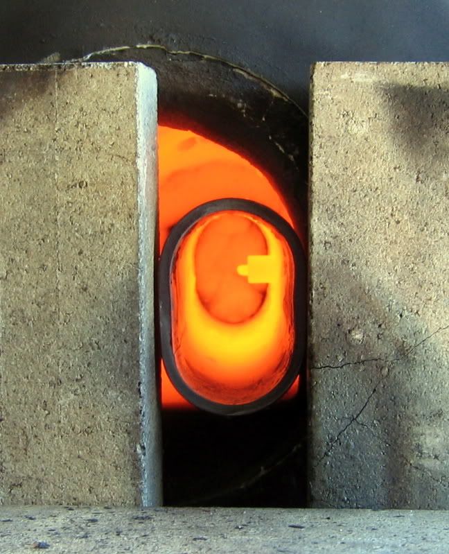

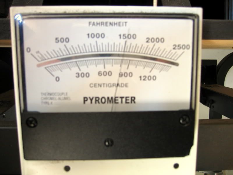

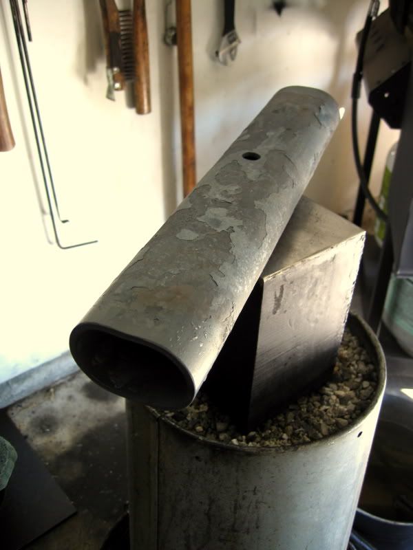

Here it is positioned with the thermocouple in place (the camera doen't pic up the colour too well)...
At 1.5psi the ambient inside is 1500F...

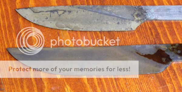

I quench in a vertical tank using quench specific oil...
