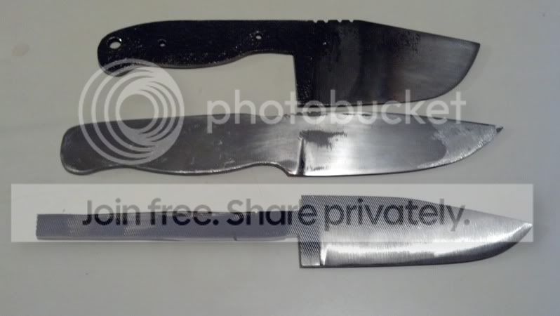

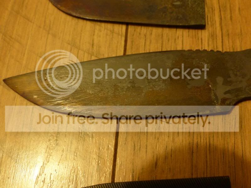

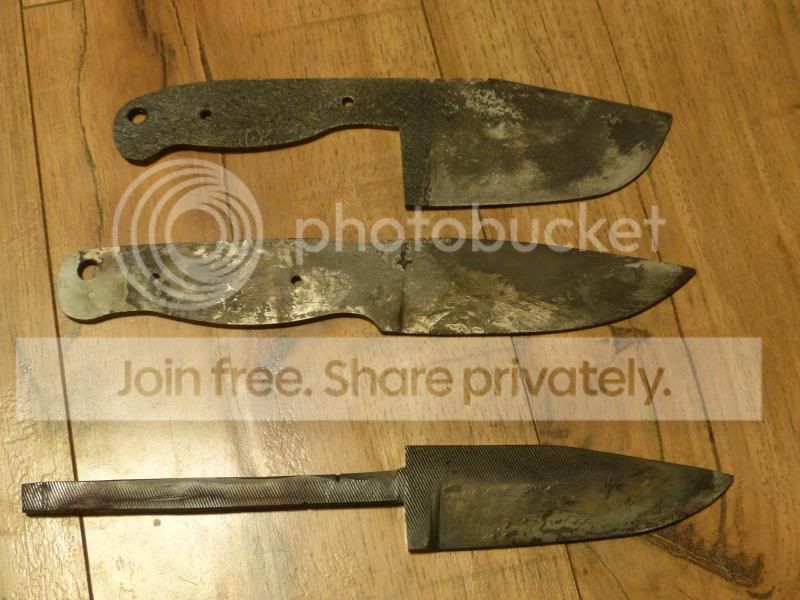

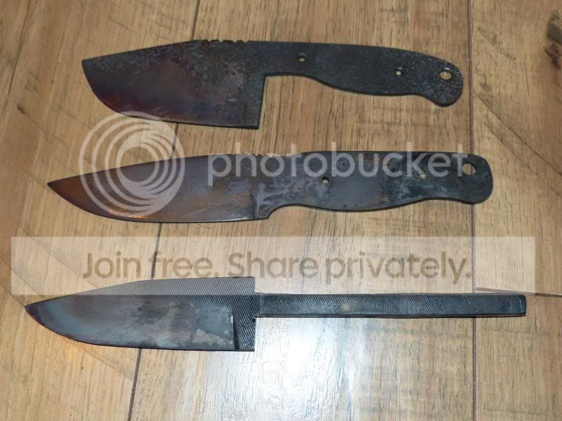

Hello all. I have been lurking here for quite some time and have learned ALOT from the members here already. I have made several knives over the past couple of years. I decided to make a few knives as Christmas gifts this year. I'm making a bushcraft style knife for my oldest son as a first "real" knife. The blade is of my own design and is about 4.38" long and 1/8" thick 1095 CRA steel.
{The center blade is the blade I'm concerned about, the top blade came out at 56 RW beautifully, the lower blade is 46 RW and is destined to be more of a display knife than a work horse so I'm not too worried about its hardness)
{This is the blade following HT prior to temper}
{This is the blade following the temper, by all rights I think it looks perfect in color etc.}
I heat treated the knife (as I have my past knives) with the following procedure:

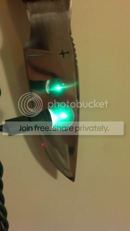

{this is the blade polished and ready for scales.....so I thought)
........ Today at work we had a NDE inspection guy from our inspection group come in to train a few of us. In his goodie bag he just happened to have a unltrsonic hardness tester. Through a little sweet talk I was able to twist his arm into testing my new made knife. I was expecting somewhere in the 50-65 range (a mill file dances nicely off of the blade) ......NOPE! 42 on the Rockwell scale (+/- 5 to 10%):confused::confused::confused:

There seems to be an "edge quench" look in pic 4. I am not sure but perhaps only the edge was heated or only the edge placed in the quench? I am no expert in HT but i have done a few blades.

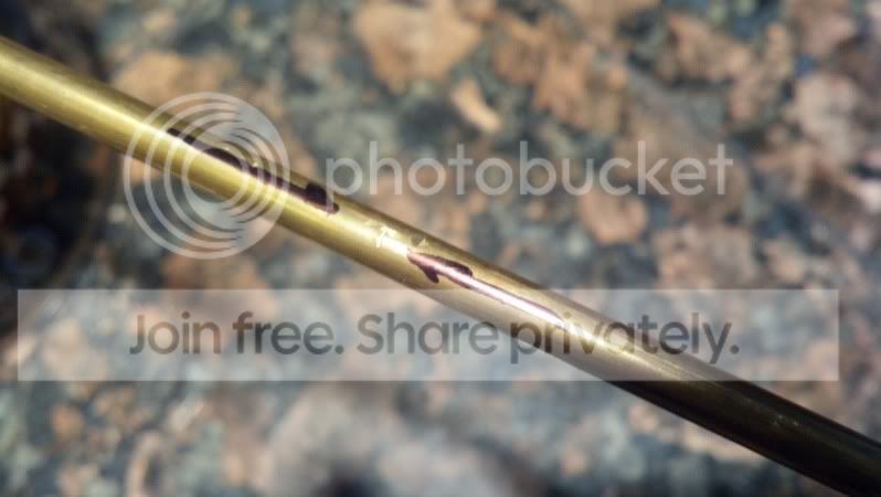

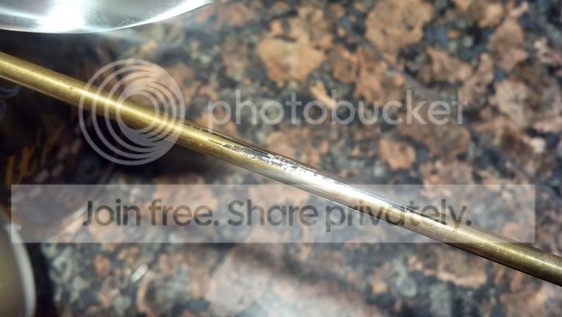

Now to hush my own fears about the HT, I reluctantly did some testing of my own. I sharpened the knife. not to ridiculous but to nice paper slicing sharp. First I did the brass rod test. I was terrified that this would leave a horrible dink in the edge. On initial examination the edge did slightly flex but then went right back to where it belonged on the side glancing pressure test. Next I ran the knife down the rod like I was trying to peel the rod. No edge damage and it shaved of the brass nicely.

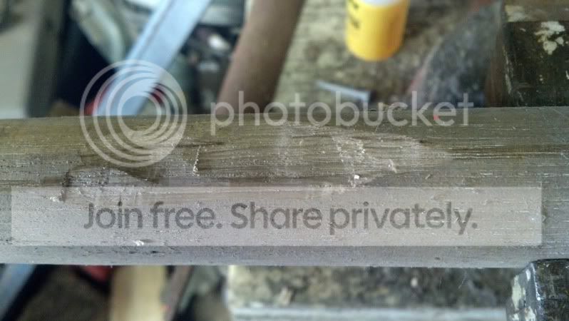

Next I closed my eyes and gritted my teeth and chopped at the rod (not like Conan the barbarian but you get the idea :3:) You can see the dink in the brass between the arrows.

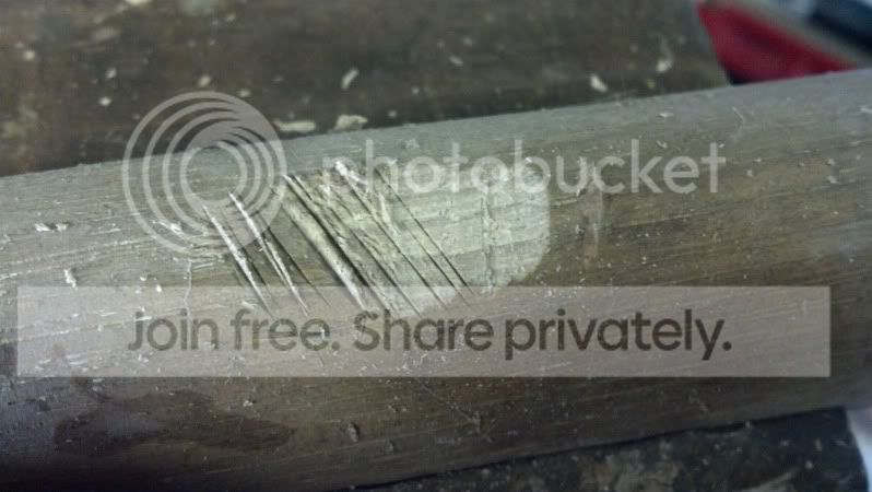

Lastly I took and old hickory sledge hammer handle that I use in the shop to coax stubborn thing into places they generally don't wan to go and hacked at it with the blade. No Damage!
Then I tried to cut some curls from the handle, this handle is hard as nails and didn't want any part of releasing curls but there was no damage to the blade edge from this test either.
Boy I can't begin to express how happy this testing makes me! It may not be a totally awesome RW # but I do think that it will be good enough and will be a very serviceable blade. Again, thanks to everyone who commented and gave me advice. I will put it to use the next time I HT a blade but as for this one I think I'm going to leave well enough alone.
