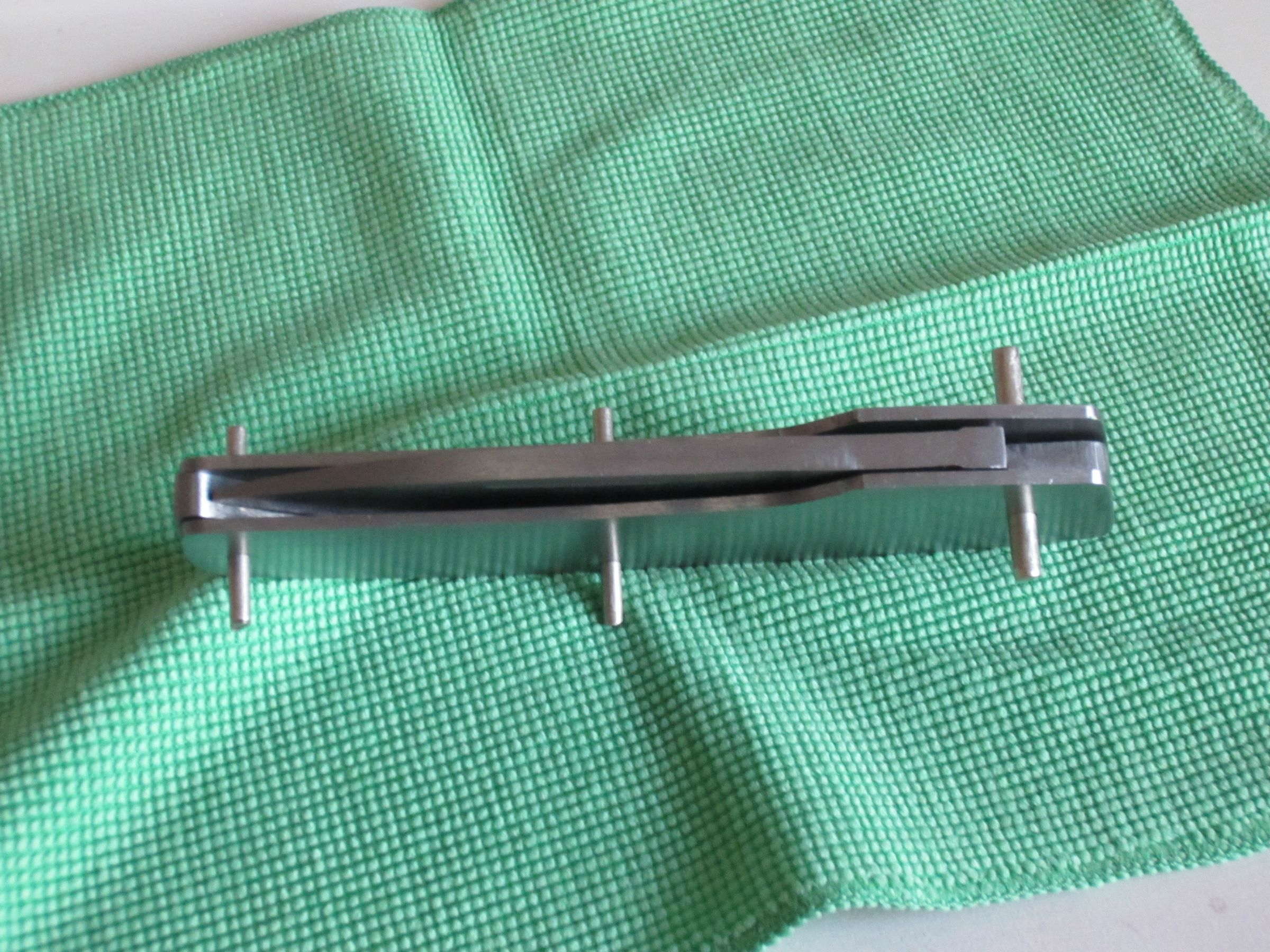

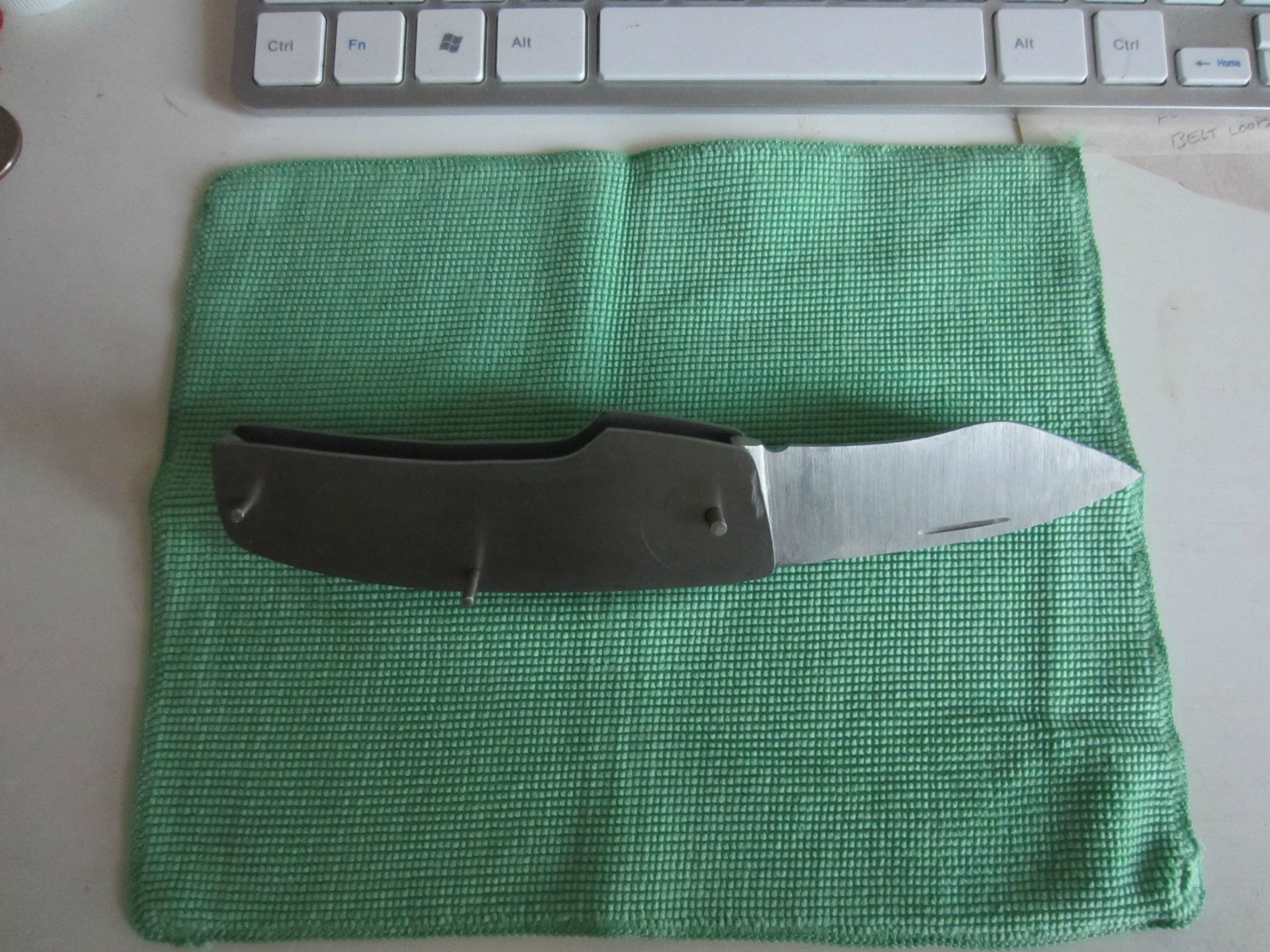

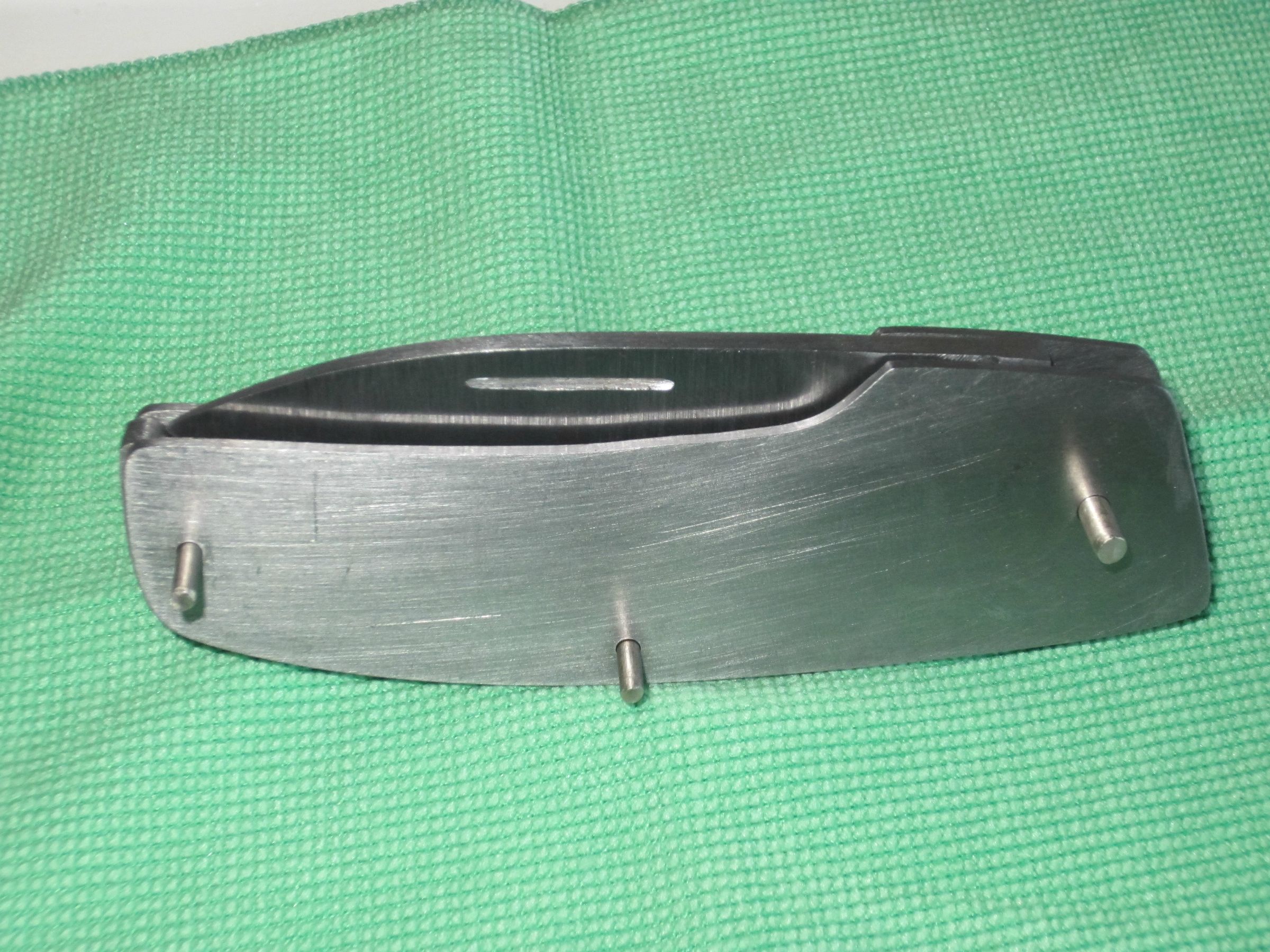

Hello everyone,
I'm a new member and I am making my first knife ( a slipjoint ). I am done up to the heat treating, assembly and fit/finish stages. I was wondering if anyone does or could recommend someone to heat treat and temper my blade and back spring. It is 1095 and I need just this first set done to make sure they will function as a finished knife, before I make more. The problem I am having is "minimum batches" at some point I hope to have enough made to justify that cost, but for now it's just those two pieces. Thank-you for any help.

Very adventurous doing a slip joint as your first knife! Very original design as well. How does it fit in your hand?
Nice looking folder so far.
I would try and finish the nail nick a bit cleaner before HT, as it will be much harder afterwards. Cratex knife edged wheels will work well. Another trick is a small wooden knife edged wheel and grinding compound. Small hard felt wheels will also work.
Thank-you Shane, it fits nicely in the hand but it is a big beefy folder. Thank-you too Bladsmith and I will definitely look into that.
