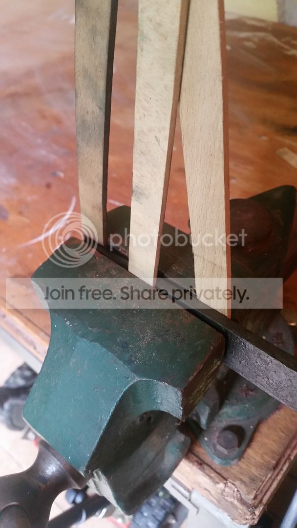

Another way to straighten it would be with 3 pins in your vice. Put 2 on the inside of the bend and 1 on the other side on the apex. As stated straightening at a tempering heat will reduce the risk of cracking. Tighten tour vice slowly when doing this
Haha, 705! That is exactly what I did this morning before reading your post. I felt like a genius, bot I guess the idea is around. :)

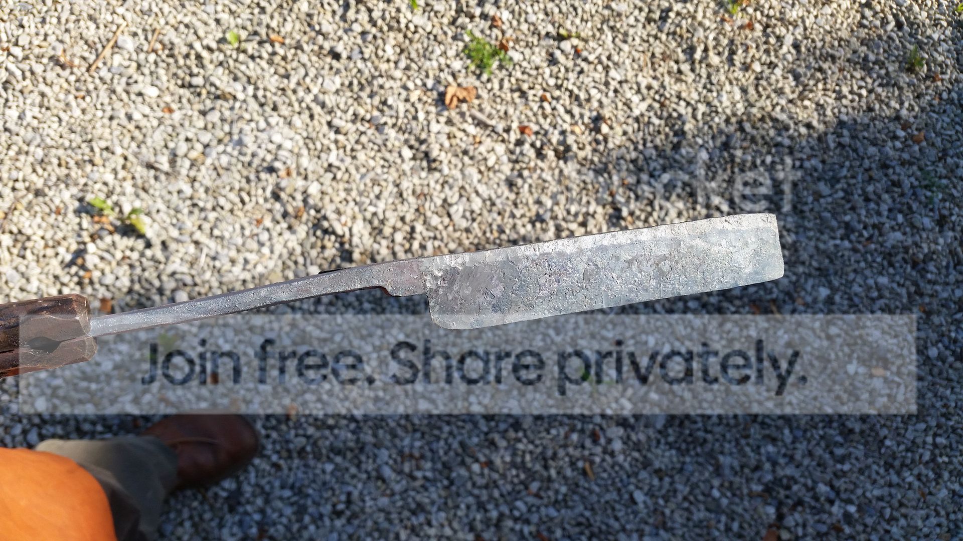

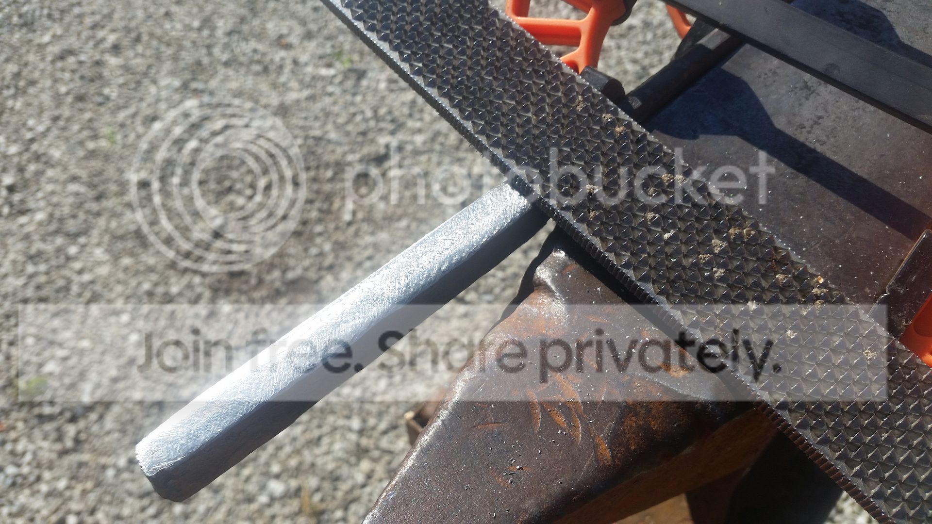

During the normalisation the tip traveled 1/2" from hot to cold.

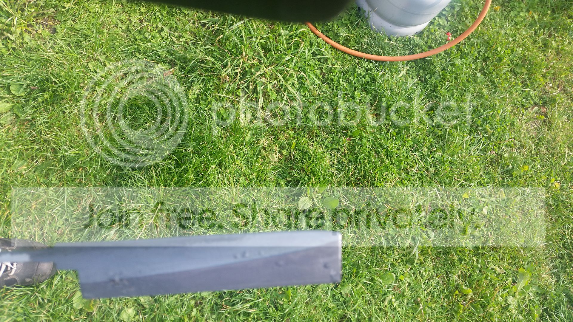

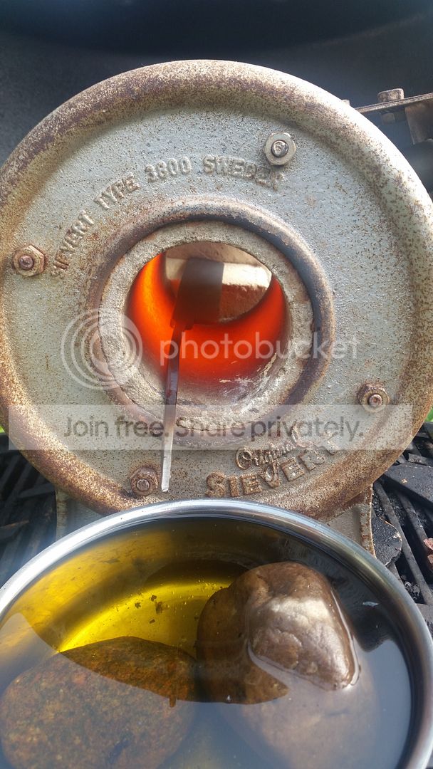

Heat up before quench.

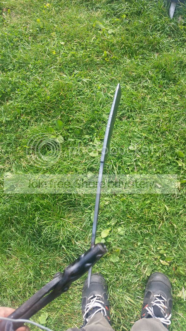

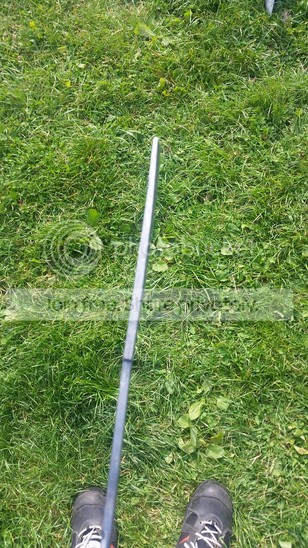

Still hot after edge qunch.

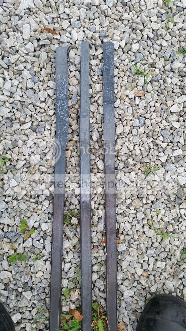

Straight out of the oven after the second tempering. Straighening the back. By moving the sticks you can determine how acute the corection will be and also make asymetrical bends. I have a feeling that the time left in the vice also affect the results (I cant remeber this from engineering school).

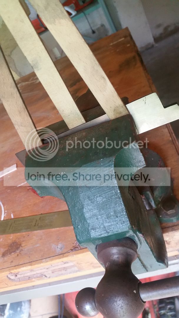

Adjusting the edge.
Fore realy local adjustments the side with two sticks can be switced to leather.

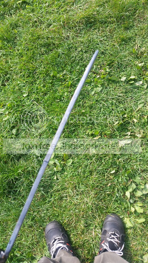

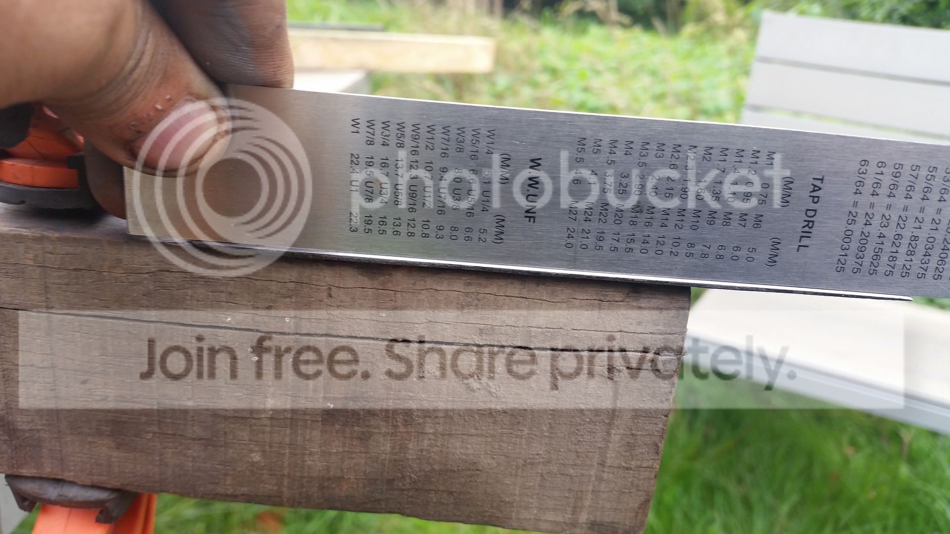

Sucsess!
