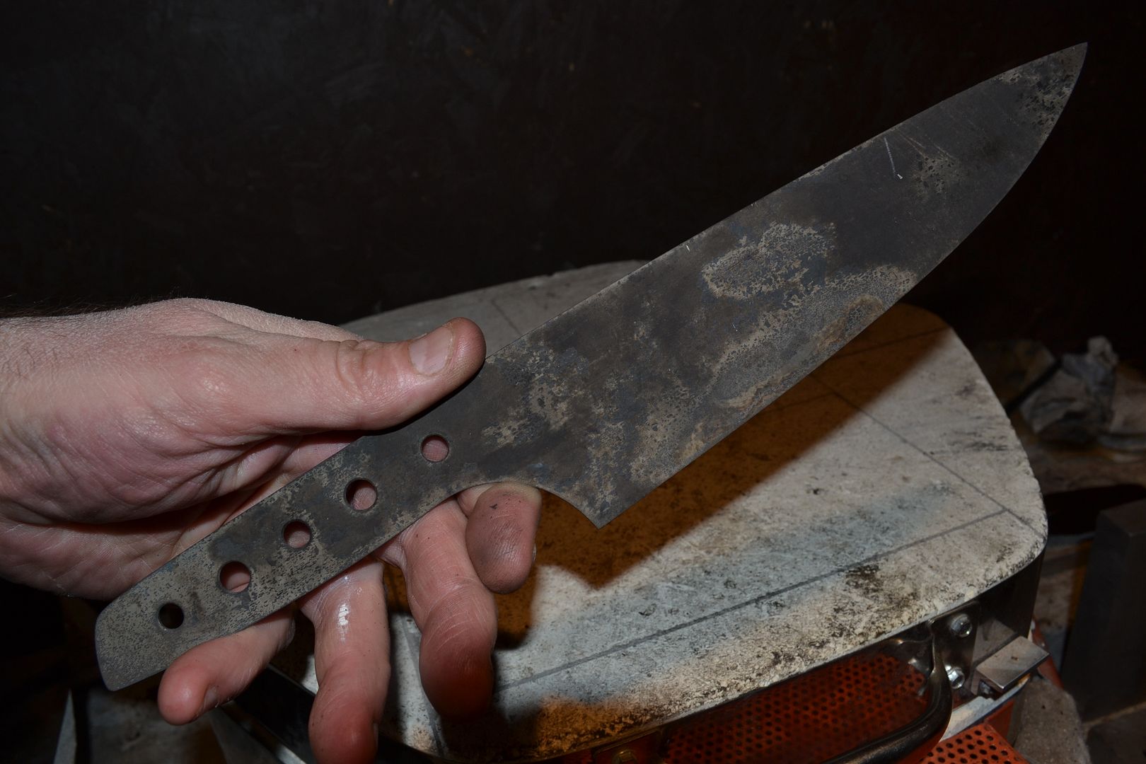

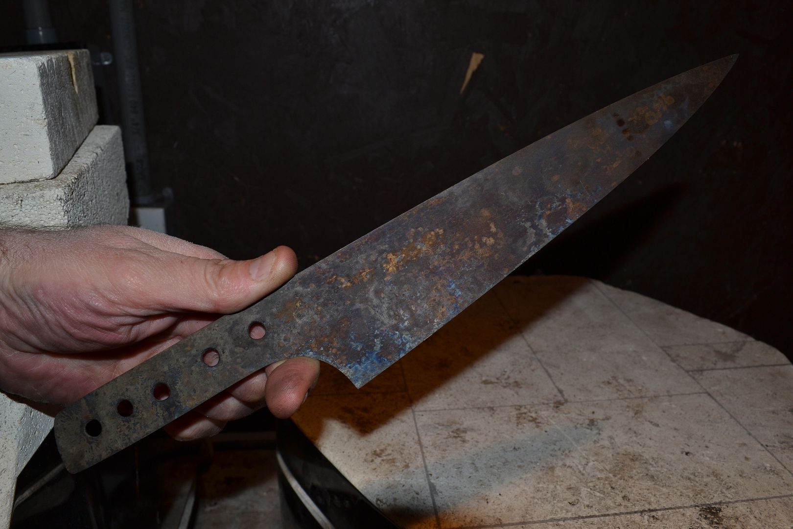

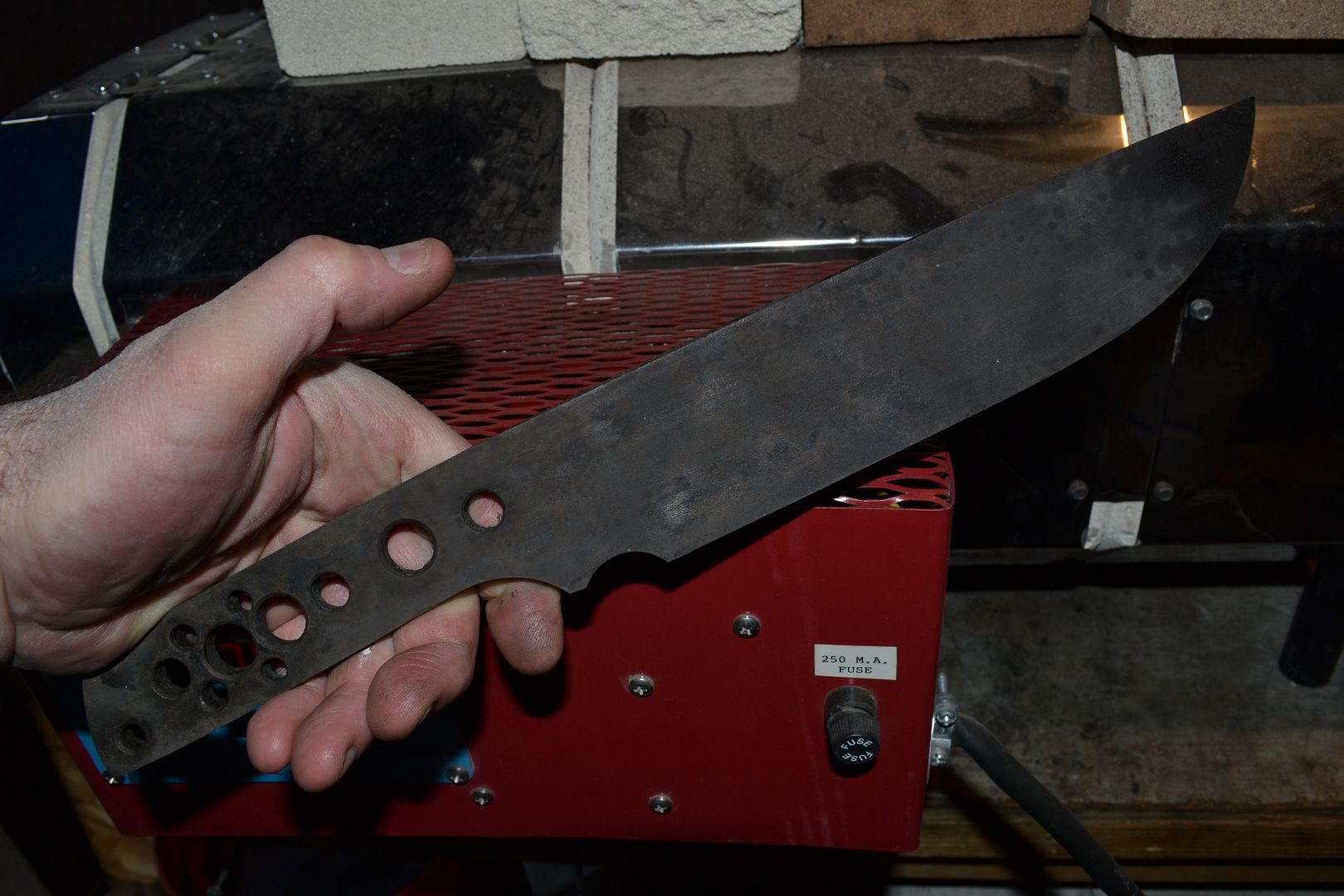

I took some quick shots between temper cycles.
.062" O1 Large Chef's Knife - 13" long - shooting for 61 RC and thin geometry here!
.360" 5160 Chopper - 13.5" long - grain reduced heavily!
.049" 15n20 Chef's knife -12" long - will be a serious tough slicer

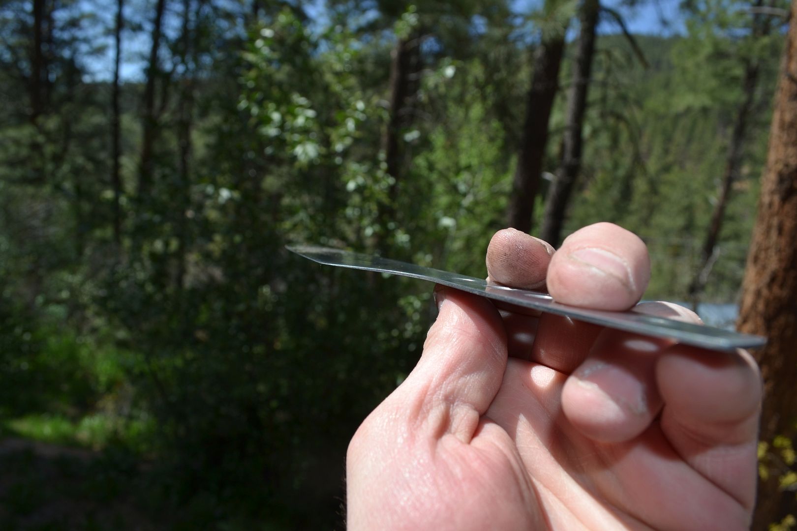

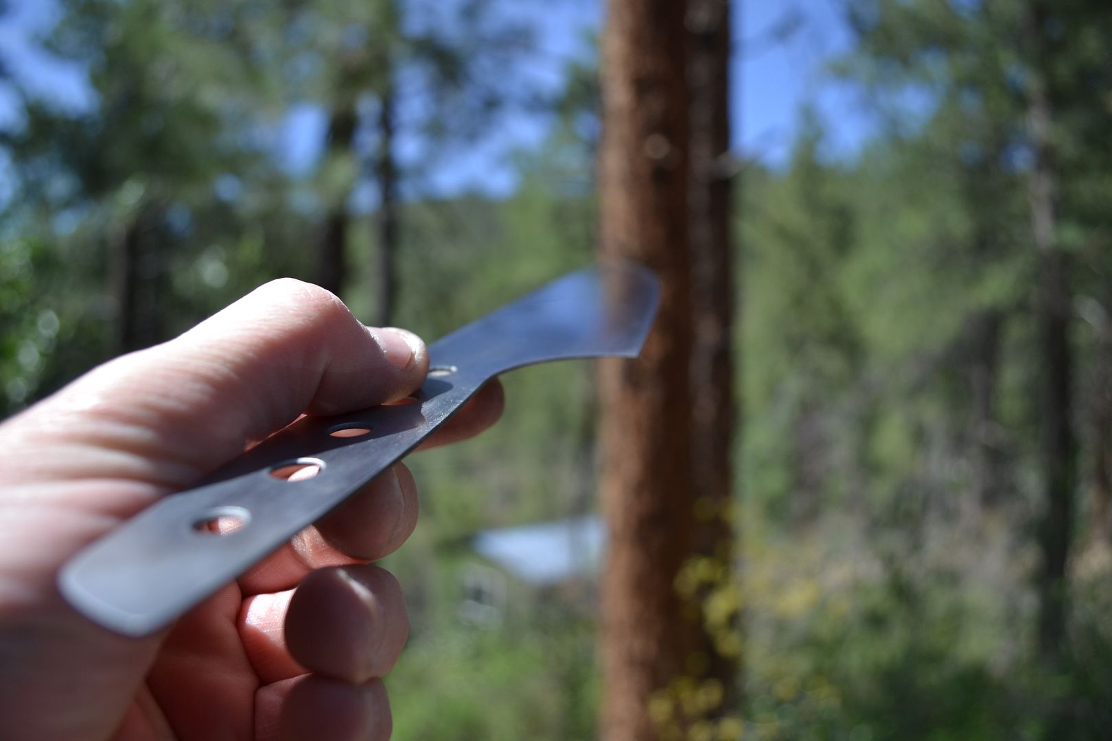

I've been grinding/sanding the 12" Chef's Knife for the last few hours, it is looking killer! It's a full flat double plungeless grind with a distal taper. laser!
Right now I'm at 320 grit hand sanding. The edge is about .010" at the moment.
Thanks!
See-through edge geometry!!!!
OK that was just a reflection but it is a laser!

BTW that's not sharpened, the edge geometry is that thin! :D

I forgot what that was for but cold forged sounds wild! Some would probably bring to 1250 and slow cool (bucket of ashes or pearlite) but I prefer the triple quench you mentioned.
I just did this yesterday with the Chef's knife and my schedule was (IIRC) 1500F, 1475F and 1450 followed by a 10 minute soak at 1490 then quench in 11 second oil until just not smoking and go to the plates. For your purposes I'd consider an interrupted quench after 5-7 seconds.
