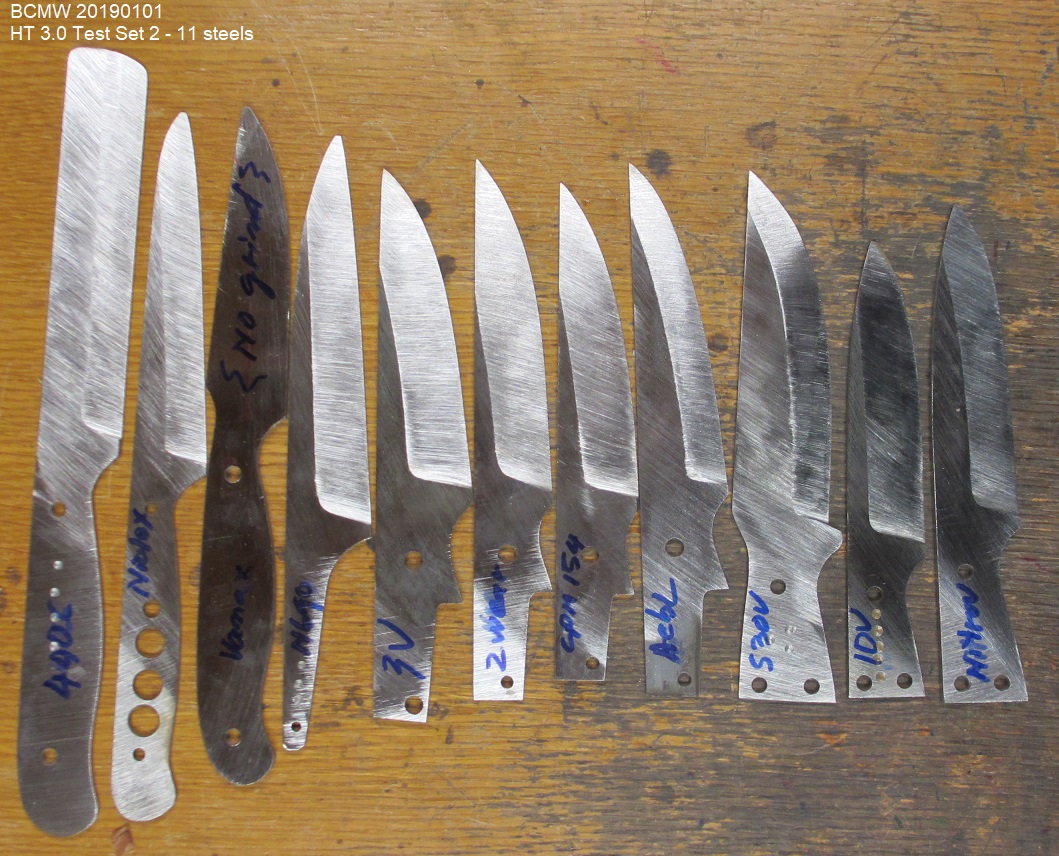

Test Objective: Collect data for edge damage/failure mode, specifically deformation vs fracture/chip. *edge geometry will be varying among test blades.
Steels:
440C ESR 63rc, 18dps
Niolox 62rc, 18dps
3V 63rc, 18dps
S30V 64rc, 17dps
Zwear 64.5rc, 15dps
10V 66.5rc, 17dps
NitroV 61.5rc, 19dps
N690 62.5rc, 18dps
CPM 154 64rc, 18dps
Aebl 61.5rc, 17dps

Just finished another set of ht 3.0 test blades [D2, 1095, cruforgev, w2, 52100]. HT 3.0 process took over 40 hrs to complete. And expect future ht to take longer and longer until diminishing perf gain or die in shock seeing the electricity and LN2 bills.
Result working/testing hardness: D2 66 & 65.5rc, 1095 66rc, W2 65.5rc, 52100 64.5rc, cruforgev no hrc reading yet.
I plan to conduct simple test for this batch using edge geometry: 15 dps, ~0.012" behind edge thickness. Each cut 5D nail 3 times.
To make this test video fun, I will test D2 65.5rc HT 3.0 against Vanadis 4E 64rc HT 2.5. *see previous page for vanadis4e 64rc tests. This V4E knife is from 2 0f 3 set.
