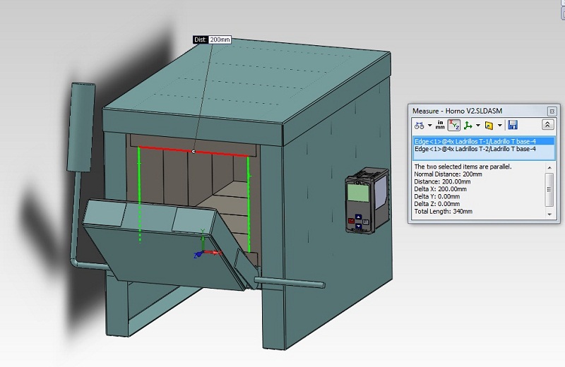

Not so long ago I started to draw/model a heat treatment oven, that its inspired... uhmmm... cloned...mmm... copied :D from the Paragon KM14D
later I decided to reroute the bottom so its not level with the floor bricks
I only need to draw the electronics housing which will be also 1.5mm bent sheet like all the other parts, at the moment I just left the thermostat floating there :)

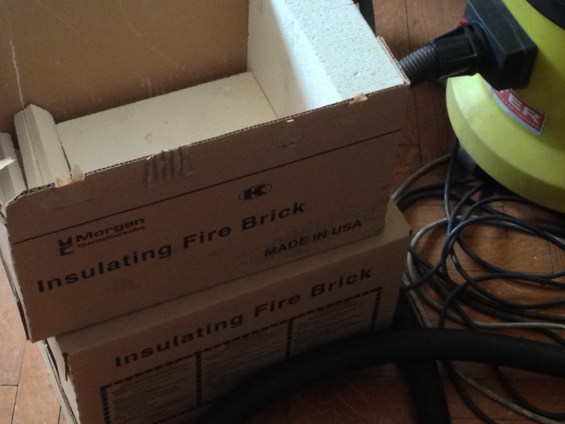

Bought K28 bricks at a local company and purchased these parts in USA:

Also you may had noticed that from the original CAD design I made a change, now the oven is bigger, chamber now is 200mm wide and 170mm tall, depth is 450mm
These are the new renderings:

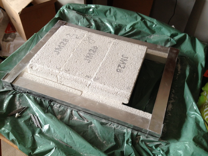

back and door finished:
also purchased aluminium angle to keep everything in place and leave space for the ceramic blanket and the perimeter bent sheets
will make steps to interlock the bricks, more white dust, I will dream of white dust, it goes everywhere!
Pablo

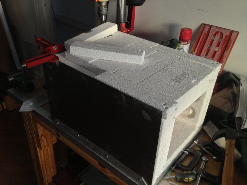

I have dust in my soul.. my god, white dust everywhere! more work done:
only right wall and bottom left to go
Pablo
More...

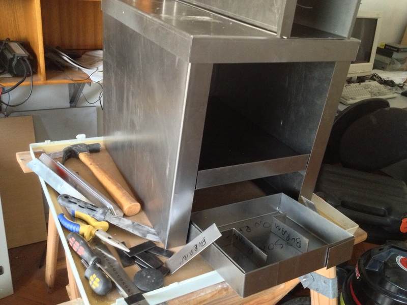

This is the inner structure:
moved "the parthenon" to stands:
Instead of using a file I use leftovers, not as fast but you don't unsharp the file, these bricks are very abrasive
I don't have long enough clamps so I imagined this method to keep everything in place.
Drill and pop-rivetting
To the floor for the n-time to do the bottom perimeter
Doing it upside down
No more work today, I'm tired

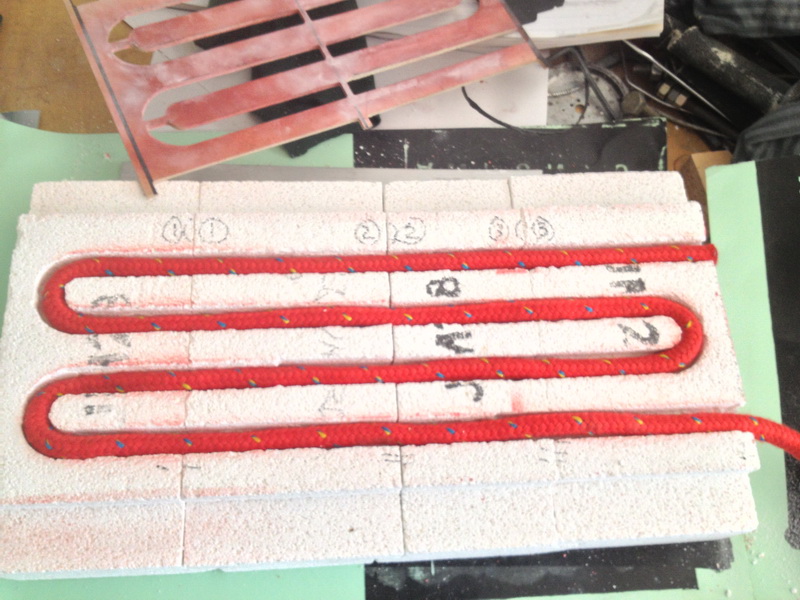

I can't put the vertical angles because I need to route the bricks for the heating elements
Pablo

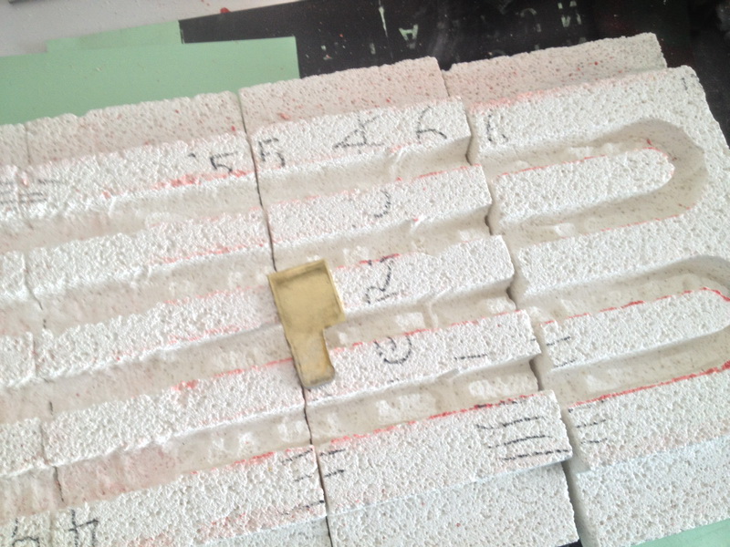

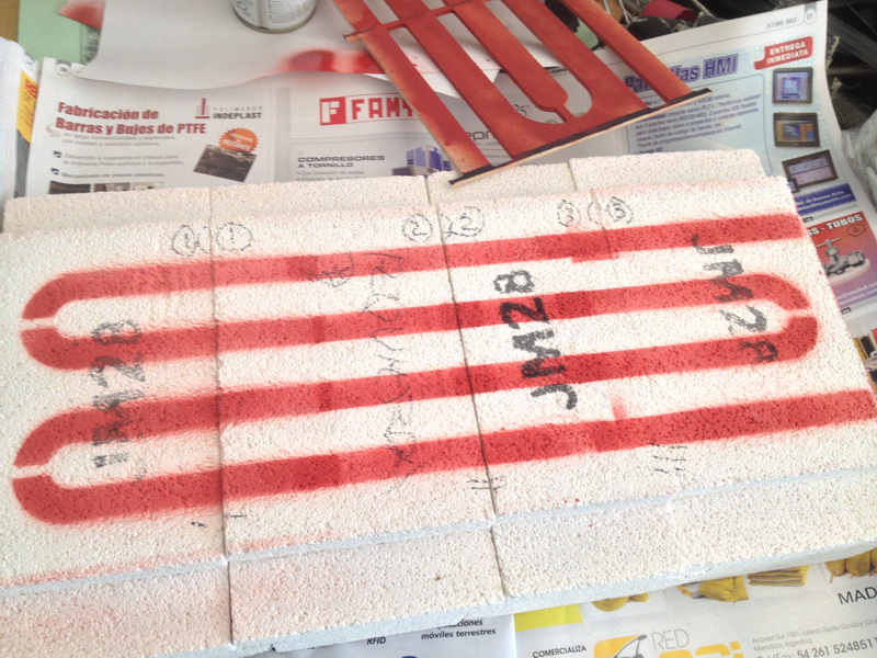

I'm not going to cut the channels on the CNC router, the dust is very abrasive and goes everywhere, so I made a stencil for the channels. Also purchased 1.6mm Sandvik Kanthal A1, cannot find 1.5mm but re did the calculations and 1.6mm was better than 1.8mm which was the other measure available. Using a lathe and a 10mm rod made the 2 spirals that I plan to use in series.
Only made the ends of the channels
To be continued!
Pablo
How easy is to work with a template! dremel (actually B&D) old dull endmill and making the channels was a piece of cake, I cannot imagine doing it manually any other way...
Pablo

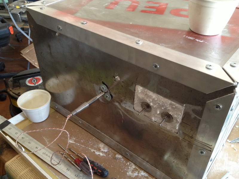

the aluminum structure wasn't enough, so I ordered sheets for the sides, now its super compact, this is the inner structure, on the outside there is going to be a ceramic blanket and then the structure from the 3D renderings.
Pablo
more work done, all screws/washers/etc are stainless steel, still need to add pieces of kanthal wire all along the channels to keep the spiral in place.
Pablo

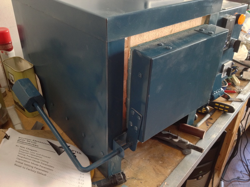

Inner work finished:
Pablo
Time to do some tests:
Put blanket underneath just in case, K thermomether and the attached thermocouple, thru a 25A switch I powered the oven:
ITS SLOW!
Did not measured current, but I measured 225v at the line, 20.3 ohms for the windings, it should be around 11A, here it is after 25 minutes were it reached 450C:
Not fully glowing yet.
Using my phone as a timer I measured how long it took to climb 10C, at the start of the test it was at 400C:

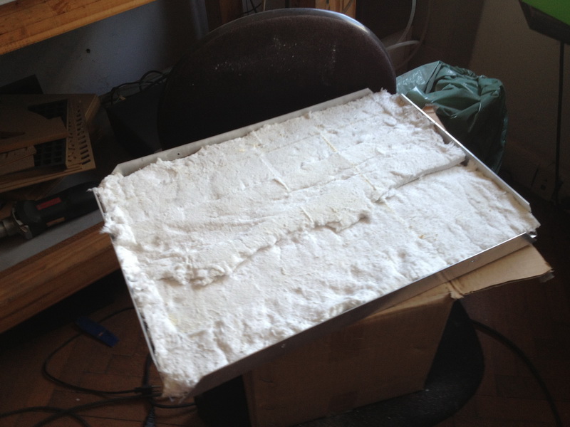

What do you guys think about trying to fit the ceramic blanket around the oven INSIDE the metal sheets to compensate for the higher thermal conductivity of the jm28 bricks? or its a lost battle from the get go?...
Pablo
Pablo,
I mulled over the idea of using blanket outside the bricks. It didn't seem to offer me much benefit and looked like a fair bit of hassle to do (or at least, to do neatly).
There are 2 things that are likely to be going on with denser bricks to cause slow heating.
One is that the thermal conductivity is higher.
The second is that the thermal mass is greater.
Whilst adding blanket will help with the the thermal conductivity side of things, it won't help with the thermal mass issue.
I'd only consider adding blanket if it will not work as it stands and time is really tight. Bear in mind that you can use cheaper insulating materials on the outside, as they will not see the high temperatures. Mineral fibre or glass fibre temporarily wrapped around the outside should tell you whether or not it is worth pursuing. If so, you can design a tidy permanent system.
If it gets to temperature as it stands, but is slower than you'd like, I'd be inclined live with it for now and start collecting the parts to build a complete new oven (using Thermal Ceramics JM23 IFBs) and fit plugs and sockets on the control box. That way, you can Austenitize with the new oven and temper with the slow one, without having to wait for the first oven to cool.
If it will not reach temperature but you have the time to gather the bits, I'd again suggest a new oven build.
Regards
Tim
By this you mean that the bricks absorb heat that should remain in the oven? Im not quite familiar with thermodynamics :) thanks!
Pablo
Yes, the bricks absorb heat to get up to temperature.
Raising 2 kg of a material by X degrees will need twice the heat input that raising 1 kg of the same material by X degrees will need.
Even if the insulation value (thermal conductivity) was exactly the same for both brick types, the oven would heat slower with the denser bricks.
Tim
went to purchase 23 type bricks but the factory was sold out, yes, they are made here, hopefully the quality is equal or better than chinese, is there something I should look for? Thanks!
Pablo
timgunn1962 said:
I've had 3 noticeably different types of type 23 IFB.
The first oven I built was made from what I tend to view as "bubbly" bricks. There were marked as something along the lines of "GRD23LW".
The second was made from Morgan Thermal Ceramics jm23 bricks, as were the next 2 or 3. I tend to view these as "chalky."
The most recent was made from GRD23 bricks, which I tend to view as "cementy."
The Thermal Ceramics JM23 "chalky" are certainly the ones I'd choose for preference. They are the lightest and seem to be the best insulators by some margin. They are also the easiest to work, again by some margin. Their disadvantages are high cost and softness. The softness does not seem to be a serious problem in an HT oven. The cost, around twice that of the "cementy" ones, is not enough of a problem to stop me using them. They probably add under £50 to the cost of building an 18" (450mm) oven here in the UK. This probably works out at 10-15% of the total build cost and I feel they give a product that is a good 10-15% better for using them.
Next best, IMHO, are the "bubbly" ones. These have visible bubble holes in (I don't have one here to look at, but I'd guess the bubbles are around 2mm in diameter) and are denser than the "chalky" ones. They are pretty hard on tools, so shaping them with hand tools is a pain. They will rout easily though, so cutting the grooves with a router solves a lot of that problem. They are in the middle in terms of density and their insulation seems to be good, though not as good as the"chalky" ones. They are harder than either of the others and seem more resistant to general knocks and bangs. Sometime, I'll build an oven with bubbly bricks for the floor and chalky bricks for the rest, as I think it would give the benefits of both types.
The "cementy" ones are the cheapest, densest and seem to be the poorest insulators. The surface texture is fairly similar to a sand & cement mortar or the sort of rough-and-ready site-mixed concrete I used for my shed base. I tend to use these for gas forges now, and use JM23s for the ovens.
I appreciate this doesn't help you a lot 7,000-odd miles from said shed base, but it's about the best I can do; the differences are very obvious when the different types are side-by-side, but harder to describe.
If you can, try weighing the bricks before you buy them. I only recall weighing a "bubbly" one, which I think came to around 1.4 kg for a standard (230 x 114 x 76mm) brick. I have a vague feeling the JM 23 goes closer to 1.1 kg and the "Cementy" ones are probably nearer 2 kg.
