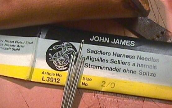

Contact Mid-Continent Leather 1-800-926-2061 and get a catalog. They carry various types of Osborne Needles including sail makers needles that are in sizes from 9 gauge ( .144") on smaller.
AKA, hand sewing shoe makers needles
I got these from a Dexter shoe, shoe shop.
I have not broken one yet..
http://www.knivesby.com/dan-sheath-tutor-1.html
Yeup, those will work too and they also come in 3/0 size which is even thicker. Sailors Needles are pointed though so might be better for an altoids size kit.
