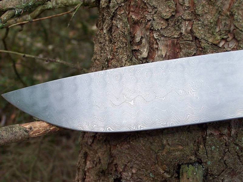

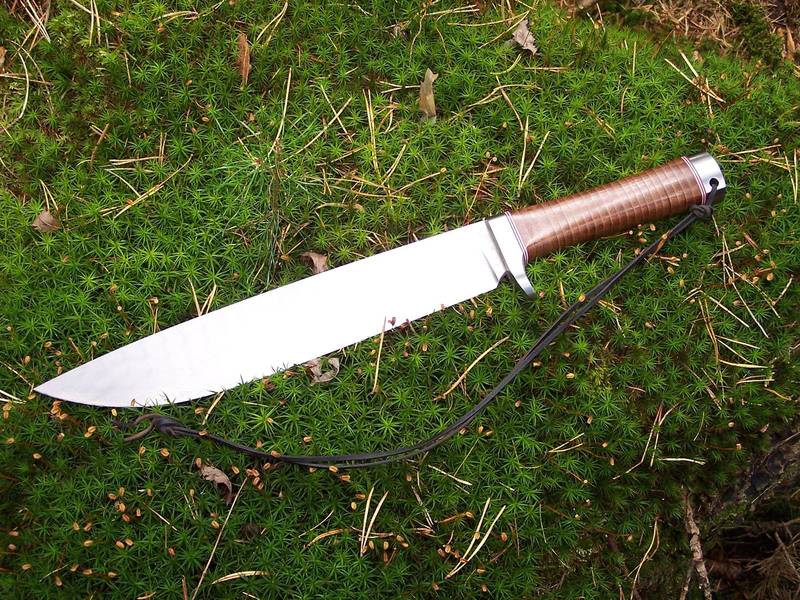

Blade: 600 lay damask of J.P.Stienen 270 mm long, 47 mm high, 5,1 mm, easily balliger grinding
Parierelement and final toggle: Titan
Clutch: Leather

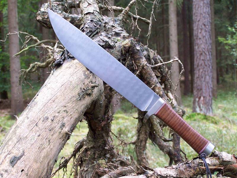

I love the tone of the stacked leather handle,and at first I thought the guard was too big but the knife is so huge it fits well. It's a good looker that looks like it could also do some serious work. Well done!
And the tree ran screaming.
Then thought maybe if you were going to die, that's not such a bad way!
I love it.
Many thanks for your interest.
The leather is sharpened with sandpaper grain 400 (the grain 400 is smaller in Germany than in the USA), with beeswax sealed and polished.
