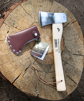

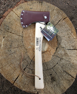

The hatchet comes with a thin, riveted leather sheath along with a small foldout brochure which explains Helko's history, type of steel, and the 5 year warranty.
The sheath has two belt loop slits 1.5 inches wide. I did try it on a thinner belt and it held the hatchet fairly secure, though only field testing will tell if it actually stays put when brushing against tree limbs and bushes, etc.
Rear view of the sheath:

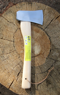

The head comes highly polished, which is very unusual for a hatchet in this price range.
Handle/Grain​
The handle is made from Ash and the grain is definitely less than optimal, but not the worst I've seen either. On hatchets, grain direction is generally not as much of a problem as compared to axes, since they aren't subjected to as much force during the swing. The handle is also covered with a thin lacquer.
Alignment

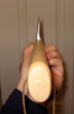

The alignment on this hatchet is almost perfect, though the end of the handle was milled slightly uneven.
A better shot of the alignment vs the end of the handle:

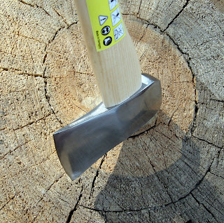

The head is pinned to the haft with a traditional wooden wedge and reinforced with a round metal wedge. There is a small gap at the front of the eye, but overall it seems to be held together securely.

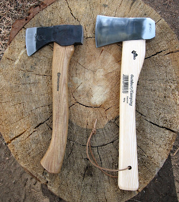

Here's the Helko next to a rebranded Wetterlings Wildlife Hatchet. The Helko is 14.25" long compared to the Wetterlings which is 12.5". Helko lists the head as weighing 1.1lbs, but I think the weight is actually 1.4lbs, since it's 3 ounces heavier than the 1.25lb Wetterlings.

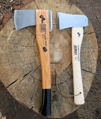

The Camp hatchet next to Helko's Vario 2000 Convertible Hatchet:

The edge profile is slightly thicker than the Wetterlings, but not too bad either. Before field testing it, I plan to hit it with a file and sharpening stone to thin it out slightly.
(Helko is on the left)

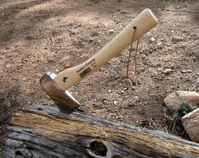

Here's an update on the Helko Hatchet........

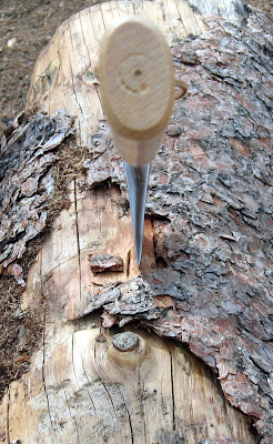

Steel! The steel on these has to be as good as a Gransfors Bruks. Edge-holding is superb. I did a little more profile work and was able get to this hatchet as sharp as my Mora Clipper. I'm talking screaming sharp. Could never get a Council Tool this sharp.

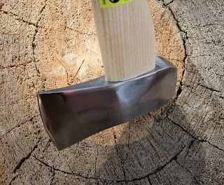

The hammer poll is deceptive as well. It is larger than it appears in the photos and hammers really well. I let my stepson split a large log with the Helko by driving two self-made wooden wedges into it. The straight handle allows a two-handed grasp, which helped to hammer the wedges into the log, easily splitting it.
I also let my stepson chop through a bunch of branches and small, dry logs for a day. There was no loosening of the head after he used it.
So far, this is looking like a great sleeper hatchet. They really have the steel down, plus the polished head looks fantastic.
