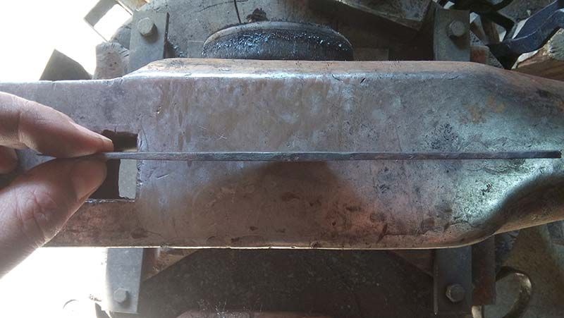

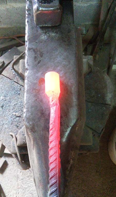

Some time ago i found this M18 Hellcat (used as a AT target), and noticed that turret rim is busted open with rocket hit.
I've managed to get some of steel balls out (turret rim is large ball bearing)
They are 32mm in diameter (1,26"), and after some cleaning...
i weld them to a handle.

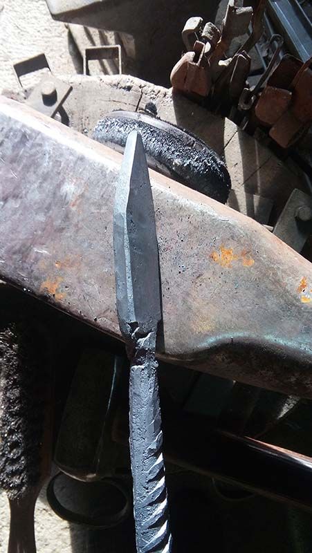

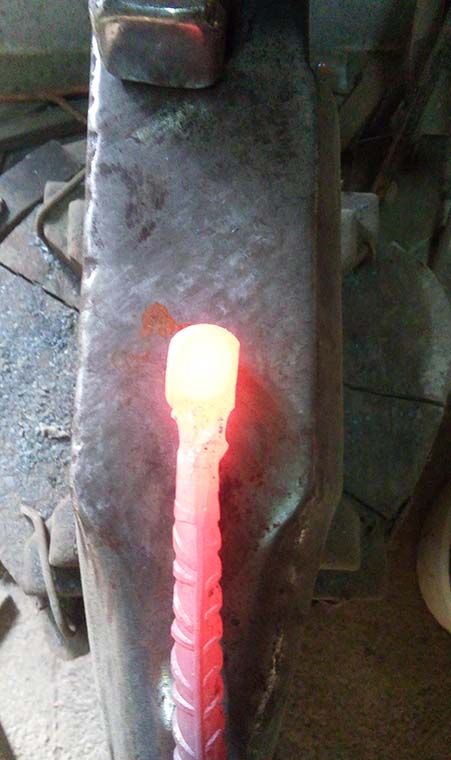

After some drawing out

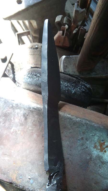

They look like this in various stages of forging
I already made two test pieces, treated them as 52100 (full process), and they perform great. (didn't take any pictures)
Sorry for lots of pictures, but i thought this can be interesting project.

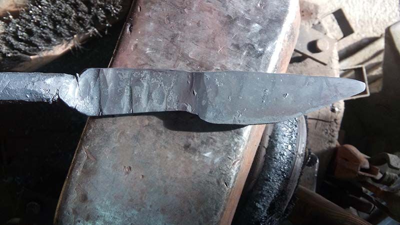

Some more pictures...
After tempering in electric oven, i clean the blades with sandpaper to see temper colors, and do final tempering with torch while part of the blade is dipped in water.
Today, after first sharpening, i did some blade testing and all went well.

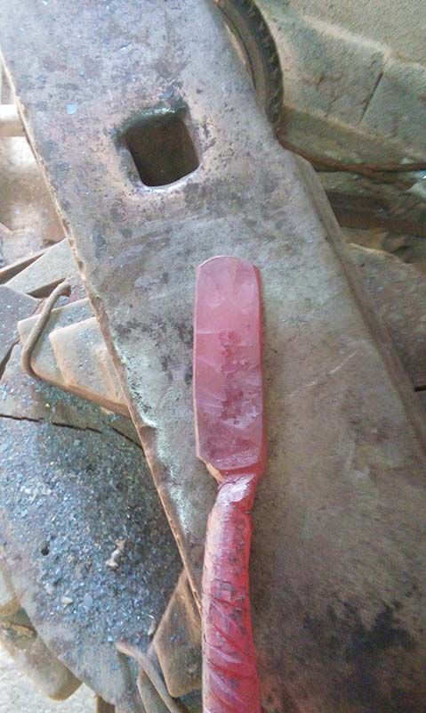

Some more wip pictures (the way i do it...)

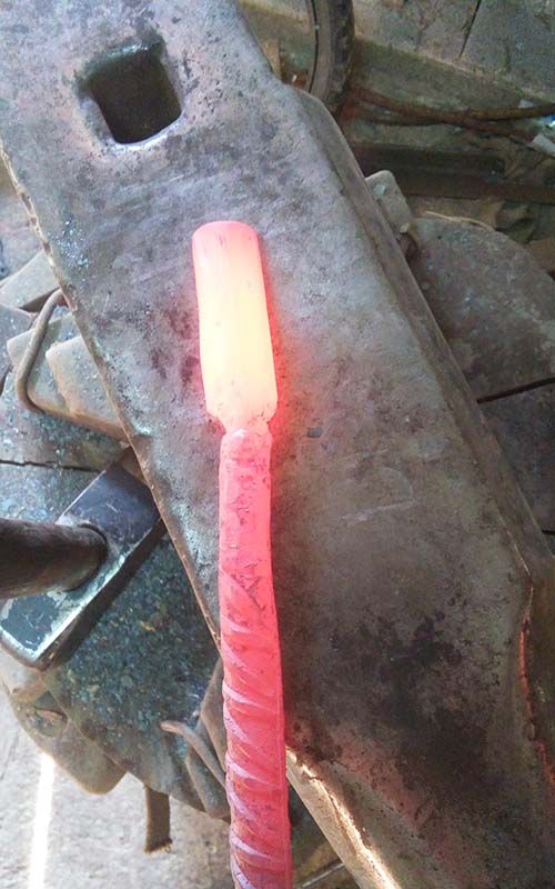

I start to forge ball to roller,
and then draw that roller out longer,
and longer
When it's drawn out to desired length, i make it flat but still thick

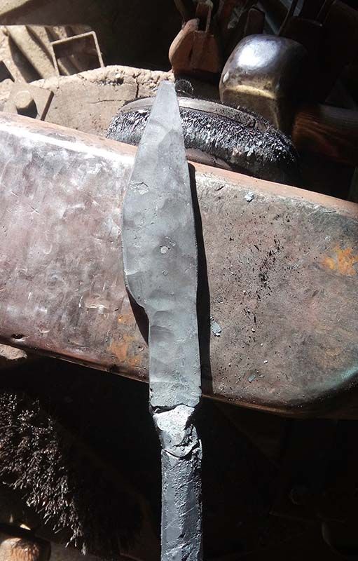

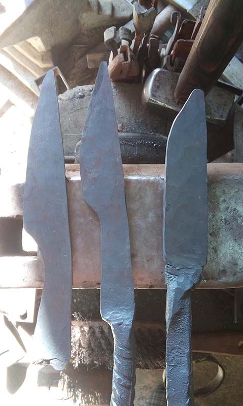

Then i start to divide material for the blade,
tang,
and draw them out to desired thickness
Three of them, in various stages of forging
Flat and ready for edge cleaning

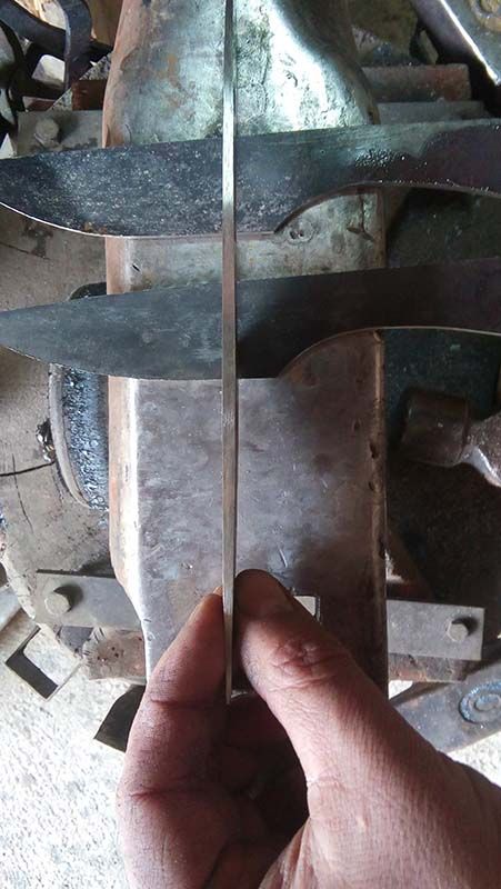

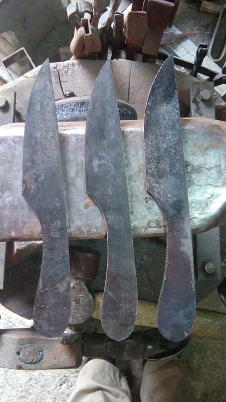

After edge cleaning and profiling,
with nice distal taper
