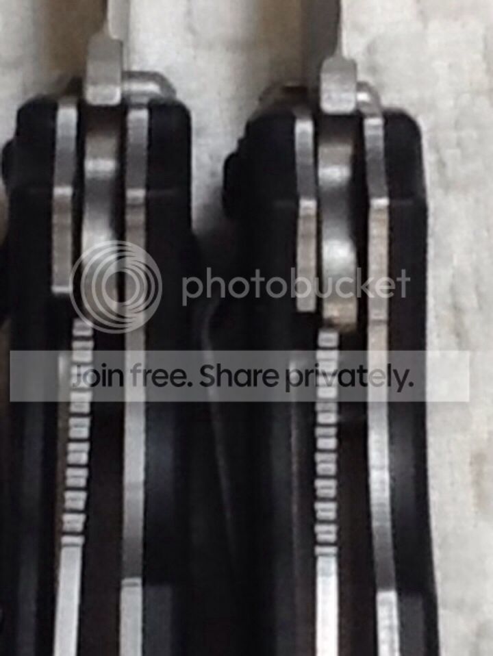

To give you an idea about the lock bar settling over a bit, here's two identical Kershaw Random Task II. The one on the left is brand new, never used. The one on the right has been carried and used.

Thanks, it must have been a shadow, I wouldn't worry about the lock up, is fine, I'd rather it was a little early than late, you can always adjust early, can't really come back from late.
