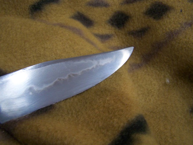

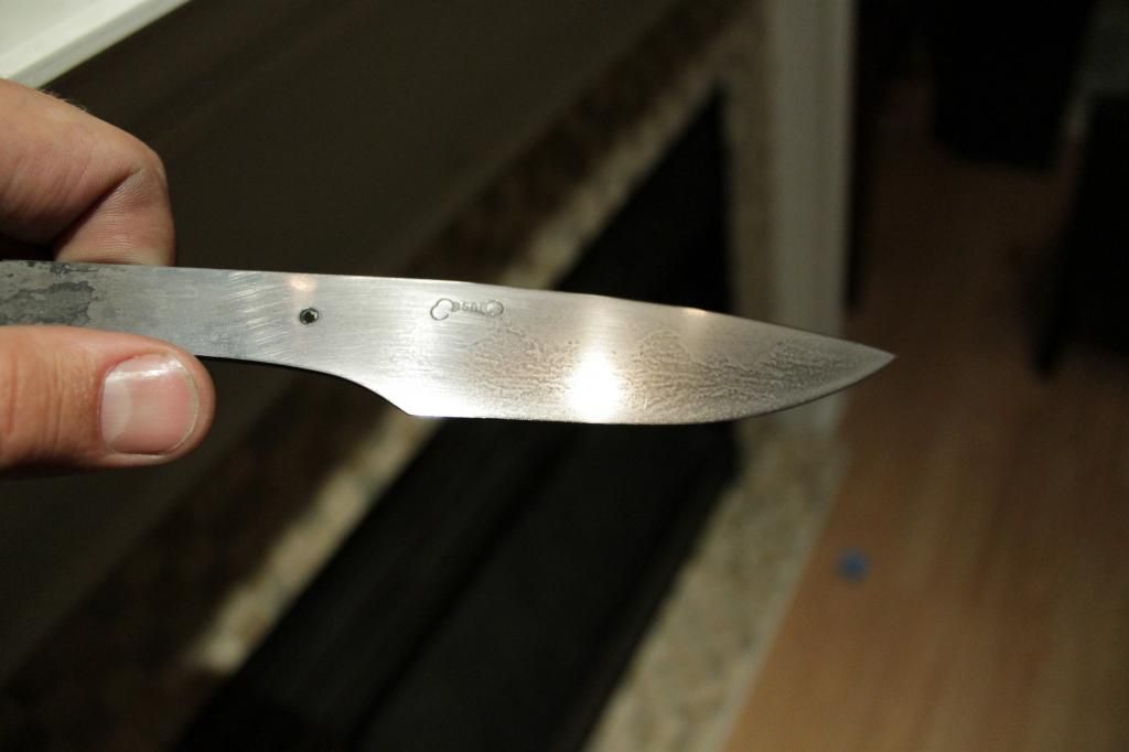

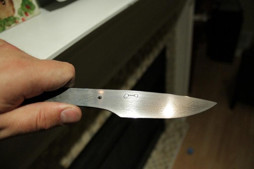

I have a couple of blades that I am working on, made from Aldo's 15n20. It's 1/16" thick. I am wondering if anyone has tried, or has gotten a hamon out of this steel. According to Aldo the Mn content is .35, so it seems that a hamon is a possibility.
I want to try it out, so this is my plan.
-3 x normalize, 1600, 1500, 1400
-thin wash over the entire blade with satanite
-thicker clay pattern along the spine
-Austentize at 1475 and hold for 10mins.
-quench in 130 degree canola.
Any recommendations or experience with 15n20 would be appreciated.
