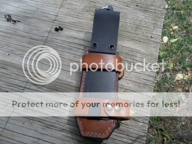

the holsterex is the same pattern on Both sides...so when ur making single thickness items (like my attachments for tmy 9 rig) it looks the same no matter how u bend it. I wanna try some of it out.
u can see here where each side of kydex looks different,,,with holsterex it would look the same.
