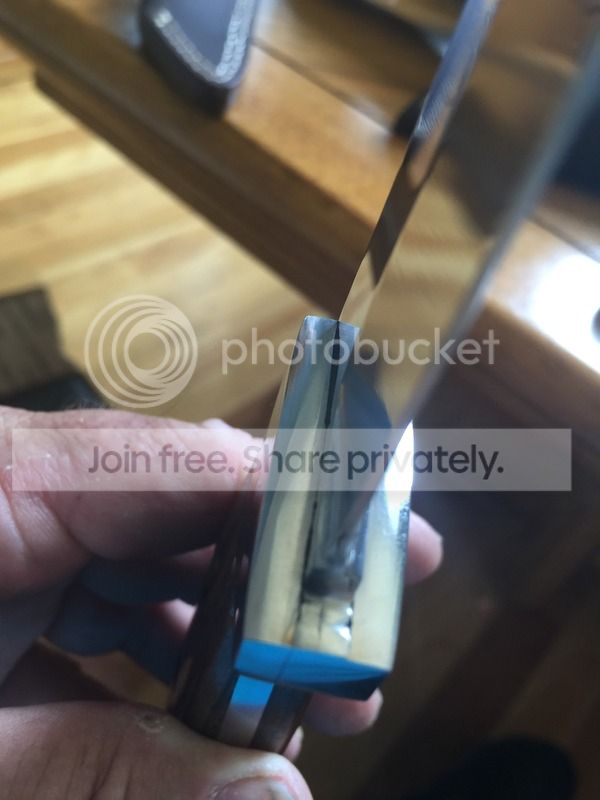

I had an acquaintance give me a knife he would like 'fixed up' it's handle scales are in good shape (stag) but the blade needs a lot of attention and the challenge for me is that the bolsters (metal) have gaps between them and the blade, on the front side. I think that if I was replacing the handle scales, I would try and apply heat to the blade on the back side of the bolsters, and paint some flux along these gaps on the front of the bolster and then let some silver solder melt on the front side-and hopefully fill up the gaps. What I would like advice on, is how can I fill in the gaps when I'm going to leave the handle scales in place??

Andrew, I'll try and get a pic or two up later--I really don't want to remove the scales--they are very nice stag and I'd hate to bugger them up at all. I'm pretty sure the bolsters were soldered on, I don't know if they were also pinned, I'm looking and don't see a pin outline, but it could definitely be there.

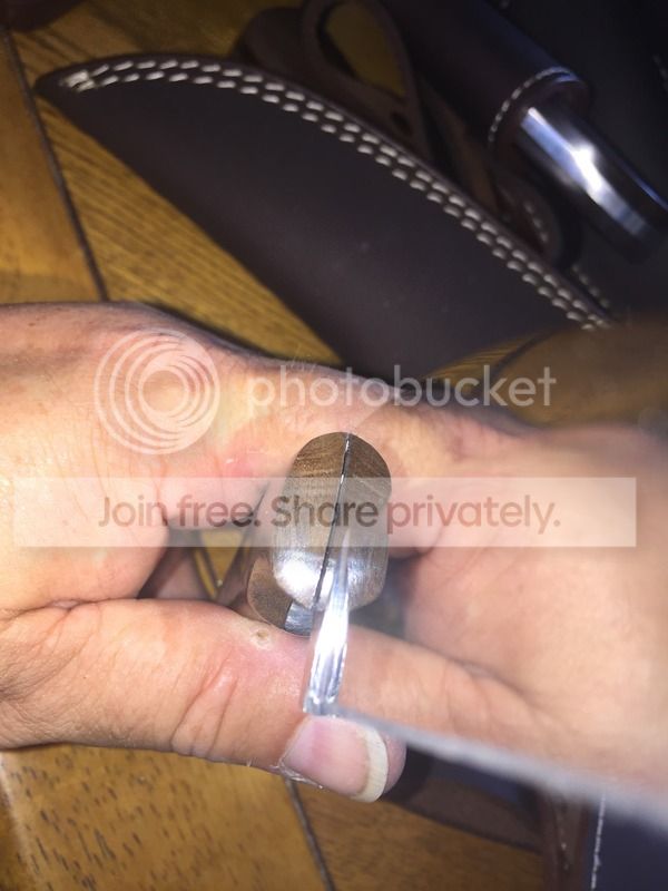

These are two shots that show the bolster gaps pretty well.

If you heat the bolsters hot enough to flow solder, you will destroy the scales. And the solder won't flow where you want it to.
Plan B is in order.

I think you're showing two different knives in those pics?
Either way, I think you may need to remove the scales to properly do this job.
The knives look to have been made that way. It will require a complete dis assembly and rebuild to correct it.

AR, you are right, I just had another knife that showed the issue at hand, so wanted to put both pics up to illustrate--
