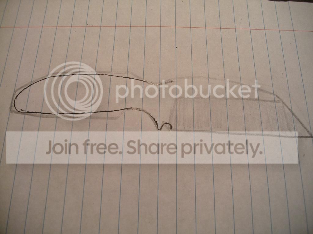

Edit: If I were you I'd also change up the handle. I drew a picture of your design with a more organic shape to the handle but my camera is not cooperating.

I'm planning on smoothing over the top thumb ramp but I'd really like to see your idea.

I borrowed a camera
Not exact but you get the idea. Your design is in pencil, my suggestions are in pen. This is what i meant by organic shapes as in flowing lines. I'm not sure how wide your handle is so I can't tell if what I drew would be too slim.
I would put more of an arc to the entire spine also. Not really function but i think it would look better. If you don't thats fine, just different tastes.
Very nice!! I made 6 or 7 cartboard mockups before choosing the one above... I wanted something simple for my first project and that's why I stayed away from too many contours.
But with that said your design looks almost exactly like one of my other samples so once my skills improve I'll be making one that resembles that for sure ;)
