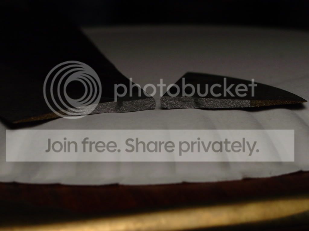

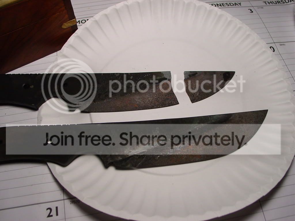

my problem lies with the 1080, 3 out of 4 blades have gone PING when i quenched them, and i was hoping to get some insight to fix this.

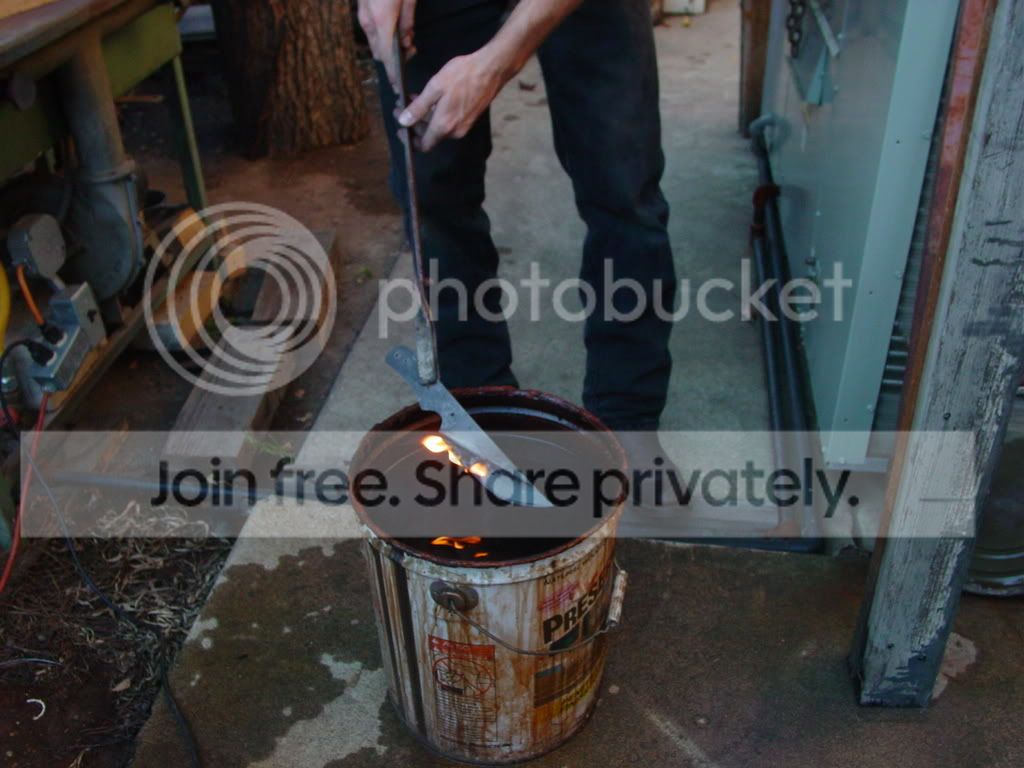

Im using used motor oil (free!) around 100 degrees or so. quenching for 3-5 seconds, interrupting for 2 ish, then a few more seconds, and it starts to cool. seems to be cracking the second time i quench it. what should i be doing?

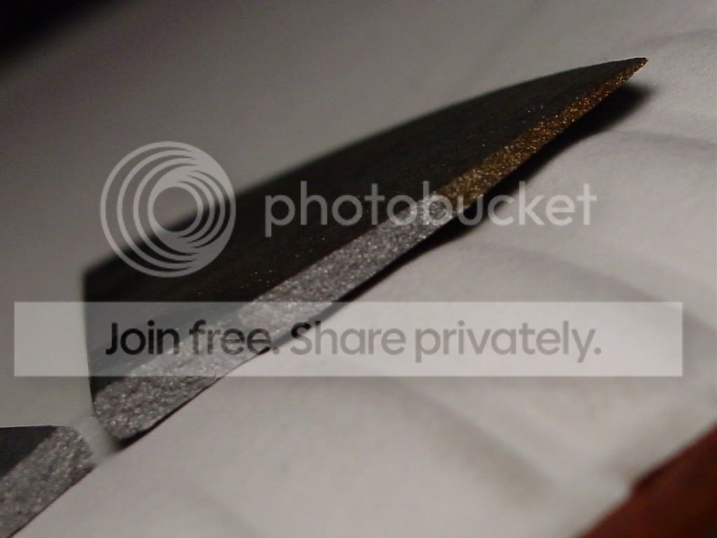

below are pics to show the grain of the one i broke off. i have nothing to compare it to, so how does it look? you can see the color of the temper at about 420 where it was cracked.
any help, suggestions, or comments welcome. im trying to read all i can find on this in the mean time. thanks.

they both cracked in almost the same place. the other im going to sharpen and cut some things, wood, concrete, steel. get an idea how hard the edge is. the one i broke took allot of force, and it wasnt a clean snap, more like snap and pull it the rest of the way, cause the core was connected at the spine, if that means anything.
I'd have to say the blade was too hot when you quenched it. Try this process next time use a magnet on the end of a rod, when the magnet no longer sticks to the blade, quench then, also motor oil is a good quench, (stinky but it works) I've had nothin but leaf springs, in my forge and I quench in water, I've yet to have one go ping!
iv always heard to go a good couple clicks hotter than non magnetic to get it fully hardened, and iv always quenched 5160 in oil and theyre screaming hard, maybe i'll do a test blade in water.
if the steel truly is 1080 that's just about an eutectoid steel that means you're at critical temp right at non magnetic, taking it higher will just cause a lot of grain growth. From the discoloration in the crack, it looks like some of the cracks may have been there before the quench.
discoloration is a dark yellow from tempering. darker than usual cause i threw them in the oven and forgot about them cause i was angry at them. if thats true then i may be quenching too hot. any more thoughts? Ed Fowler? help?

Looks like coarse grain, probably too hot at quench. You only need about 50 deg. F. above non-magnetic for most steels. If you do your quenching at late evening or early morning you can see the color change most times. I use a magnet, but I also watch the color change. Make sure your light conditions are as close to the same everytime, slight differances in ambiant light will make the steel change colors.

i use the cultivator discs you are talking about. the steel is 1075 if john deere made them. the ones i use have this serial # on them ss0032 and this number n214190. you had your blade way too hot. notice the pitted appearance. if you have an cutting torch, turn the oxygen down so you have a soft flame. in a dark room or at night is the best time to do this btw. heat the edge till it gets to a slightly bright orange then quench the edge. i would experiment with some scrap pieces till you get used to the color that gets the rockwell you want.

I was actually refering to the dark spot further up the blade in the thicker area =)
LK, I take my blades to 120 before quench....maybe you missed a deep scratch. By the looks of your pics I would say you over heated the blade too.
Also looks a little thin in my opinion.

Justin Mercier, thats a shadow, thanks though :)

I'll throw one in that hasnt been mentioned yet. It looks like from your pictures that you are quenching with the blade horizontal. Hold the blade vertical when quenching. If the blade goes in flat, then that side cools much quicker than the top, and you're going to get warpage, at best. I also agree that the blades appear overheated. If you're using spring steel, or disks, break one before heating it to see how fine the grain should/can be when broken after quenching.
