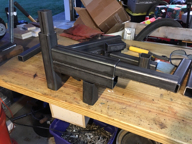

I believe a 1hp may be a tad undersized, I mean it will certainly grind and any grinder beats no grinder (in my opinion). Do you have a plan for the frame? I'm currently building my second grinder. I'm following the plans here http://dcknives.blogspot.com/p/2-x-72-belt-grinder.html?m=0
