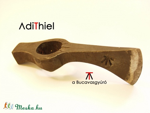

E.g. some of the fokos-type battle axes (No. 1, 4 and 5 in the pic posted by Steve) have existed until very recently in Hungary and are described now as “kun fokos”, i.e. “Cuman fokos”:
http://www.meska.hu/img/product/normal/a/d/adithiel_product_131492_140827161100_1.jpg
Similar weapons were/are ascribed to Avar, Bulgar, Hungarian, Alan, Cuman etc. groups in the region (Southern Russia, contemporary Ukraine, Hungary).
As far as I know the Mongols these were not typical Mongol weapons, but have been used by people conquered by the Mongols. One question is, were they still typical after the Mongol conquest or not?

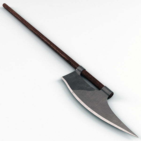

Kronckew’s axe resembles the much larger voulge, a medieval pole arm:
https://en.wikipedia.org/wiki/Voulge
https://sep.yimg.com/ca/I/yhst-138463016558931_2413_539211144.gif
http://previewcf.turbosquid.com/Pre...0655fdba-3c80-41af-9eba-d58d8c83a60cLarge.jpg
Unlike the voulge though, it has a single socket.
It also resembles the pole arm in a Geneva collection described as ‘German battle-axe of the fifteenth century’ (No. 53 on the picture below):
http://members.iinet.net.au/~rmine/temp/halberds/Polearms-Geneva.jpg
It appears that whoever made that fantasy axe (I still suspect a Pakistani or Indian maker) just scaled down and modified/re-interpreted the medieval pole arms to create a modern “medieval battle axe” for the Renaissance fare & mall ninja crowd.

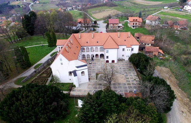

Here are some axes supposedly from a museum in Croatia:
The listing for the axe on the right (#312) looks like it's referring to the 16th century.
The book is said to show "the collection of arms and armour in the Museum of Gornja Stubica, Croatia."
"It takes only an hour to get from busy Zagreb to the green and peaceful villages of Zagorje. We go to Gornja Stubica where we visit the Peasants’ Revolt Museum situated in a baroque castle that used to belong to the family Oršić. The museum displays the life of the peasants and aristocracy in the times of feudalism, from the 15th until the mid-19th century, and tells us about the 16th century peasants’ revolts and their legendary leader Matije Gubec."
from http://aurarustica-travel.com/excursions/zagorje-gornja-stubica-marija-bistrica/
