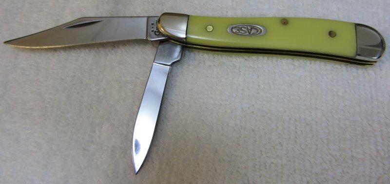

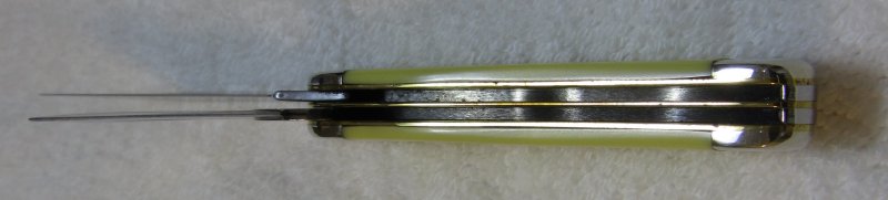

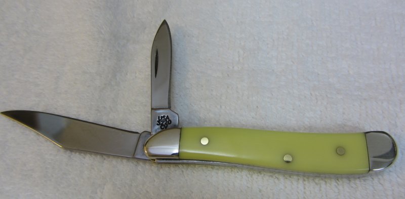

Thanks for the advice. I did as recommended (working the pivot repeatedly in hot soapy water), and a lot more grime came loose. I dried it with a hair dryer on just the blower setting (no heat) and then sprayed a little WD-40 into the pivot to make sure all the water was out. I let it sit a little, wiped off the excess WD-40, and then put a drop of 3-in-1 in the pivot.
There's still a few minor trace corrosion spots on the liner and a couple of hair outlines of spots left on the pen blade. There's some slight pitting on the clip point blade where some of the more prominent rust spots were, but you'd have to look closely to see them.
I could tinker with it more to clean it up further, but I'm content where it is now. It's got a good snap at 90 degrees and fully open, and after a minor touch-up, the blade is really sharp (especially the tip of the clip point, probably due to how thin it is). It's a nice little knife and only cost me $10. As an added bonus, it kept me entertained for a little bit while cleaning, and I got to learn a good way to clean gummed-up pivots.
The "after" pics (forgot to take "before" ones):
Very nice! Glad it worked out well. That Peanut looks in great shape, especially for $10. It's interesting to me, what you mentioned about the tip of the clip blade being extremely sharp. I have two older Peanuts (1970 in stag, and a 1940-1964 vintage in yellow, like yours). I've also noticed the tips on their clip blades, for the same reason.
