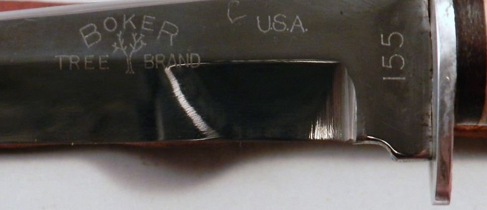

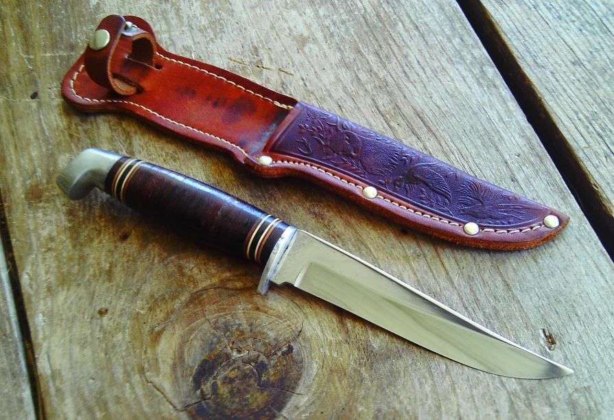

Just got this Boker 155 Bird and Trout with orig sheath. I'm guessing 70's but can anyone date it from the tang stamp.

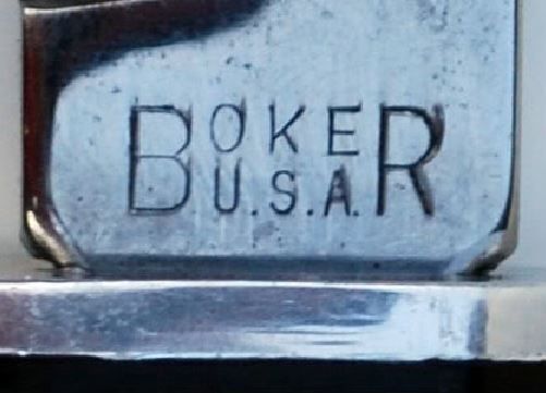

Tang stamp:
This pattern was the inspiration for the Curtis LeMay driven USAF SAC Pilot's Survival Knife. They were evaluated for issue in the early 50's.

Thanks for the vote of confidence Mark, Boker is one of the toughest brands of knives to accurately date, there is no rock solid etched in stone book of tang stamps and markings there are over 40+ different tang stamps and any dating information available is compressed into around 27 of the most significant stamps used, and then one has to take into consideration all the different branches of Boker and then with Boker USA it changed hands many times that tang stamps for the USA brands are not accurate and the shield is a better way to date, also Boker reintroduces old tang stamps for nostalgia ( or to confuse:-). So with Boker sometimes you need to figure out what you don't have to help you get closer to what you do have. So this particular knife, is a civilian model not military, can tell this by the sheath and the lack of lanyard hole. What I'm really baffled at is the knife is not stamped? There should be at the base of the blade a Boker stamp on the left side, and 155 stamped on the right side, to me from the pictures it looks like someone used a engraving pen, you can really see it in the USA and also a sort of slip of the pen to the left of the U? I know the military ones are collectable, the sheath and lack of lanyard seem correct for the civilian market but the markings seem odd to me? Not really sure if someone tried to pull one over on someone or maybe a employee took the materials and made the knife at home? I really have no idea the knife looks right but the odd engraving and lack of stamps seems to be questionable? I thought maybe someone worked a Boker plus model but the Boker Plus reissue models have a lanyard hole. I guess it could be some sort of commemorative type knife they had engraved for display or as a reward? They did a good job on the logo put that USA seems a bit shaky. I think this might be a employee lunchbox knife? I'm sure it's 100% Boker, I think an employee did a bit of slight of hand and then did some garage engraving.Sorry I really couldn't help, you can try contacting Boker I'm not sure who's over there now, sadly Terry Trahan passed away not to long ago.
Pete
Thanks Pete! I figured it was the 155 Bird and Trout (not the issue one) but the stamp puzzled me too....

I think it's factory mark and here's why (this occurred to me late late last night) the electro pen stamp, in one aspect, matches the military examples 50's era tang. Notice the larger "B" and "R" on each end of "BOKER".
Issue Tang
Mine

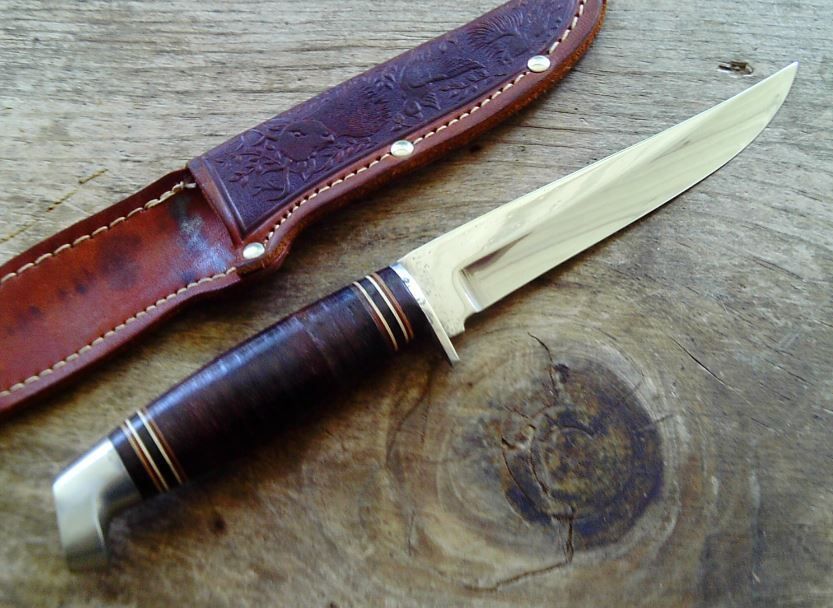

Here, a collector shows both military era versions (civilian and issue) of the 155. The civilian model has a sheath like mine, no drilled pommel but the wider military style fingerguard. More puzzle pieces....suggests that mine is either pre or post military issue era.
http://iknifecollector.com/group/knifepatterns/forum/topics/bird-trout-knives
This poster has one similar to mine but with a standard stamp and pakkawood handle...

Another view of mine:
The knife appears pretty much unused with the factory edge. Leather-wise, it matches the old 60's-70's Schrade hunters we used to have before the fire.

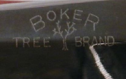

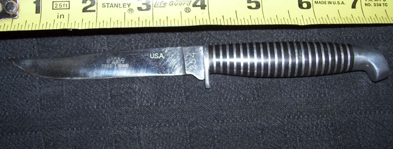

Here's another knife on the Bay with that style etch....so I guess it's a factory stamp.
Seller's pic
and a blurry Boker 153 (next size down from the 155) with the same etch..
I don't think it's a stamp they aren't uniform to each other, look at the B in Brand on the sellers picture above, it looks just like the engraving pen was dragged from the tree bottom to the B, I wonder if these were pre production salesman models? I don't know enough about their fixed blade line, I've had good luck when Terry ran things in customer service, a email was usually answered within a hour, you should contact them, sort of odd to have some poor guy sitting there trying to mark knives, did a better job than what I've done marking my tools :-)

Well, Boker emailed me back and said my email was shown to the president of the company (who has been there over 30 years) and he said Boker never marked their blades that way. Since I thought the knife was 35-40 years old, that info confirmed it is as least 30+ years old. I thanked them and attached pix of 3 Boker USA knives off ebay auctions which all had the same exact etch so we will see if that jogs someone's memory at Boker.
I already posted 2 of the examples, here's the third I had found in about 30 min of searching Ebay past auctions.
Anybody know the production dates of the Boker USA knives?

Different sellers. I'll look back at the ebay searches but there are other examples of Boker knives from 50's and 60's with no tang stamp. Just found this one....different style etch, but applied to the blade and not the tang. Looks like an improved (no electro pen) technique over the older ones. Are all real Boker USA knives supposed to be tang stamped?

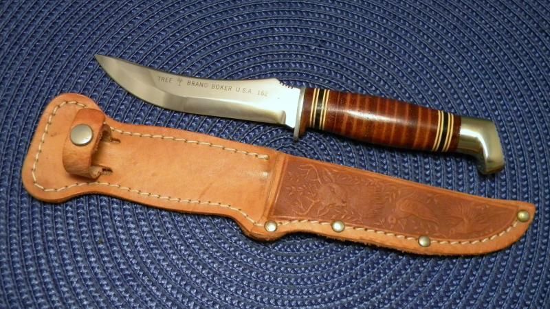

Seller's pic of a circa 50's-60's Boker USA 162
It has the same sheath design as my 155, so is this an employee take home or evidence of a improved blade marked (vs tang stamp) Boker USA? I'm stumped. :confused:
The etch on yours and the ones you found on eBay are really crude, I have Bokers from early 1900's and they are deep professional stamps, and up until a few years ago on their traditional pocket knives each blade on multi blades knives were stamped

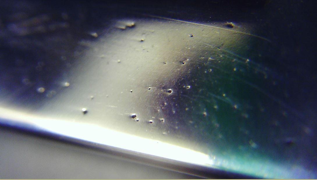

Your suggestion of pre production salesman samples interests me as well. My knife has tiny tiny surface pin holes on the back side yet the finish is absolutely mirror perfect on the etch side. These are imperfections that weren't polished out so if...and I said if, this was a salesman's sample, it would make sense to spend more time on the etch side that would be examined closer than the back. :confused:
Here's a close up of the tiny imperfections: (my camera is very limited on close ups)
These imperfections run the entire length of the unground portions of the back blade. I've looked at the front (etch) side with an 8X magnifier and there are no imperfections like this. Makes me think the back side is "partially finished".
What do you think Pete?
