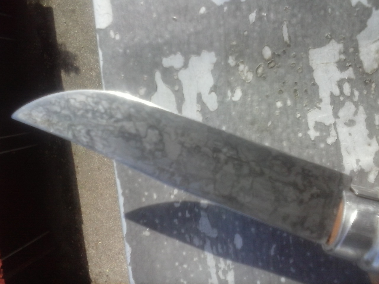

Fish, try forcing a patina on carbon steel and see if it's that... I put a patterned forced patina on my Opinel using horseraddish for pattern and ketchup for uniform coating after that... It's a coat of passive oxide (Fe3O4) that prevents active rust (Fe2O3) taking place. I think browning and bluing are similar proceses that also promote coat of passive oxide to prevent rusting. You can force a patina with almost any foodstuff containing acids*- but I think the best way would be warm vinegar, ketchup, &c.
* actually, different foods produce different coloured patinas- bluish, yellow, purple... But yours is probably a greyish coat, as on my Opinel. And I accidentaly left my carbon blade with forced patina a few days in the rain (it fell out of my pocket), and it did not rust beyond a few superficial spots that were almost wiped off with a kitchen sponge.
