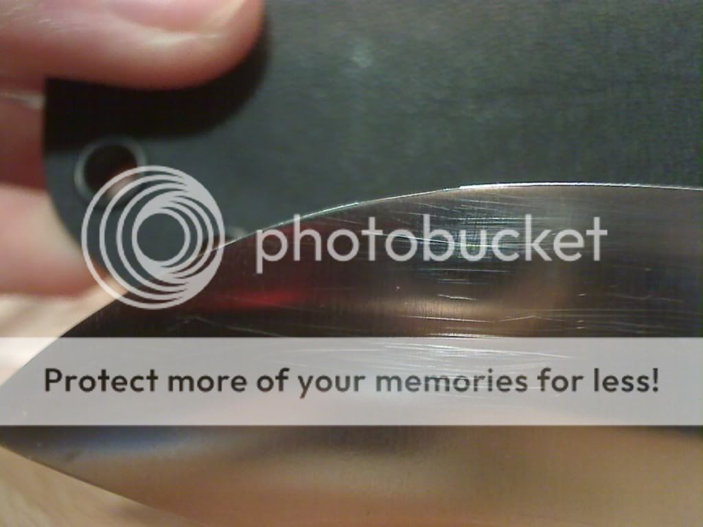

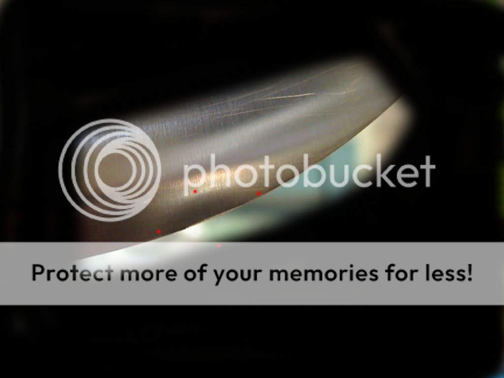

So I've been using my bravo 1 around the house doing stuff, and I was cutting an apple in half, and i pushed down on the knife and the apple had a bit of resistance, so I pushed a bit harder, it cut through, and because the board I was using was a thin plastic one, it hit the granite like bench underneath, which is very hard, and it rolled the edge of my bravo 1.

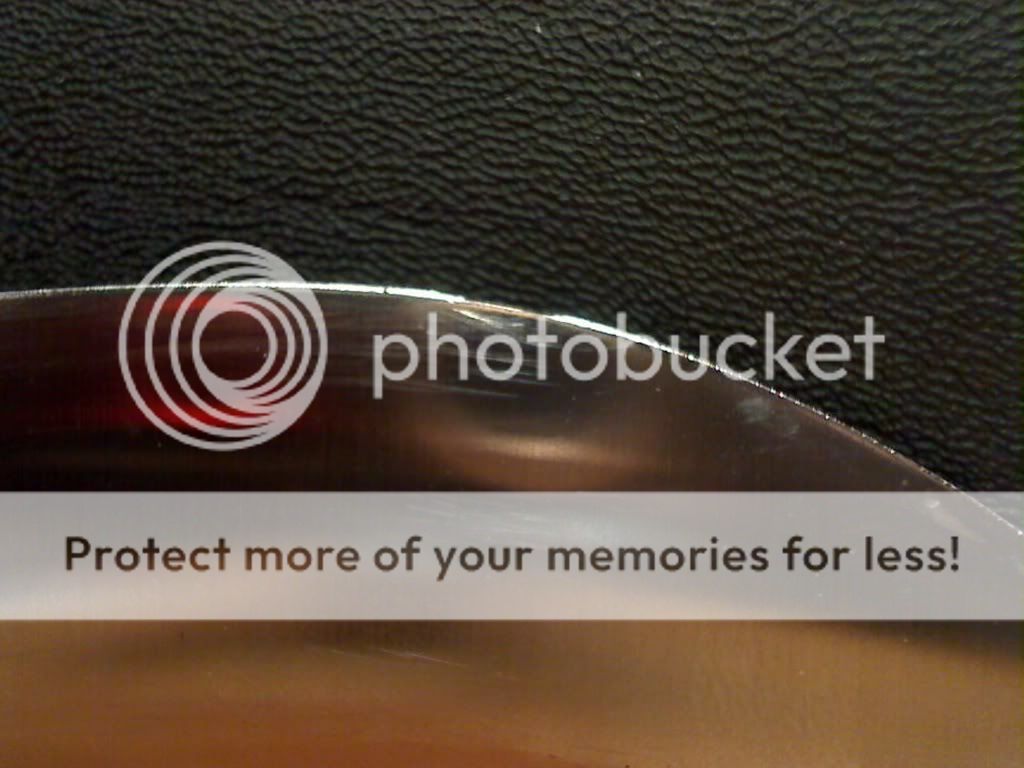

here are some pics to show you. They are not the best as I only have a webcam.
I added the black around the last one as I think it helps to see the edge, as its a bad photo with bad lighting.
I can see it without a camera on it, and feel it as well.
I have no idea how to unroll my edge. Is this permanent damage? I guess its better than a chip in the edge.

ok so I shuold be doing one side at a time not alternating. I did it the other way, it de rolled the edge, so it is sharp again, but it still catches at some points, like gliding it through a piece of paper, the edges of the cut will be clean, but then a bit ragged when it catches, will still slice, its just maybe "toothy".
Is this to do with my hand not holding a consistent angle.

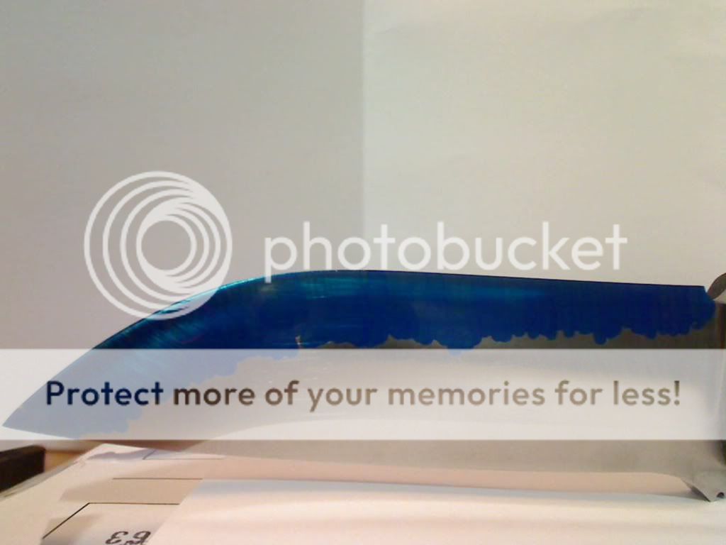

If there is no underlying scratches and all you see is the scratches you are making and the edge is feeling sharp then you can probably move up a grit.

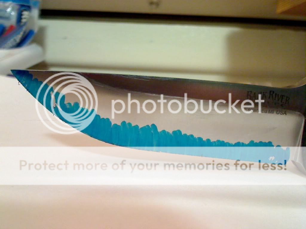

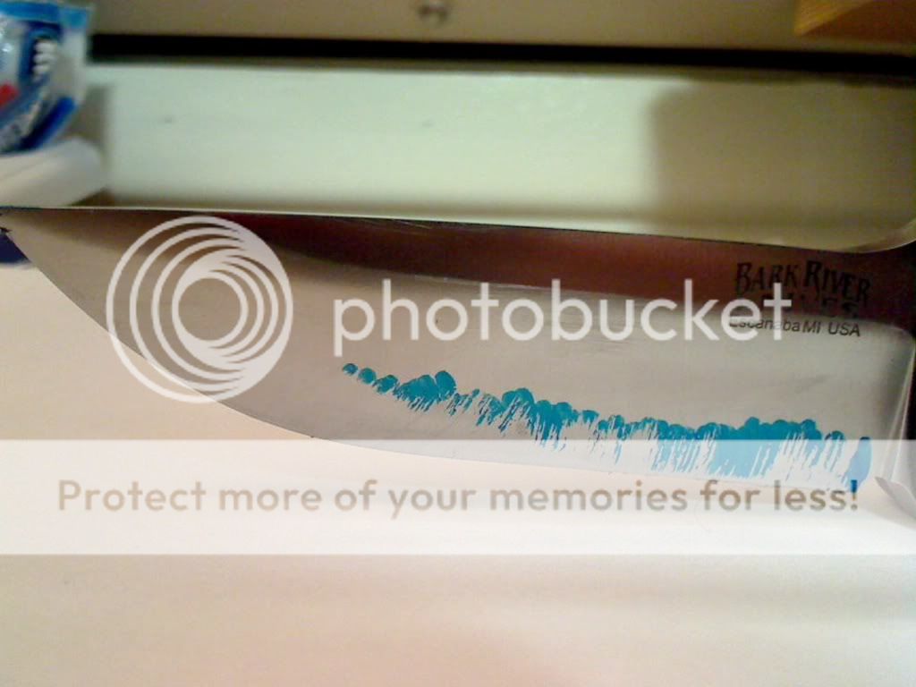

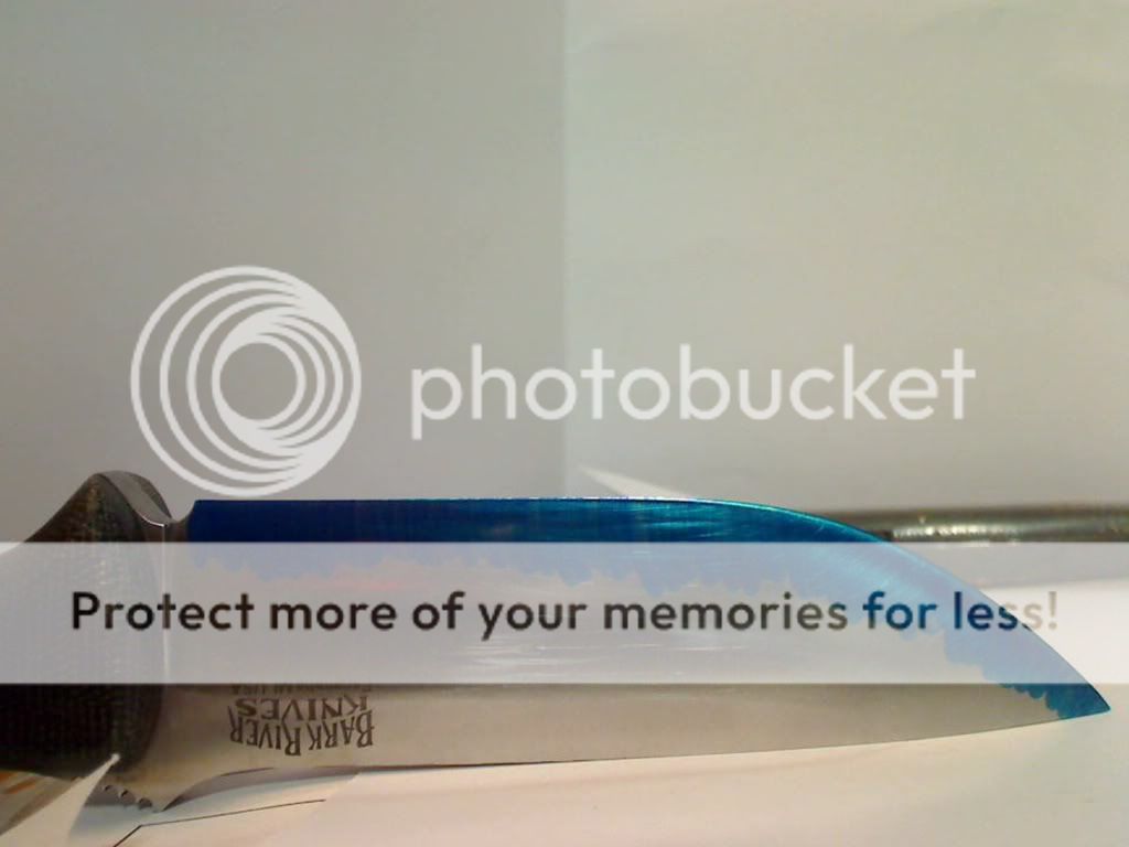

Here are some pics
I used a blue whiteboard marker on each side, about 1cm thick.
Here is the anlge I am trying to hold. Is this too low or to high
Is this a better angle

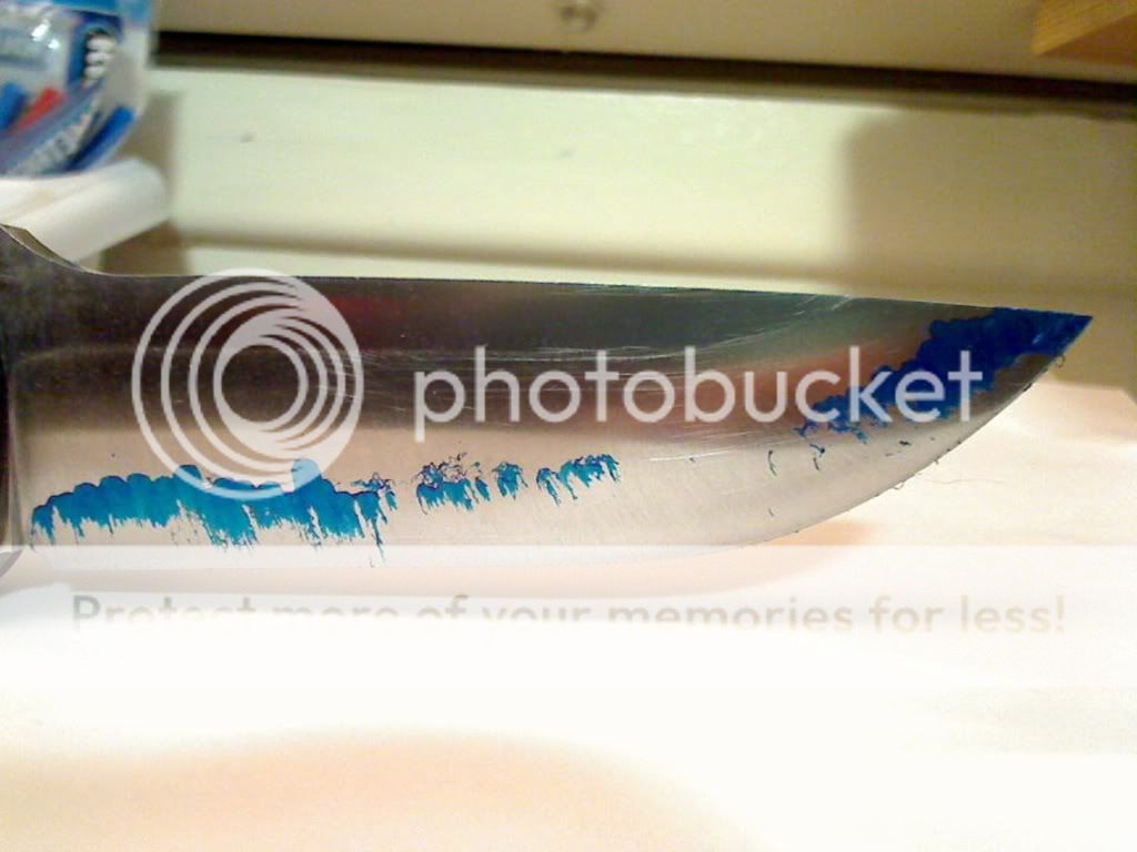

before and after doing the logo side
after doing the non logo side
Unfortunately I am at work and my phone won't allow me to see all the pics. The first angle hold pic looks good, I be able to tell more when I can see the rest oof the pics though.
Pressure will be the next most important aspect, you need to be pressing hard enough to create the shape. Usually about 2 to 3x the weight of the knife.

Also, JCK, the angle you're sharpening at may be a little too steep. I'm not sure though, I don't have much experience with convex sharpening. Don't listen to me! ;)

You can probably use both angles, the lower one to flow the main bevel into the edge and the higher one to continue the flow but make the edge stronger. Kinda like a microbevel that you don't know is there.
From the pics of the removed marker it seems that your pressure and consistent hold angle are a little off. When you press the knife onto the sandpaper you need to use a twisting force to force the edge into the surface of the paper. As you drag the knife down the paper you lift the handle as you get to the belly and the twisting force will keep the angle correct along the length of the blade. I describe it here a little better.
Thanks for the link to you post. I'll reread it tomorrow mornning wehn I continue practicing sharpening my convex edge. Should I try and get maybe some higher grit sandpaper? or the 2000 should be fine?
But it did make the part about twisting the knife like you were saying more understandable
