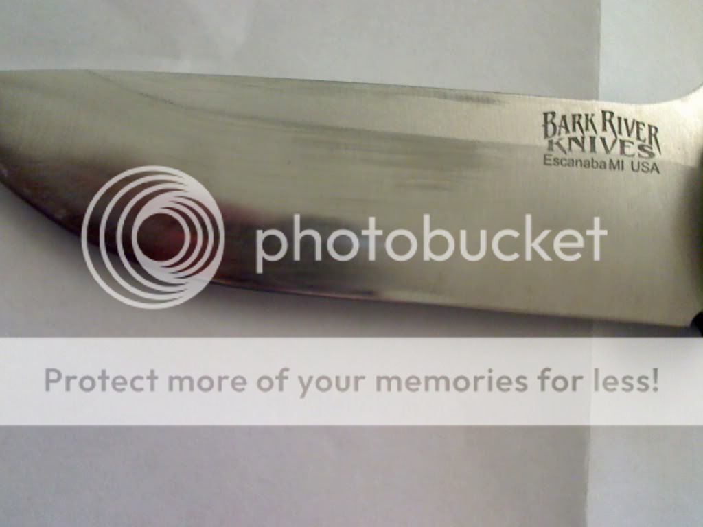

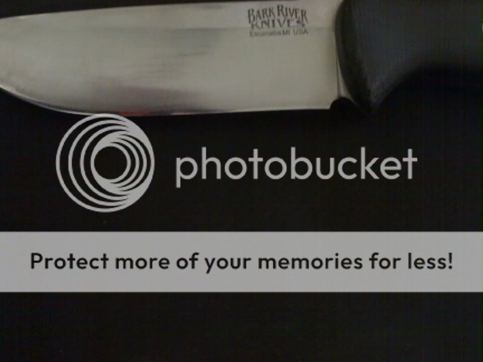

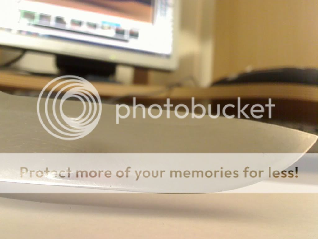

I think I might have another problem/been doing something wrong.
here are some closeups of the side of the blade, near the edge, its got like a spot where it is quite polished and well that should be along the entire length of the blade shouldn't it? not just that one spot?
does this image basically mean I have been sharpening/removing metal/polishing the wrong spot, thus why it is shiny there and not shiny anywehre else.
I think that that shiny spot is the mirror finish you are referring to?
non logo side
Smaller spot on the logo side, at the same place where the large spot is on the non logo side
You you using a mouse pad backing?
It looks like you did not use the lower grits enough/progressed too fast, and your contact points are way off.

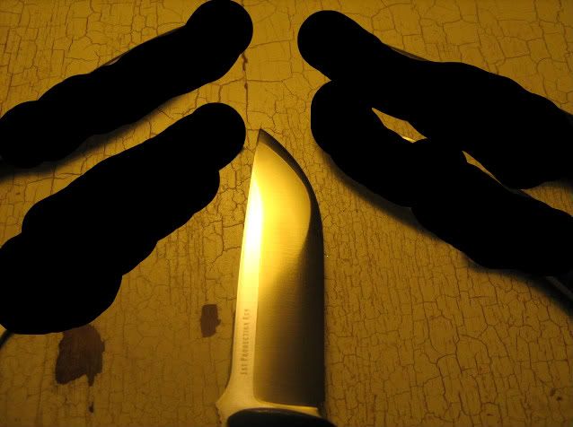

Don't know if it will help but here are some knives that were converted from V bevel to convex.
Some BRKT's
Wish I had a better pic but this is the only one I have of a bravo1

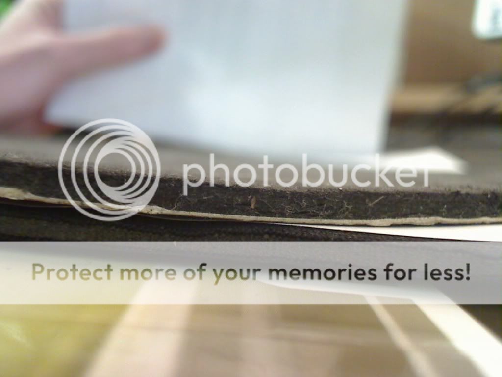

I couldn't find a mousepad as the only one I had was a round one.
So I used the stuff from a pencil case, I guess its not solid enough/or it has too much give? And is probably where all my troubles are coming from? :foot:
here is a pic of my mousepad, is it too small to make it into a rectangle. I'd rather not cut it up, is there maybe something else that could do? I'll try find a proper mousepad though
Stuff I was using on left round mousepad on right
Comparison between the two, the top is the mousepad. When I press down on it it feels firmer, and a bit more "rubbery", when I press down on the pencil case stuff, it feels a bit more spongy, and has more give, and efels less "rubbery"
so a proper mousepad, that is also larger

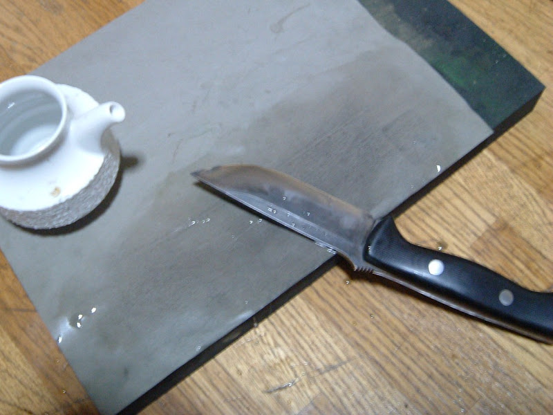

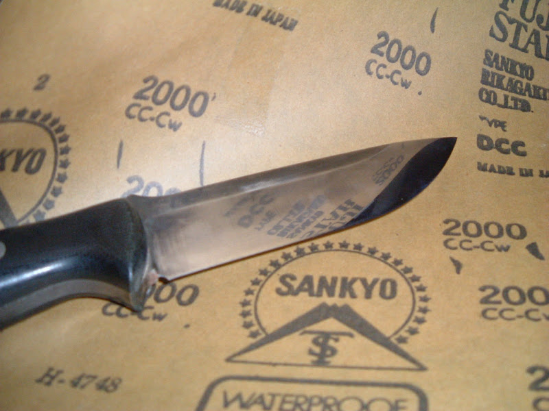

I've ever rolled and rolled my H-1 knife
and tried to grind off rolled part of blade with #100 sandpaper
on Coleman's urethane camping mat.
I couldn't remove rolls at all but it filed well.

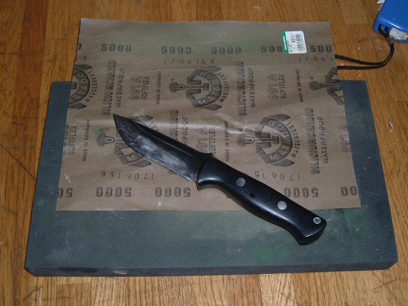

Now I use EVA board to sharpen with sandpaper.

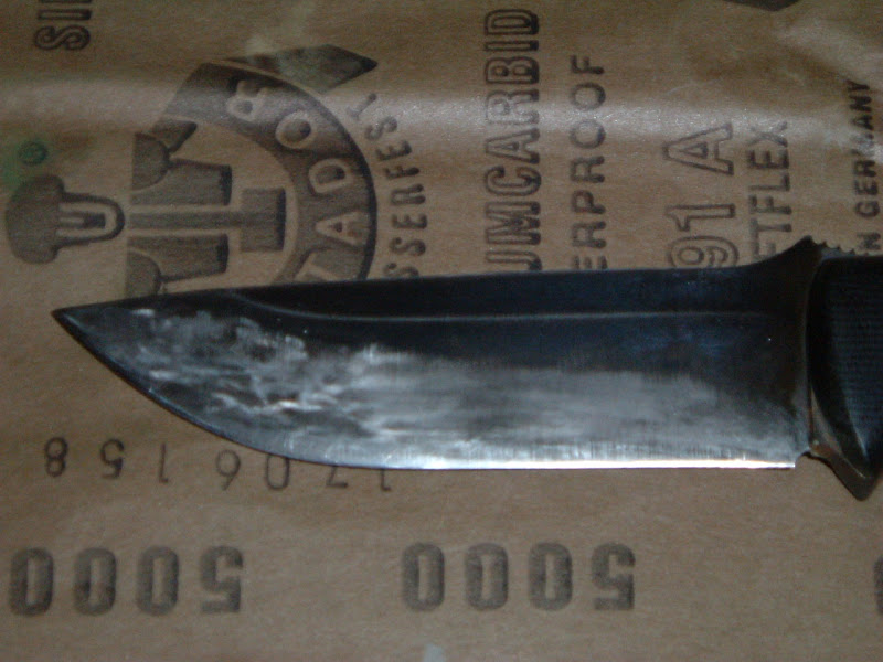

What I did first at arrival my Bravo-1 was to burnish its blade
from #2000 to #5000 sandpaper before stropping leather
and then to force patina with Birchwood Superblue.
I'm not good at sharpening with stones
But Bravo-1 reacts well to natural hard waterstone.

If I was in your case without any machines and supports
I’ll set #100 to this or take diamond file to reduce amount of roll
and will turn daily process of sharpening.

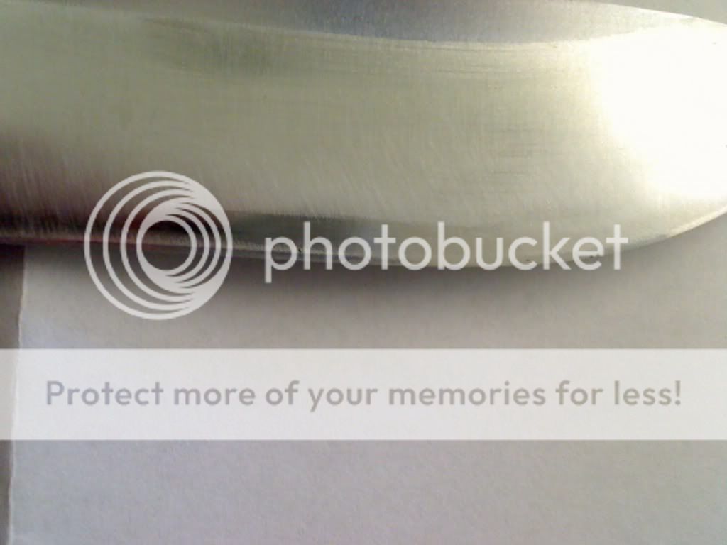

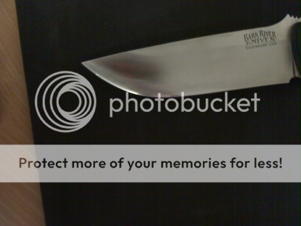

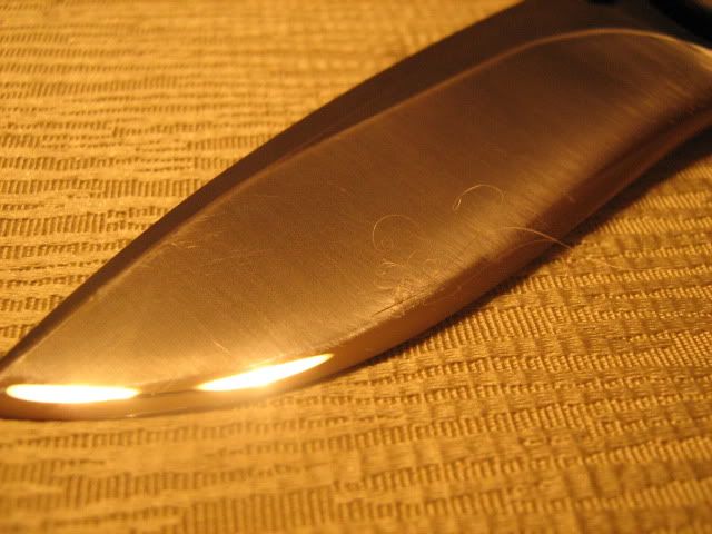

So I found a proper mousepad, and I managed to fix my edge up and get it really sharp, however I just a couple of last questions.
My edge towards the handle is not as wide as the rest of the edge. Its only a small difference, but just wondering is this a bad thing, as I think this means something is wrong with my technique.
here are some pics
http://lh5.ggpht.com/_KfISOT21EPw/TAov9uz4jwI/AAAAAAAALiY/bNK3nPNws4I/s800/DSCF0341.JPG
Is this normal or should my whole edge be wider, like in the pics you posted?
lastly, as you might be able to see is has a fair few scratches on the blade, is there anyway to remove those scratches , like the edge of the blade is shiny and polished, can i make the whole blade at least partially shiny? I don't have much of a problem with scratches, I just wished I had put them there through use, rather than sharpening?
First: width difference among part of the edge
Sorry I cannot estimate from pics exactly
Only I can try to imagine if I fail...
  1. Rolled part of the edge will make a different shape of filings
    if you keep same angle around whole part of the edge.
  2. Total amount of filing tend to be lower nearby handle of the edge.
    or pressing down spot (where mousepad sinks) is mainly front part of the edge.
  3. Different angle of the edge between point-curved line and rest straight line.
  4. Aimed to fix rolled part of the edge at first, so took more files there.
but bevel line looked like twisted ribbon
when I leaned my PC display.
If you try to hold knife and move EMS block like DMT aligner
you might keep angle of blades well at emergency.
Third: Erase scratch / Shiny finish
I think if you hope "mirror" finish it is difficult for me
because it needs diamond compound and it is a little expensive.
and I think it is possible to make a "burnished" blade
which reflects light but remains hair line scratches.
But you will need lower numbers of sandpaper to fix roll of your blade,
and burnishing is a one of the result of sharpening.
I burnished my blade at first to help to prevent rust,
rest will be numbers of stropping over years.
So if I list up your processes that would be second:
Almost all of scratches will be removed under processes.
  1. reprofile1(fix)
  2. reprofile2(set up blade on preference)
  3. stropping after use
  4. sandpaper in case
Totally you can wait for arrival of your maintenance tools.
