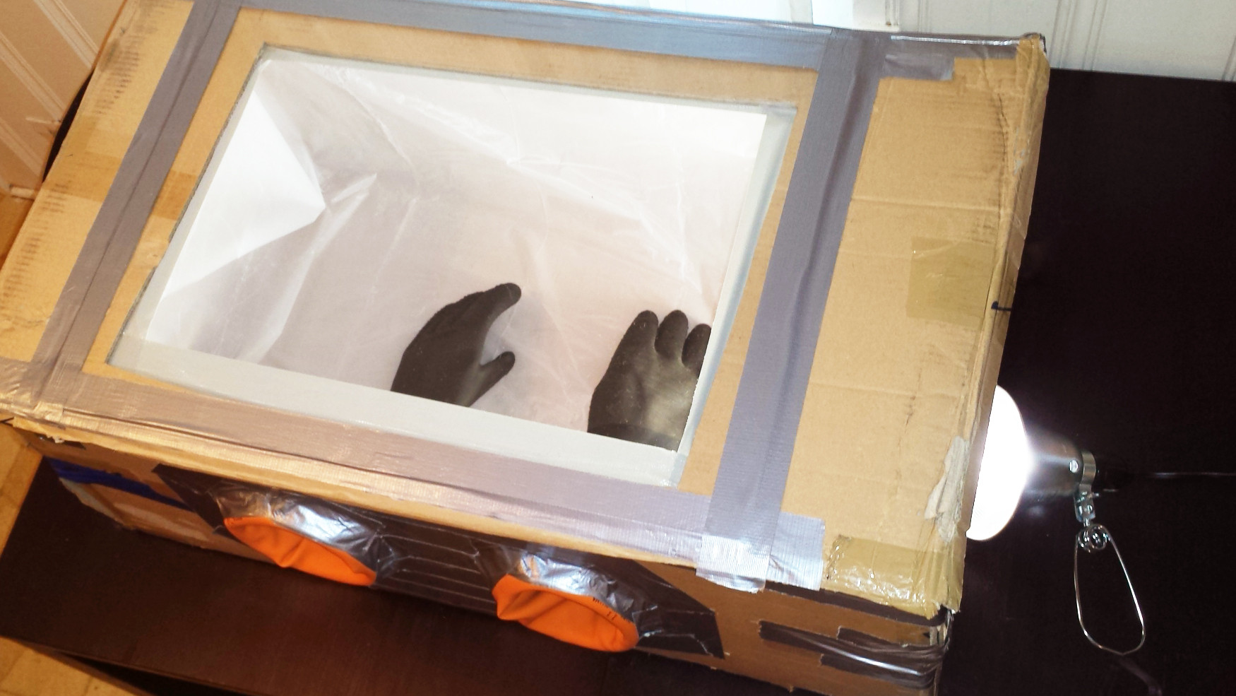

That'd help some of it, although it tends to spray out in a 360 degree arc which makes it problematic to cover all of it. Maybe I need to put it in the equivalent of a sand blaster cage where you've got a glove to reach into a sealed box...

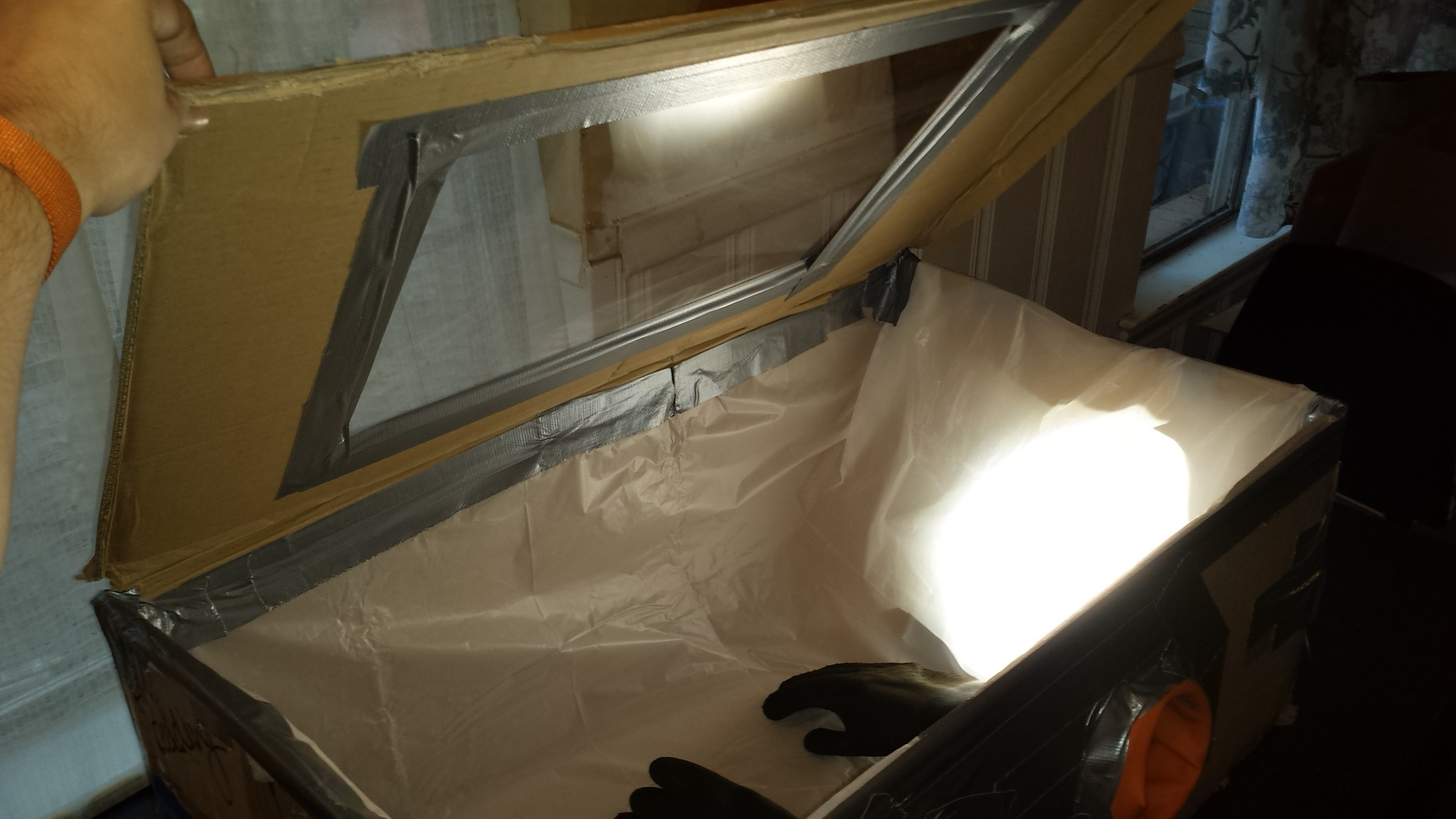

I like the glovebox idea, you could start with a cardboard box and a bit of glass or plexi.

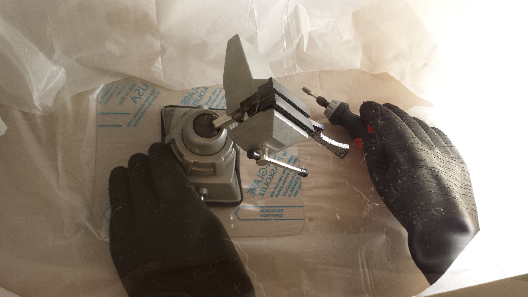

Thanks to everyone to for the advice, I ended up building an inexpensive biosafety style cabinet out of a sturdy cardboard box, some plexi, a roll of plastic drop cloth, and a pair of cheap Harbor Freight blasting gloves. About $15 and it eliminates all those shards!
