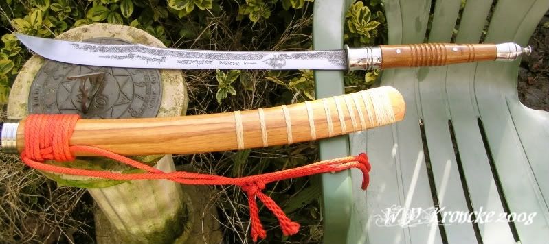

here's the whole dharb for those who have not seen it where i posted it in the 'other place'
(as the saying goes: 'come over to the dark side, we have cookies')
Oh, that's sweet! Just one question, what are you doing with my sword? ;) I'm sure that one should belong to me... :D
Great idea on regrinding and fitting a new tang.
Norm
i'd be inclined to avoid any welding as it would bugger up the heat treatment, i'd grind the last bit of blade down on either side to form a longer & wider than original tang, clean out the handgrip & widen/lengthen the hole for the tang & use your favourite epoxy resin to remount it into a wakizashi. drilling the tang for a set of pins to ensure that the blade isn't going anywhere. like this thai one
that's a sweet idea too :) very pretty sword.
i have to wonder though, i don't think i'd be worried about heat treat at the butt end of the sword? if anything you'd want it a little softer there anyway, so it won't snap again... edge hard, spine soft, handle soft... after welding, it could be annealed yes? mmm. wrap the blade up top with wet rags and keep it cool.
