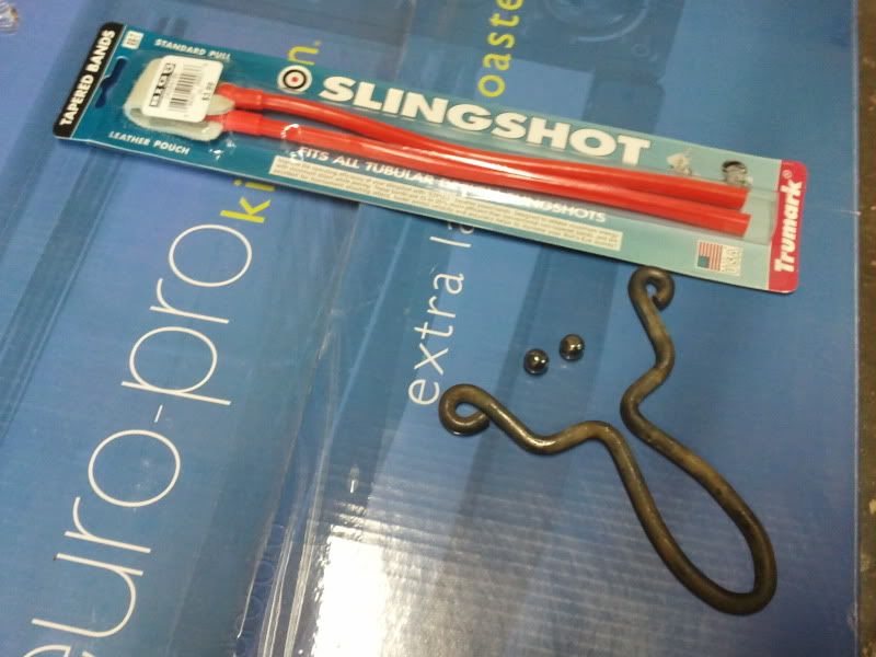

Here's my homemade one
I'm getting hand slap in the recoil cycle of the band. Haven't tried flat bands yet, just haven't justified ordering them or building a tying jig for making them up.

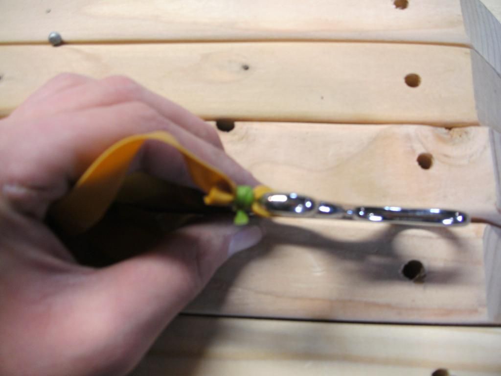

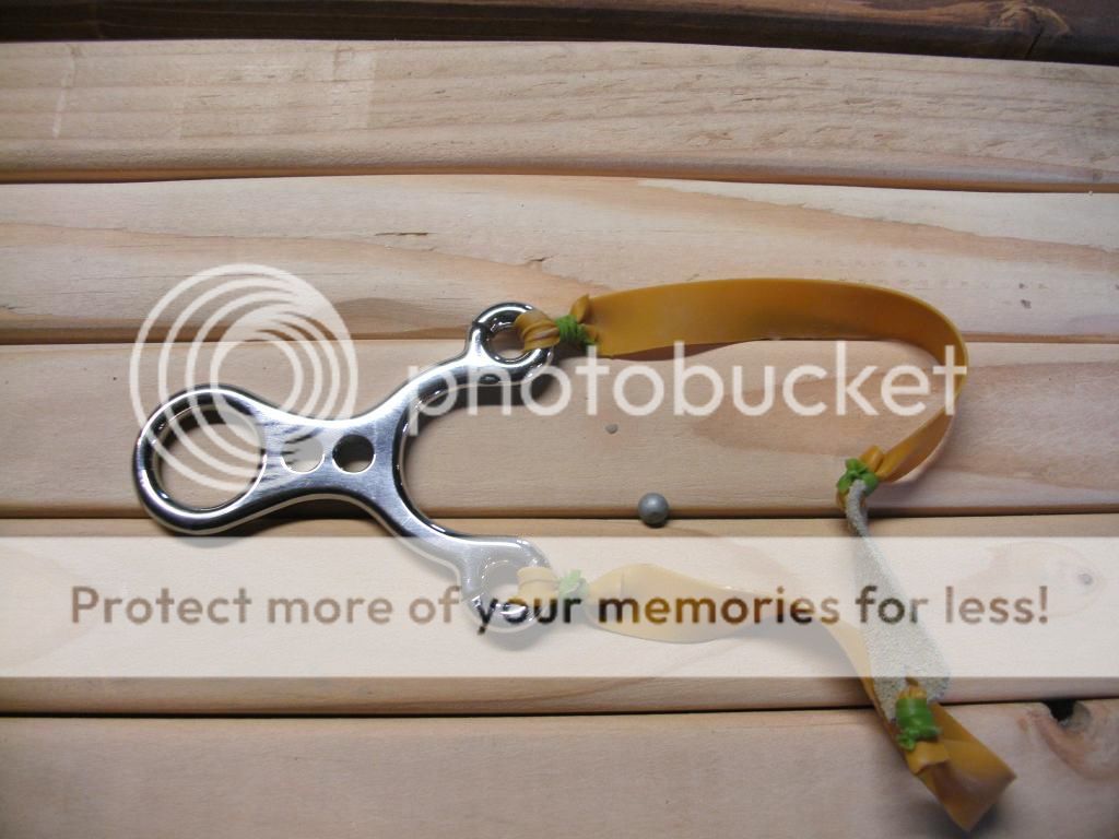

Here is a dankung luck ring I have setup with flats for 1/4" steel.
If you have a walmart, the Gold's gym green exercise bands are decent. May I ask why you dont want to order? Theraband gold is pretty cheap on the bay. I got 5 foot for $7.50 shipped not too long ago.
Because the wife will find out! Lol, I've been spending so much on gun parts lately, she wouldn't like it if another box showed up.
Maybe I will, I have enough old bands still around for salvaging pouches, maybe even use tyvek for some too. And, honestly, don't have a clue what or how I would need to cut them. I don't have a rotary cutter, but do have a mat.
Thanks for the pic, now I know how to tie it.
