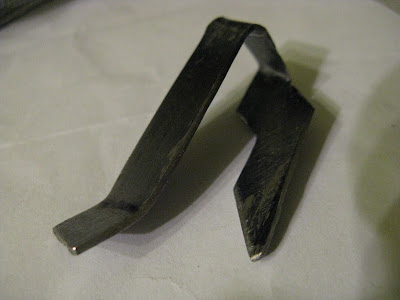

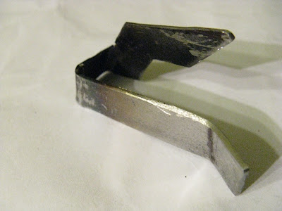

Some picks of the work in progress. Yes, right now it looks like
scrap metal, lol. But I think once I trim it down to shape and
polish it up it will look more like a clip... I hope.
It is a wrap around clip for deep pocket carry for my Kershaw
Skyline.
Thanks goes out very much to P Moore who sent me the materials
to get me started and gave me lots of great advice.
Also thanks to STR and McAhron who pointed me in the right direction
with great advice and articles.
Here's some irony. I took the clip off my Skyline to measure stuff,
and now I kind of like to carry it without the clip. LOL.
Yeah its far and above what my article covered. I'm impressed. Clean it up and mount it. Take some more pics and show it off.

OK, here's that one for the Skyline almost finished. Still want to trim off
some excess here and there and not sure how I want to leave the finish.
Was thinking bout bluing it with the torch but have no idea how to do that
really. Kind of like the finish as is, it is with a dremel sanding drum only.
The idea was a deep pocket carry clip that utilized the stock mounting
positions for the G10 scales. That way you can switch between the deep
clip and the stock clip should you ever change your mind.
The new clip required longer screws which McAhron provided (thanks!). They stick out
a little too far and was wondering the best way to grind them off without
jeopardizing them getting stuck when screwing on or off.
The new clip required longer screws which McAhron provided (thanks!). They stick out a little too far and was wondering the best way to grind them off without jeopardizing them getting stuck when screwing on or off.
Take measurement from the bolt of how much should be cut off, then take it of the knife, put a nut on it with the correct thread of course;) then wrap the area where you want to cut it with some tape, any tape will do, mark on the tape the cut with a marker/pen and cut it, nut behind the cut area. The tape is there to help you not slide a side and hold the saw blade in place until you reach the metal. After cut, fine file the cut and Slowly take off the nut. The last one will straight and correct the cut thread and you’re done.

Thanks for the tip Steinmann. I managed to shorten it with the dremel, and
I will do what you said with a hand file to make it look proper and get the
length exact.
Be careful with the torch, too hot and it won't be spring tempered any more after your done....
I didn't know over heating could do this! I actually heated one of the bends
pretty hot to get it to bend tighter. But I would not have an idea of what
would be considered to much heat. The metal turned bluish/yellow/brown in
a small area. Still seems to be springy though and holds to the pocket well.
When I make the back spring for a folder it's heated, quenched and drawn to a blue color -- that's what I use for "spring temper" If I get it any hotter than blue, then I have to start all over.
