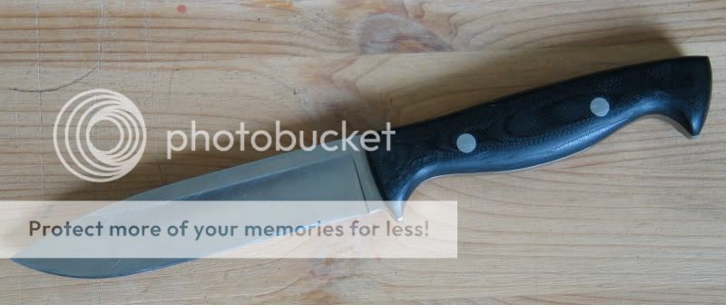

The Koster Bushcraft is my main outdoors blade. Dan's finish on micarta is excellent. It's very grippy, and looks great. Micarta is tough stuff! Mine is in green canvas micarta, and the blade isnt very shiny, so I took care of the visability issue by getting a lanyard with some blaze orange in it (From Josh K, a regular here in W&SS). The 3V is an outstanding steel, extremely tough and not as hard to sharpen as people make out. Get some 2000 grit wet/dry sandpaper and keep the edge in good shape. Now, for a couple pictures.

This knife has what I call a 'grippy' canvas Micarta handle:
