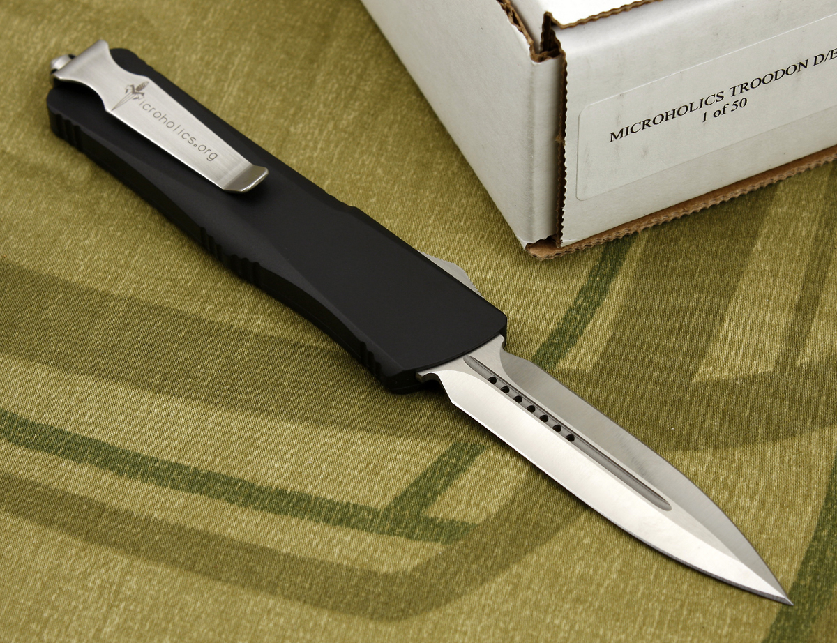

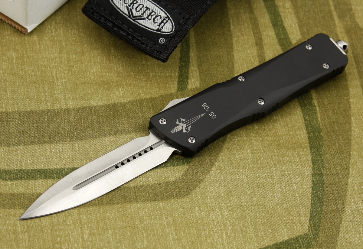

Here's a couple pics I took with the new camera and lens. This is shooting in small jpeg, not RAW.

Thanks, Mike! With your help I figured out auto-focus in live view. It does a surprisingly good job, only losing some sharpness when these three circumstances converge: Picture has a lot of different subjects, I'm shooting from a distance, and auto-focus is set to total averaging. If I'm close in, and centering on the thing I want the sharpest, it nails it every time. I guess I should switch my focus to center spotting as opposed to total averaging, and just center on what I want the sharpest. Thoughts?
And as for my sharpening setting. I think 7 is the highest, and the pictures above were shot on 5. I've bumped it up to 6 for the next round. If it saves me that extra Photoshop step. I'm all for it.
