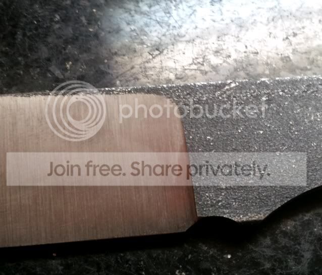

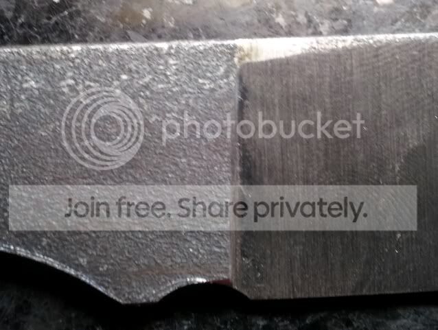

I have noticed that when I am grinding my plunge lines one side of the blade gets a nice returned corner while the other side gets squared off.
held with right hand
held with left hand
is my platen off or do I need to practice more with my left hand?

Fix the platen first off. Mine was like that and I would get the same thing. After fixing the platen it was better but I was still not getting the same radius. That is due to the difference of left to right. I found that with the left, my angle of the blade to the belt was different, in that I would tend to tilt the plunge into the belt more with the left hand. In other words, I would grind more with the left side of the belt while working left handed whereas the blade sat flatter with my right hand. Figure out what's working with the right hand and try to transfer the muscle movements.
But first fix the platen. If the two sides are different, you have no base of reference.
Also, I would suggest cleaning up the flats at least partially, before grinding the bevels. Then, you can tweak the flats to adjust the bevels later.
Until you get your left hand technique down better, try rolling the edge of the belt more to soften it on the LH side. That will give you more rounding.
PRACTICE, PRACTICE!!!
Make sure your tracking is even on both sides of your platen. I know when I am doing plunges, I have to bring the belt over a tad(slightly more than a smidgen). There are much more highly skilled grinders than me but I found that breaking the corners on my platen(evenly) and having a bit of the belt hanging over(maybe 1/16") allows me better control on plunge lines. But that might just be a crutch for lack of grinding prowess.:p
