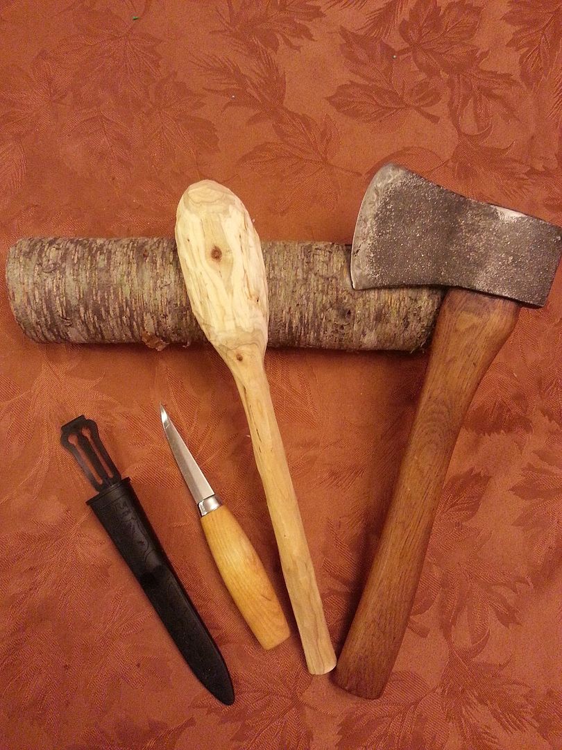

We always called that choke cherry. A friend of mine has carved some really nice wooden spoons, bowls and other utensils from them and says its a good wood for that purpose.
