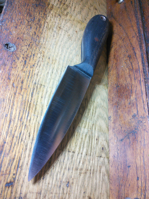

I love knives with wooden handles. So far I've only made one with ebony. It's beautiful and hard, but it's like glass smooth.
I'm not sure I'd want a kitchen knife to feel that way?

I only own one knife with stabilized scales, I bought from a maker here. Idk who did the stabilizing? I don't like the weight, nor the feel. It's texture feels fake. And that knife is maple...... Doesn't need it.
Idk what kind I bought, it was just labeled as Ebony. I got it from a woodworkers store. Not sure how responsible or ethical they really are? Or where it comes from.

My ebony is So dense and glassy. Smooth. I really didn't even sand or finish it up. Barely sanded at all...... Again, I make rougher, user knives. Not fancy show pieces. ....... Yet, this wood looks great. I'm definitely going to be using it more
It’s probably Macassar Ebony or maybe Gaboon Ebony
