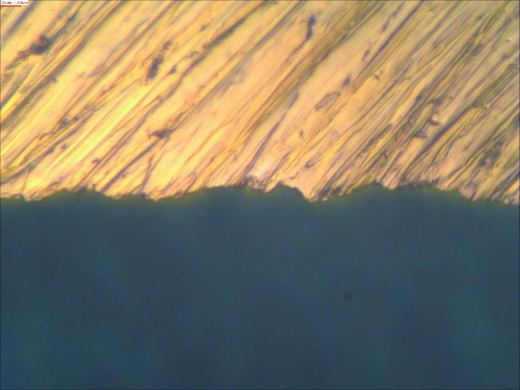

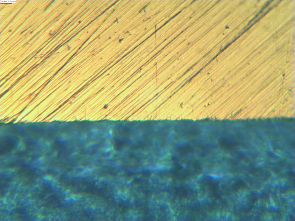

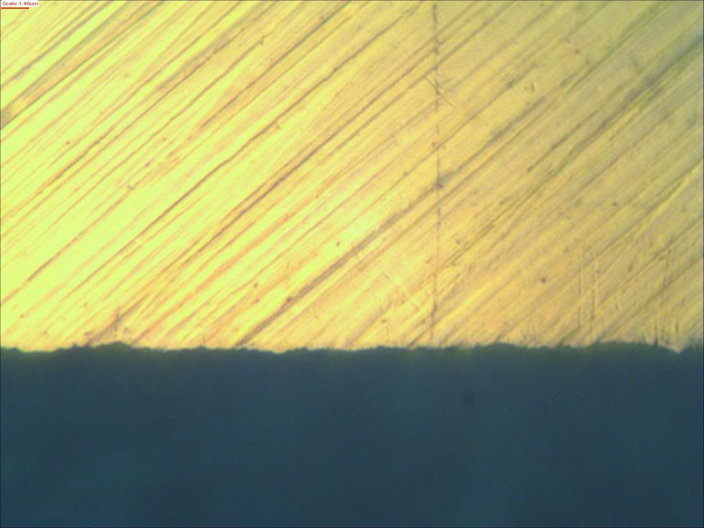

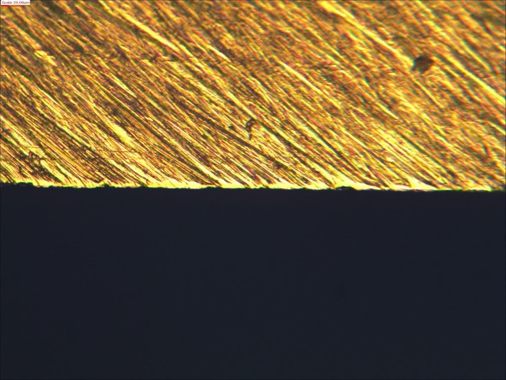

Toothy: Think of a coarser blade that isn't as refined/polished and it has what seems like micro serrations due to the groves that are still in there from the more coarse media that was used to sharpen it. These act like little saw blades and helps it in slicing applications.
Polished: More refined and those micro serrations are far less noticeable so it doesn't grip and want to dig in and act like a saw blade but prefers to be pushed through an object with ease like a very smooth wedge and there are very little serrations to hinder this in this use. So it works better with push cuts.
They can both be sharp, extremely sharp no less. It's a question of what application you are using the knife for which determines which finish would work better but by the nature of it neither is better than the other. Though a lot of us find a happy middle ground we like, with me I personally love the finish off of my norton economy stone the india version on the fine side and think that probably the best all around finish I can get from everything I own and tried thus far.
Essentially, sharpness is about pressure - force/area. We can increase pressure by increasing force or decreasing contact area (sharpening). There are two ways we can decrease the contact area; making the edge narrower (uniformly along the apex) or by producing high points (irregularities). We can also imagine that those high points will wear first, protecting the keen edges in the low points. As an example, a sewing needle easily penetrates skin, but a blade sharpened to the same geometry (in 2D) is too dull.
