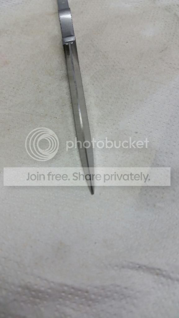

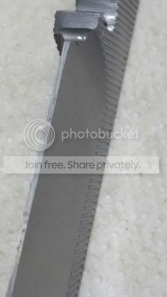

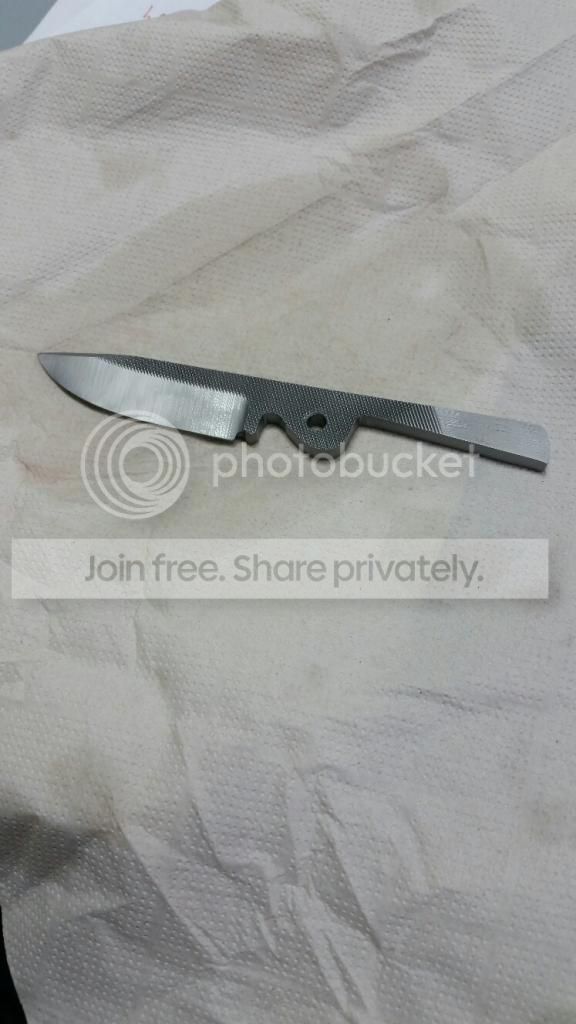

Here’s an example of my wrong handling while shaping my blades; It’s a friction folder blade made from a swiss grobet file. I went down to 1mm thick on the edge. I think that 1mm is still ok to go, but there’s too much steel left on the bevel above the cutting edge, I think, and that is what is giving me trouble when trying to sharpen it.
The blade itself is 6mm thick.
I need to know: My contact wheel is 40mm (!) in diameter, what sanding angel shell I hold the blade in? Is there a way to calculate it? Or do I need to reduce the diameter of the contact wheel?
I would like to make me a wooden rig to hold the blade in that angle while grinding.
Thank you all in advance!
Michael
How did you get it to that point? If you can I'd keep on grinding until the edge is thinner and the shoulders are higher. I take my edges to about 1/4 of mm on folders, sometimes thinner. 1/2 mm would be great.
Nice looking work!
That is some awfully thick steel for such a small knife. If you want a grind like that on a knife that size, you may want to findbsome thinner stock like 1/8" or 3/16". I ddon't know the metric equivelant,sorry. At this point ( thepun intended!) I would make the grind go to the spine or somewhere close. You could also try to zero grind it and that may help? I have had good experiences with zero grinds.

Keep on grinding as you have already been doing. The edge will get thinner and the grind will get higher at the same time.

Daniel & S. Alexander – That’s what I did with the 1st blade I managed to destroy: I kept on grinding until the height of the blade was damaged and the blade was ruined; something with the angle is wrong, I think.

If I understand correctly you are using a grinding jig? You may just have to adjust your work rest angle or your jig angle until you get the right thickness at the edge. Once you have the correct edge thickness, decrease the jig angle to "climb" the grind line higher up towards the spine.
