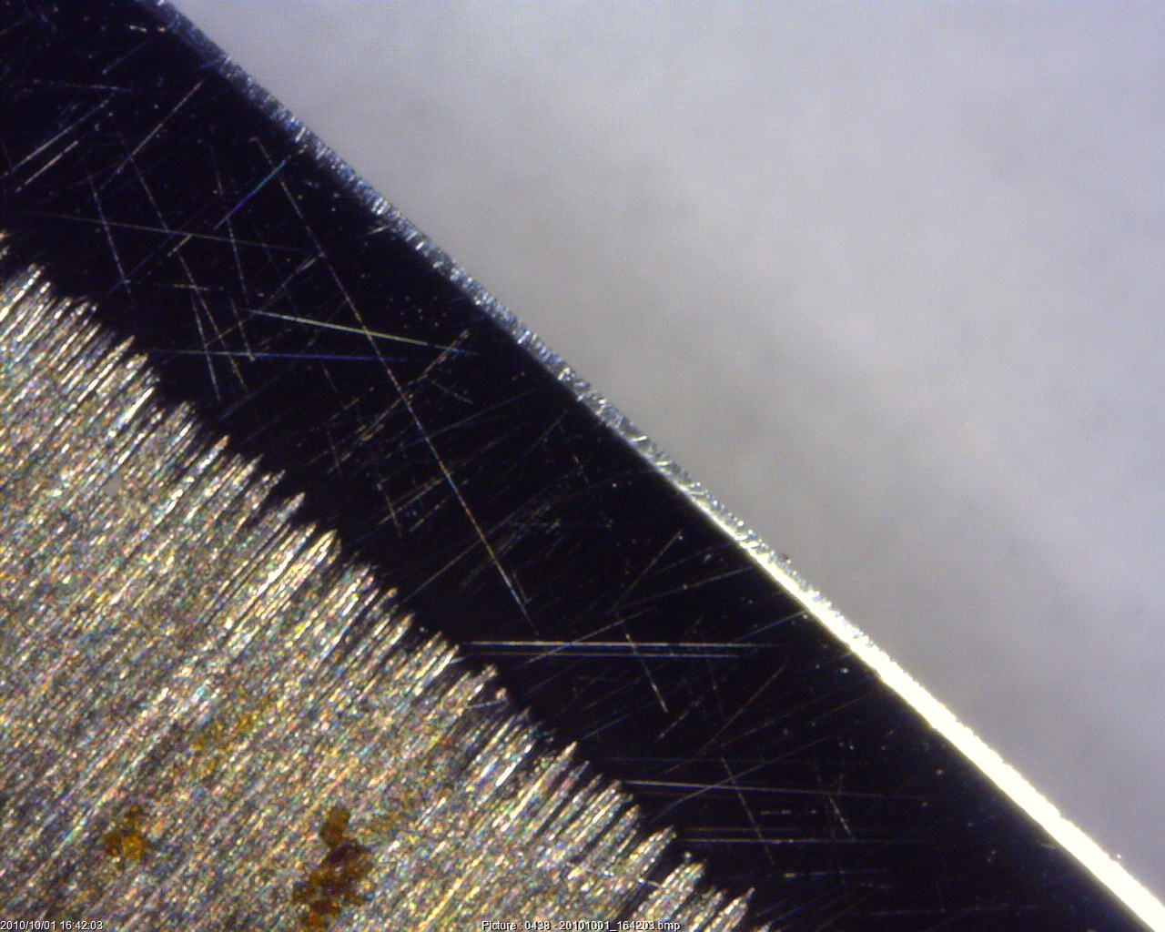

How will I know if I have A micro bevel or not?
Best way to see it, is to use a magnifier under bright light. Should see a thin reflection of light along the length of the edge, on both sides of the blade. If you rotate the blade in either direction, hopefully you'd see a wider reflection coming off the primary bevel, then a narrower one along the very edge itself.
Here's a good picture of a micro bevel below, linked from this site: http://sharpeningtechniques.blogspot.com/2010/10/mirco-bevel.html
The shinier bevel nearer to the edge is the micro bevel, and the darker bevel below it is the primary bevel:

One last thin I know this I confusing but if I were to sharpen it so many times and the blade turned into 20 inclusive wouldnt the blade be really short because you would sharpened the whole 15 degree angle off ? Also how do you get a 20 degree Bevel out of a 15 degree bevel? For this make sense?
Good illustration, thanks. :thumbup:
That's the perfect picture, for illustrating how to get a 20 degree bevel from a 15.
