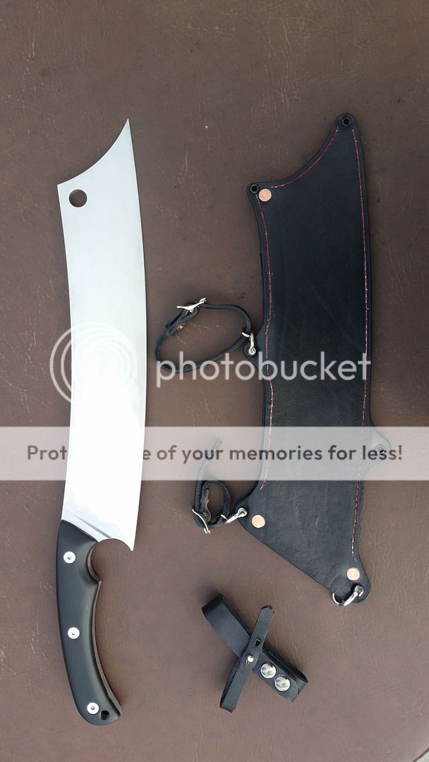

That's essentially what I did with my Ontario Hell's Belle sheath. The welt was one layer of 8/9 and one layer of 2/3 glued together. Just enough to match the spine...
Again just a thought...
Th blade itself is 3/8s thick those 3 layers is just enough to fit the spine, and I haven't tried wet forming anything yet.

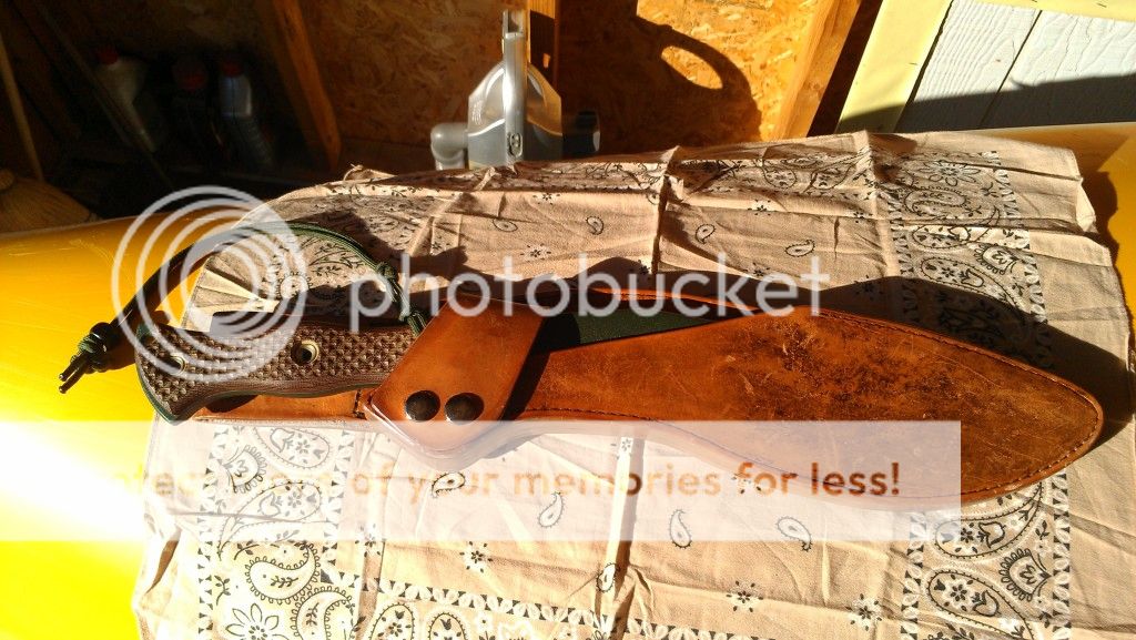

I made one sheath with up to 10 layers of heavy leather (it was the first big open spine sheath. I should really cut it apart and take a few layers out, but I'm lazy.
I like baldric carry for a knife that size.
But often I tuck it in the belt.

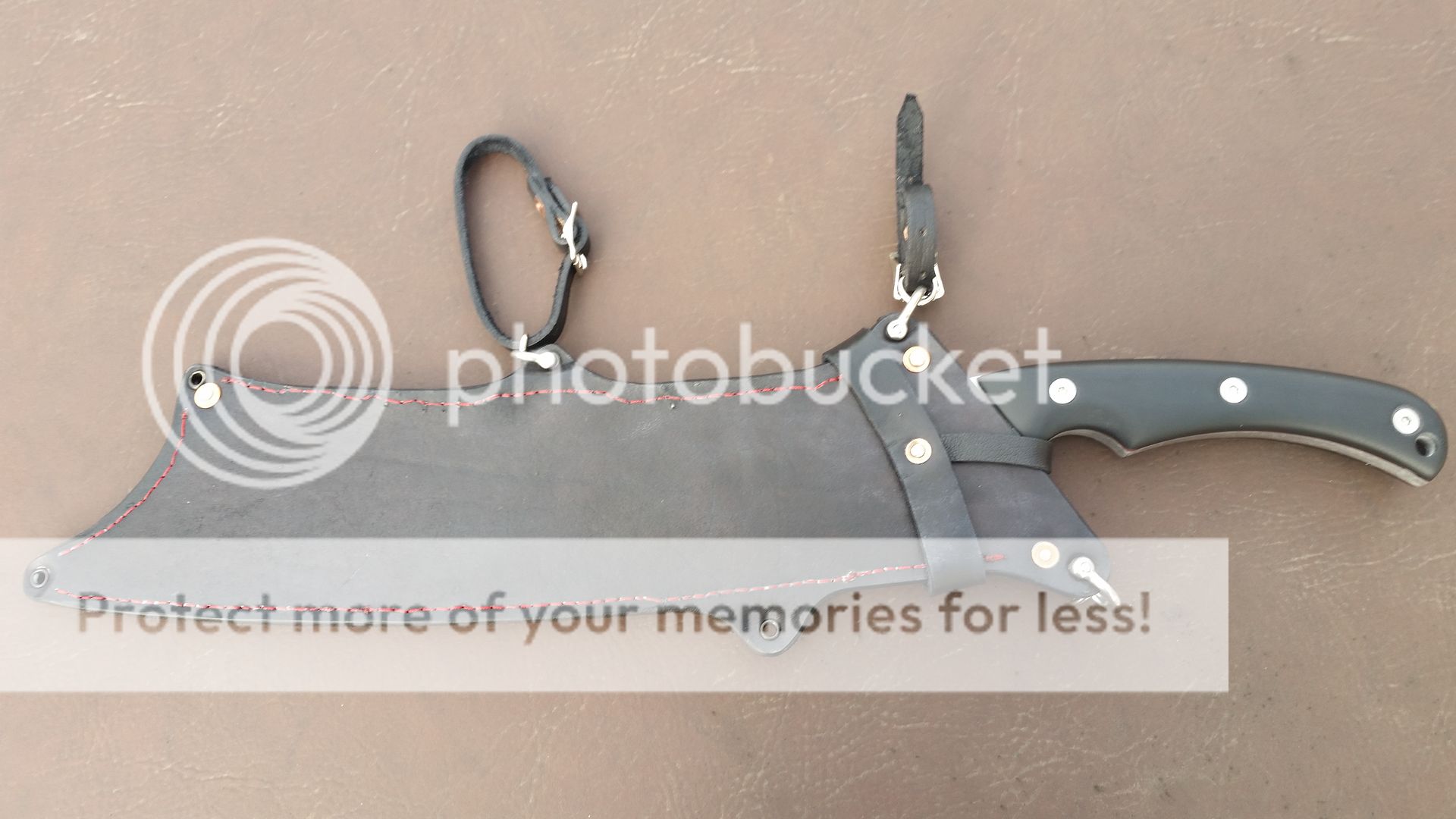

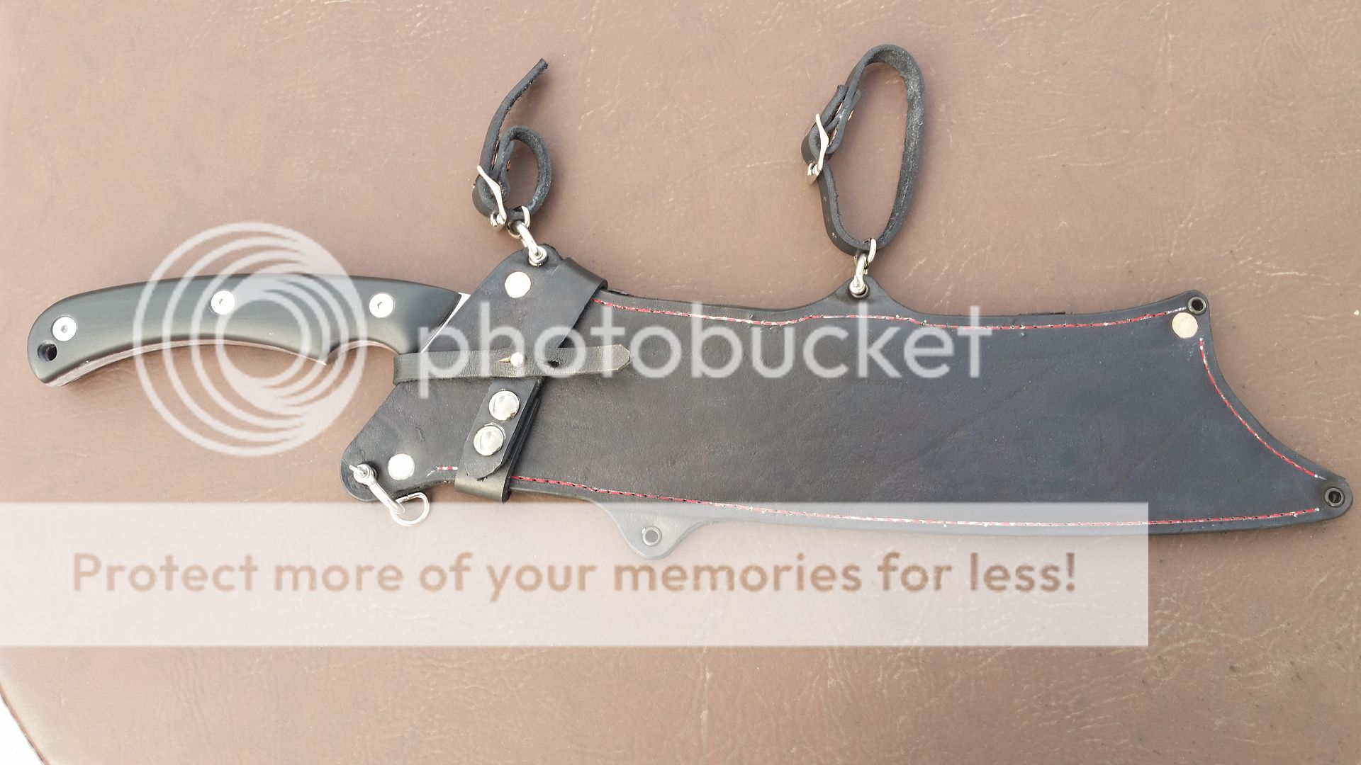

My first attempt (with a beat up old H strap sheath mounted as well).
Paul and other pros on here have helped me over the years with their advice.
Nice work bigfatty, I like the open spine deal looks good. Did ya dye those sheaths or are they horsehide?
