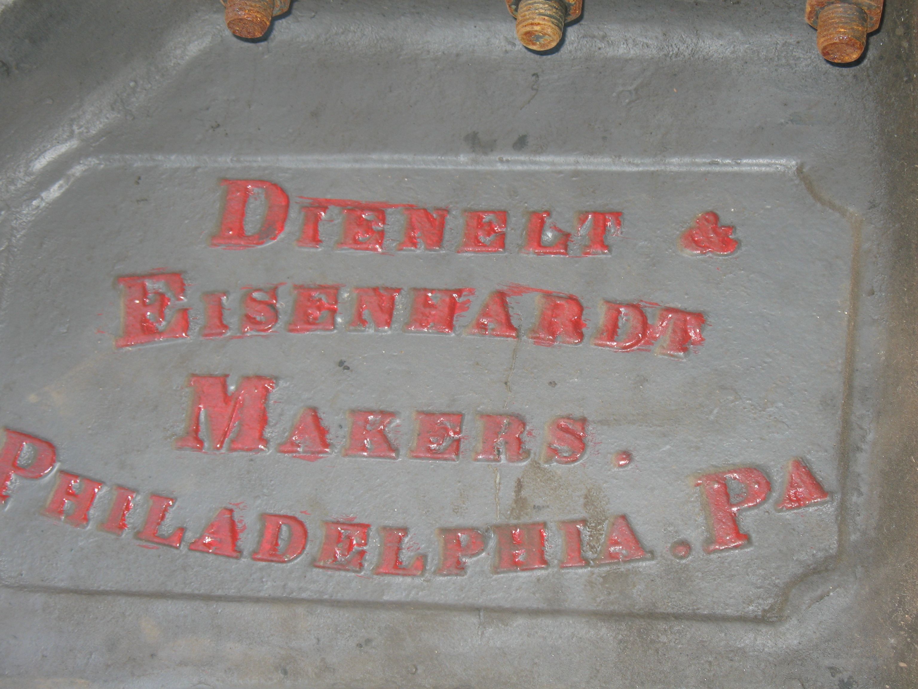

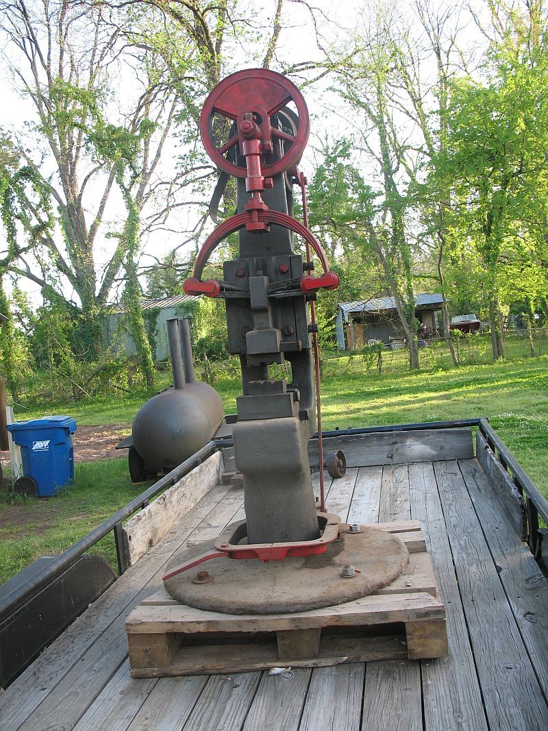

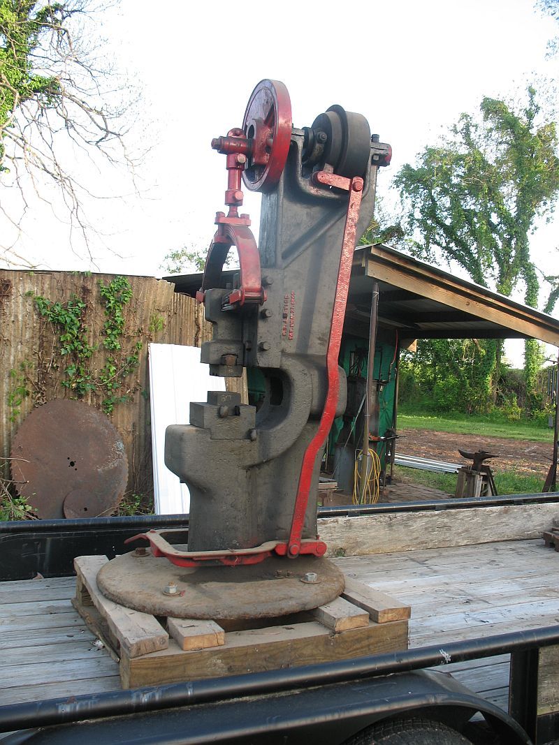

I have this power hammer and can find no info on the internet. This monster weighs in at 3,800 lbs. The problem is I need to hook up a 5 hp motor to it that is 1725 rpm and I dont know the size of pulley for the motor to get whatever rpm this should call for. Also should I build a cage to cover the springs in case of failure (red ones)? Any info or help would be appreciated. Here are some pics.

Nice looking hammer, it looks like this was driven from an overhead shaft and a flat belt. Are you going to convert it to V-Belts?
Thanks Salem and John. John, is there an advantage to converting it to v-belts?
That hammer looks like it could run pretty fast. What is that patent number on it?
Ron, I will get the patent # and post it after work.
For me, the advantage of using v-belts on my LG 50 was simply the easy availability of v-belts and pulleys.
I used a 1725 rpm motor, and still barely was able to find a small enough 2-groove pulley for the motor shaft, to get 350 rpm on the 12" hammer pulley. You might be able to better use a flat belt if going for lower speeds than that.

That hammer is specifically mentioned Modern Mechanism
Page 437 pf the document linked. Nothing on the rotation speed, it just says "very fast" if desired. (Vintage Machinery has it online as well)
325 RPM, I hope that helps. Exert from "Coal Age" page 606 Volume VII, January 1915, Hill Publishing.
Ron-m80, That is great info. I now can do the math and I can make the pulley myself if need be. I have a lathe and access to a broaching mill. Ron, I found the page you mentioned and what a gift that info is. I cant thank you enough. Guys, thanks.
If your making the pulley yourself, stick with the flat belt. When this machine was made, there may have been 50 or 100 of them driven off of the same drive shaft. The operator had a tension roll that would apply tension to the belt and drive the machine. When the tension roll was released, the belt would go slack and idle around the clutch without driving it; now the operator could change the tooling without interrupting the rest of the machines.
