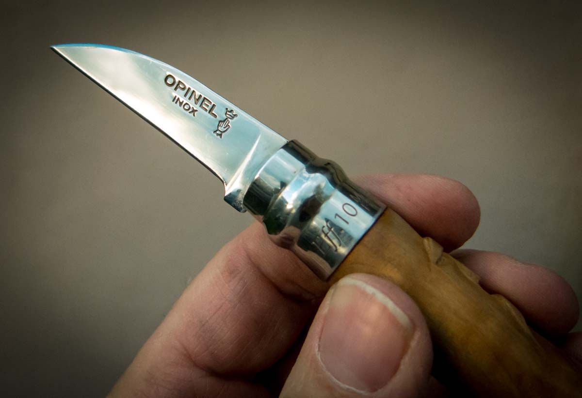

I'm thinking that I'll not attempt this combination, finally got the other Opinel in and she's lovely! Excellent grain on that olive wood there, so I hate to muck it up or even the other one at this point.
BUT I did take the older one and ground down the blade into a wharncliff blade that should work great, I'll just bring along two for the time being :)
Nice swedge grind on this as well, I did mess up trying to grind in a nail nick, I won't bother you folks to view that nasty bit, I did end up getting a nail nick in place that works, just below it, it looks like a gravel pit was once there...oh the humanity :)
Opi_wharncliff.jpg~original
Opi_wharncliff_blade.jpg~original
Nice small blade, with a nice long handle, very good ergo with this setup, for me at least!
