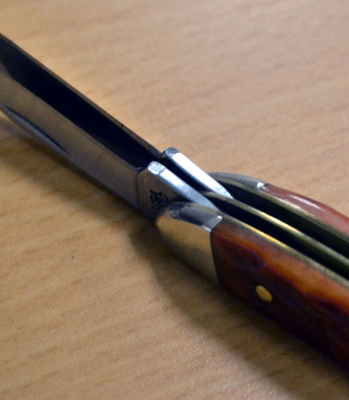

you're saying the kick gets mashed into the spring? look at the kicks carefully. they may not be mashed (blades are generally harder than springs) but rather rough grindings on the kick to regulate the sitting height of the blade in relation to the handle when closed. here's my chestnut bone peanut. it looks mashed but it's actually grinding.

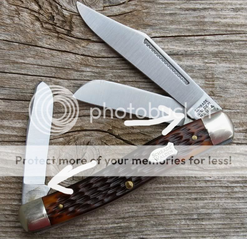

Here, Let me try to be the tour guide here, mainly for the OP and those with confusion on 'kicks'.
In another thread we talked about "kicks". I will use my own photo as I already have arrows drawn on it.
These are 'kicks'. They keep the blade from contacting the spring when closed in the blade well. Notice how nice and rounded they are on this old Schrade. These were quality forgings or adjusted correctly.
In Hanks photo above it appears that the normal rounded corner of the newly forged blade has been ground down flat, or possibly had 'over-adjustment' on assembly. It appears to me, you pros jump in here, that someone at the factory has gotten heavy with the grinder and a kick that low would need to be checked for the blade edge hitting the spring. If Hanks knife is hitting, if it came from factory that way and Hank has not altered it, I would consider the factory should make it right.....You will see some of these fitting marks on kicks, mainly in production knives, as blade fit is adjusted at the factory. I admit to talking about honing a kick to slightly lower a blade. But I used the word honing and slowly and carefully. This is not a job for a beginner and surely don't use a large mill file or a grinder. I also would be very cautious in attempting any of this on a classic like the Schrade above. 300Bucks
