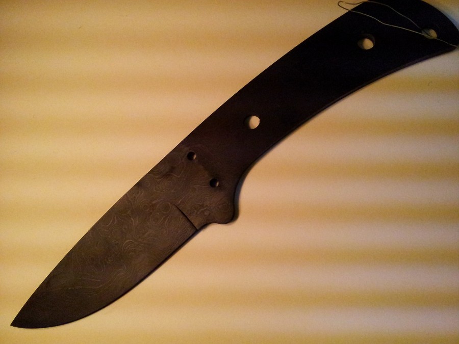

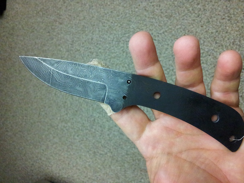

New to knife making or really just adding handles to purchased blanks. Purchased a Damascus blank that came dark colored with a rusty look. Do I need to re-etch the blank to get the color and pattern to show again or does something else need to be done to it? Have only worked with stainless up to this point. Trying to learn as much as I can. Thanks for any help.
If you post a picture it might allow us to get a better sense for what stage of development the blade is in.
You can, you just need to host them on another site and post the links here. If you email me the pics I'll host them for you.
I am not sure how to attach the photos to your email. Clicked on your name to email you, but there is no place to attach photos.
Looks to me like what you want to do now is take some 2000 grit sandpaper and lightly sand the surface to bring out the contrast.
