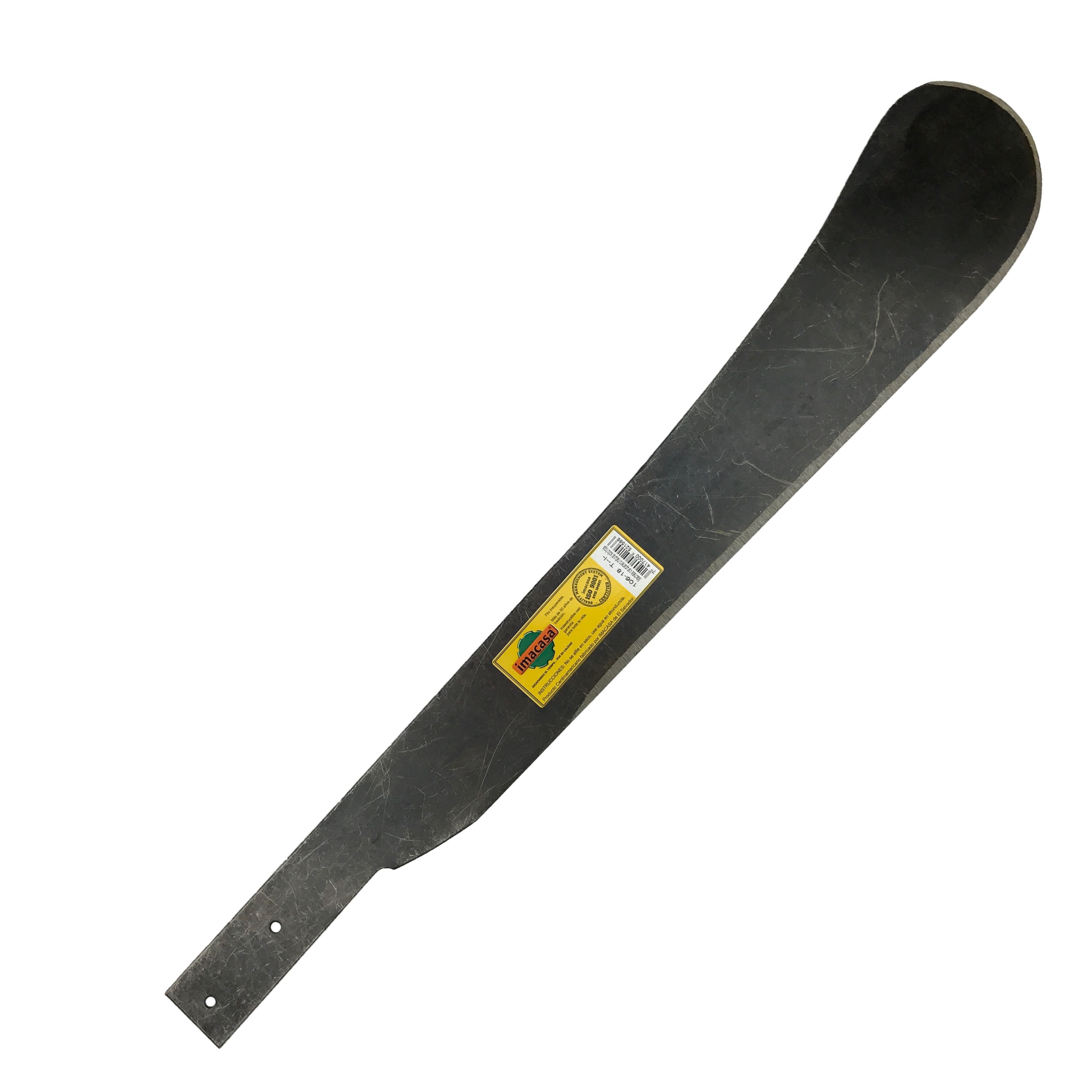

I bought a bare machete blade and I intend to make it a handle from veneer-core plywood.
I read two threads on glue, one old, one new, and I still don't know what to use. I need a handle that is tough, safe, and comfortable. I don't care if it is pretty. I have JB MarineWeld #8272, 3960 PSI version on hand. I also had Gorilla Super Glue (CA) but it hardened in the bottle as always seems to happen. Can I use the MarineWeld or will it fail under impact?
Can I make pins from framing nails of the right diameter or do I need another stock to have success peening them? Do I peen them before or after the adhesive has cured?

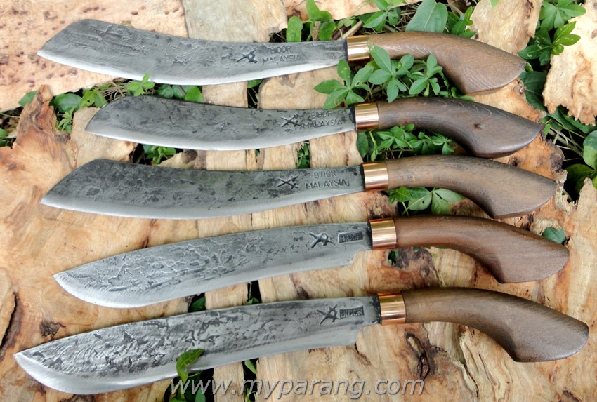

I am planning a shape inspired by the Condor Duku and other parangs. The knob will be unsupported but also an inch thick. I don't see how it could fail in normal use, nevertheless I acknowledge that in ignorance "you don't know what you don't know."
If you look at the curved Birds Head handle end in your first photo you will see the grain is running across it. The grain also goes through the lanyard hole. This will allow a fairly minor bump against the knob to break off the end of the knob on one or both sides. Micarta has no grain, so it will not break off that way.
That one has a full tang with steel all the way to the edge. Since I cannot duplicate that on this blade I chose the plywood to avoid that problem.
