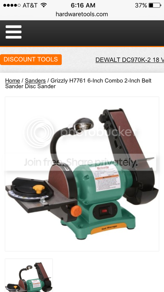

I have probably read every thread on grinders in the search hear so I just boggled my mind with info.
So for $200. I can get the Grizzly or craftsman.
When I read hear on grizzlys the dont state the model number for me to know what to read up on for pros and cons.
Grizzly 2x27

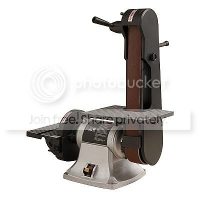

Craftsman 2x42
I am gettin one or the other and would like a final input.

Get the Craftsman,much better belt selection. Tru-grit has alot of different belts for the 2 x 42
If you ever see somebody mention a "Grizzly" belt grinder, they are almost, if not always referring to this 2X72" version: https://www.grizzly.com/products/Knife-Belt-Sander-Buffer/G1015
looks like you got the 72" part backwards when reading. ;)
And yes, between the two you listed above, deffinitely get the craftsman 2x42". When it comes to the craftsman vs the 2x72" Grizzly, that's another discussion.

Get the Craftsman 2"x42" or if you want to increase your budget, the Grizzly 2"x72". The Grizzly 2"x27" would really restrict you as far as belt selection. I started on the Craftsman and made some nice knives with it.
Thanks for info...
I ordered the craftsman
Now you will want to do some research on modifications to make the Craftsman more friendly. Mainly you will want to add a glass platen so you get smooth flat grinds. Do a google search for "2x42 mods" and you will find lots of information.
Also, you might want to checkout supergrit.com They have a pretty good selection of belts for the 2"x42".

Nope it is a 2x27. He provided the model number and photo.
Regardless, the 2x42 is a better buy due to belt size and availability.
I was talking about the Grizzly grinder that most people were probably referring to being the 72" model, considering they are the two most talked about "beginner" grinders out there, and that he said they never gave a link. And it was a bit of a joke, since 27 and 72 are the reverse or earchother.
Not so funny apparently ;)
