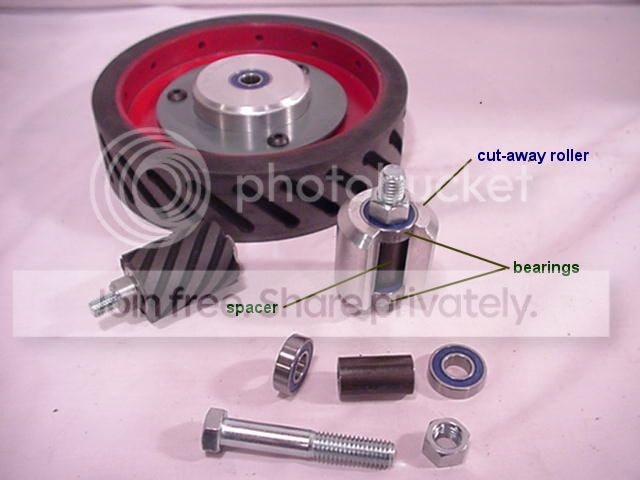

I found a guy in town with a nice sized lathe, and he has agreed to help me make some grinder wheels for my EERF build. However, I don't know how to tell him to mill the bearing pockets so I can press the bearings in, but be able to tighten them down on the axle without inducing a huge amount of side load. Can someone please explain this to me, maybe with pictures?
Also, how wide should the platen idle wheels and the tracking wheels be? I know it's been discussed before, but my google-fu is weak today. Again, pictures are awesome. I'm kind of linguistically challenged.

I'm using R8-2RS sealed bearings from Fastenal. VXB has them as well. They are 1/2" IDx 1 1/8" ODx 5/16" thick. They are nice bearings, and I either got the recommendation from here or knifedogs forum, I can remember.
