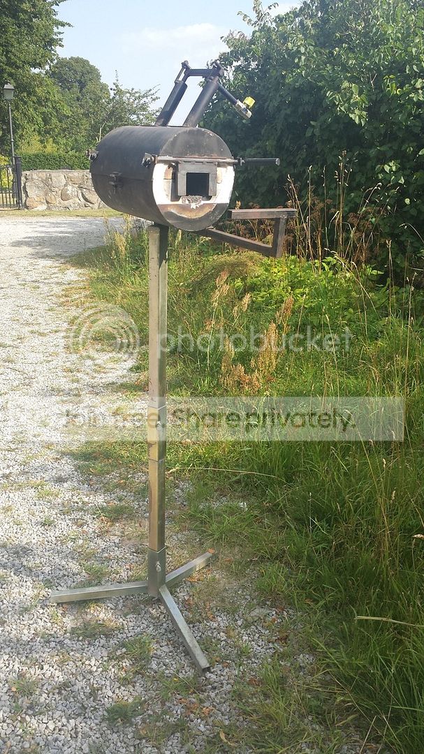

So I am upgrading my backyard forge but have been having trouble finding a good gas forge for knife making. Then this showed up well with in buget so I snatched it fast as a shark.
The only problem is al I know is that it looks the part. Can you guys fill me in. Maker? Model? Pros and cons? Hazards? Etc.

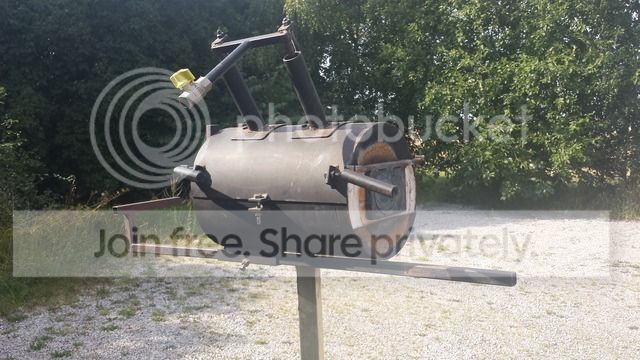

It's pretty heavy duty, not cast or anything but the forge part is about 60-70lbs (35kg). The welds are not industrial looking but has held up well.
It looks pretty robust. It is lined with firebricks, and has a bit of welding flux on then floor, so it probably gets good and hot.
A new coat of refractory inside wouldn't hurt, but otherwise it appears to be ready to go.
Certainly home built.
If the price is good, it looks like a good choice for your work.

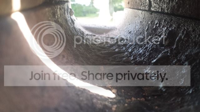

Will the refractory for fireplaces and wood burning stoves that you can buy at the lokal store do or should I spend the extra money and time and get the pro stuff sold by kiln repair company's?
Since it is a firebrick forge, it can run as-is.
I think you can use most any refractory if you want to give the chamber a coating. Fireplace or stove cement will work if satanite, castolite, or another refractory isn't available.
Just put a smooth coating over the bricks. About 6-8mm thick is all you need. Let it dry for several days and then fire on low for about 3 minutes. Shut off and let sit for a couple hours. Repeat the low firing for 5-10 minutes and let cool to room temp again. Relight the forge and start with low again, slowly increasing the heat over 30-40 minutes to high. That should cure the refractory.

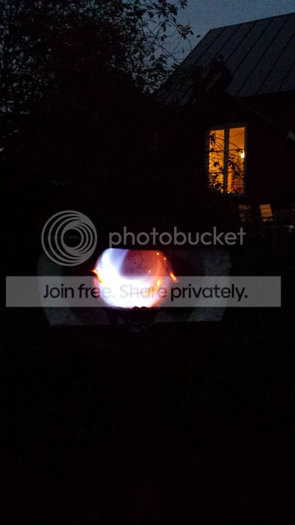

The forge is just burning on one burner with a soft blue flame. Very silently. Sometimes it stops and sometime the flame goes up the burner and makes a fast pulsing sound. I've hade it running for 20 minute's. The hole thing just is not putting out any heat. My smal forge is screaming at a third of the amount of gas an hour.
What's the next step here? Disassemble and clean the nozzles? Feed it more preasure, it's currently on 3 bar 1.5kg/h (gasol).
Or maybe just adjust the burners?

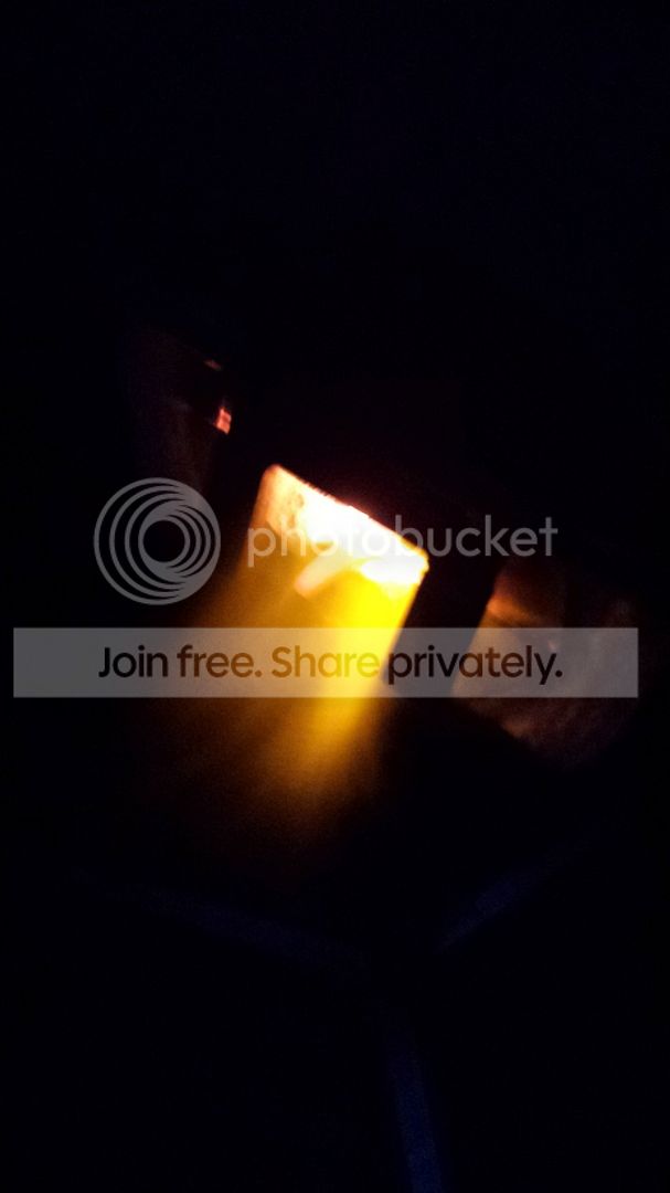

I think I have identified the problem. The nozzles lets air through fine. But the regulator has to little preasure on the secondary side. I mean after the regulator. When i looked closer and in better light it said 30 mBar not 3.0 Bar. I will switch it to a 2.0 bar regulator tomorrow and se what a 650% increase in preasure will do. :D

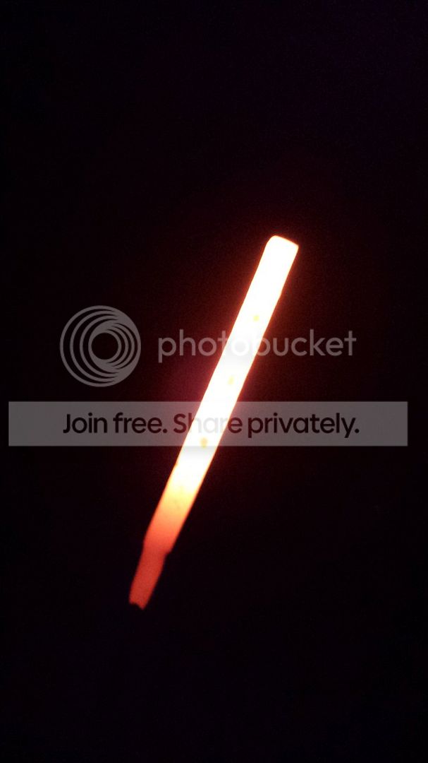

Ok, at 2 bar this thing is a scary beast. Forging heat 3 minutes from cold start of the forge on a 10mm bar. Gets up to bright lemon yellow with 45 seconds at full open after that.
Full blast. 12 inch tongs is just out of the question. I say it's about 6 inches of solid dragons breath.
