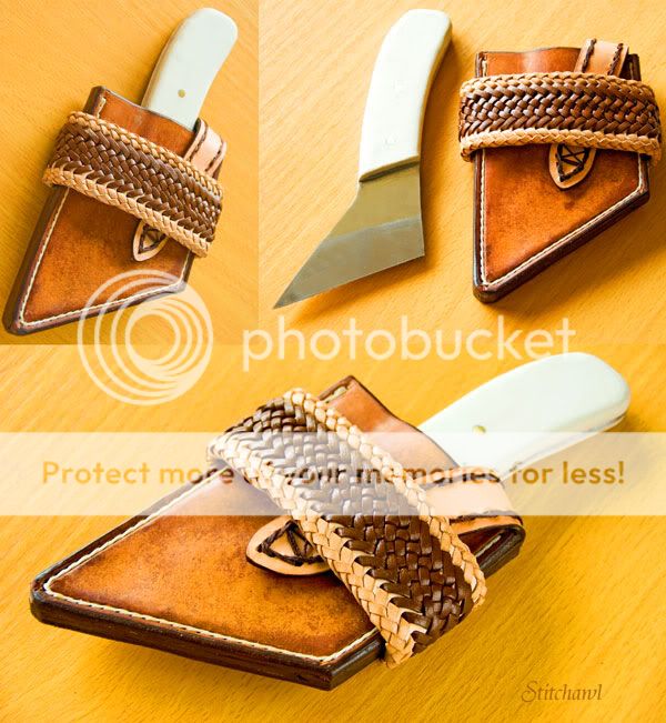

This is one of the better (luckier?) ones; a left-handed skiving knife that I made from 1095 steel, originally sharpened using the Edgepro, and now maintain with just strops.

Judging by your little case, your stitches look excellent to me. That's a very nice case and I really like the braided strap around it. I sometimes do a Mexican Braid on my edges, but nothing like that strap. It really sets the case off. Also, that's a cool little skiving knife!
Just shows how versatile the EdgePro is. I've even used it to sharpen my headknives. Like you, I just hit the edge on a strop loaded with white rouge before each use and it never gets dull.
